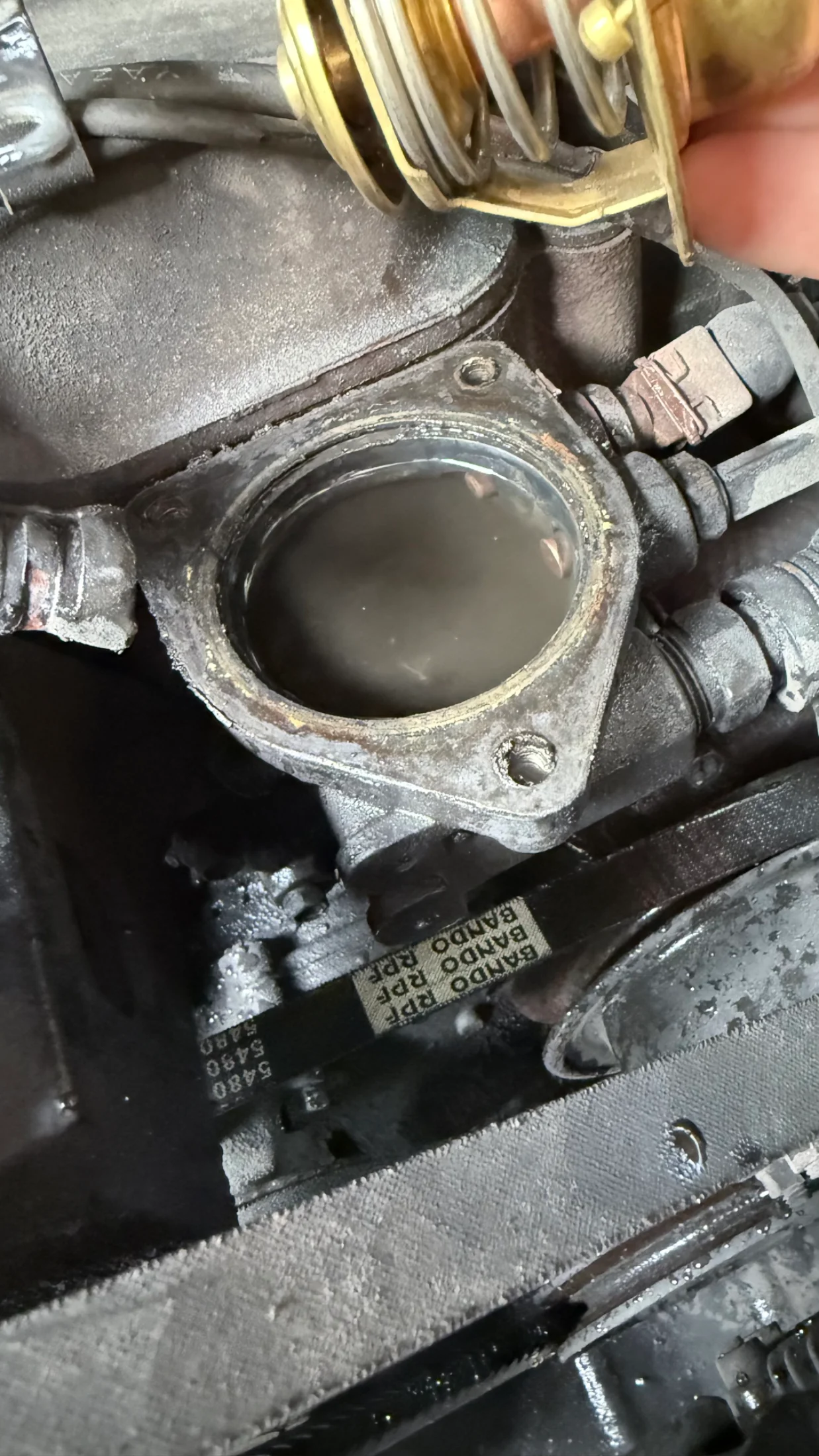

But since my water pump on my 13BT crapped out I’ve pulled everything off for that.
There on the thermostat is a rubber split gasket. So whats the deal? Needed or not? My experience is,
if it came off, it goes back on. So I can re use this one, but I’d prefer to replace it with new.

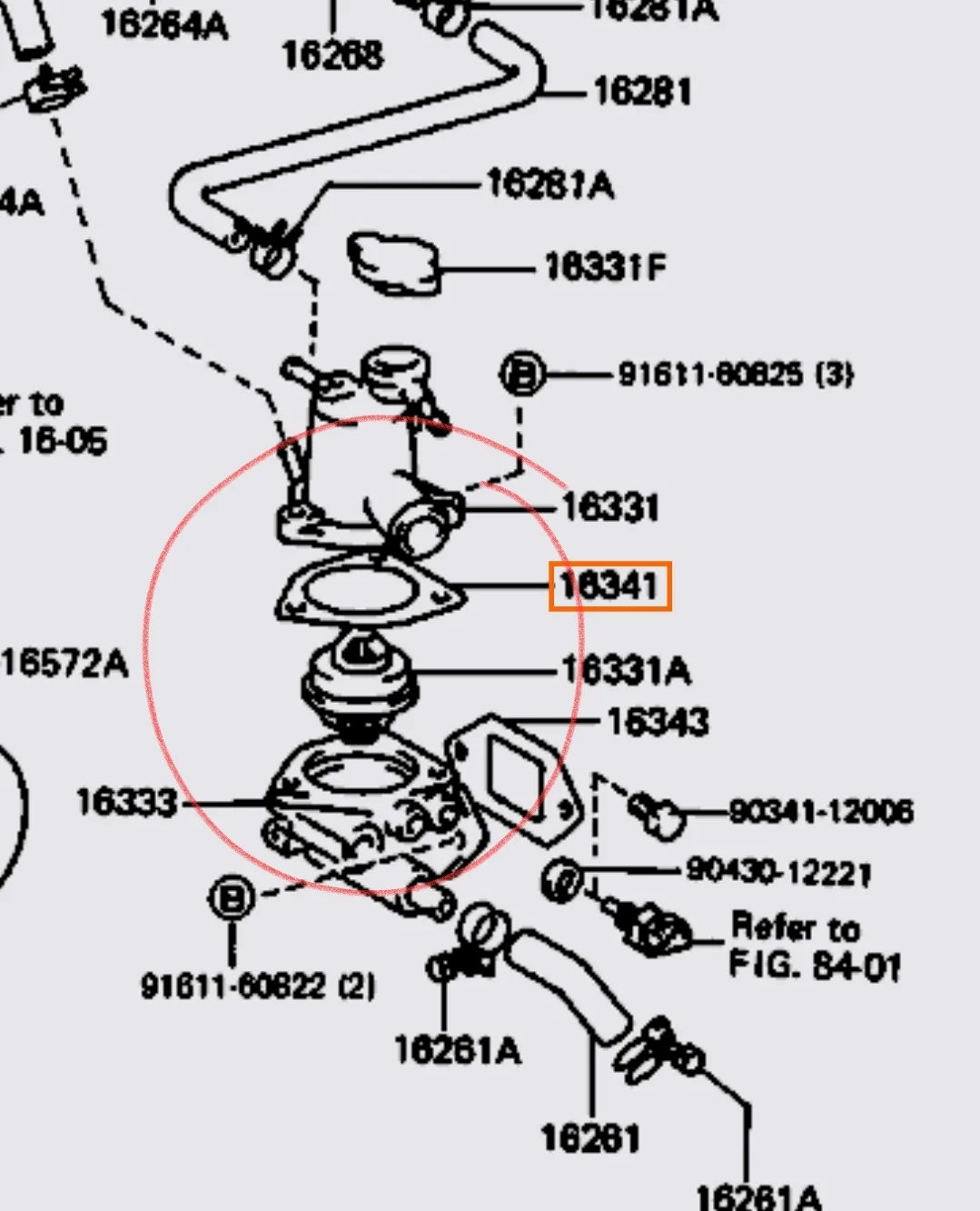

@cruiseroutfit is the 16343 housing to head gasket the same for 3B and 13BT then?
Is 16343-56023 /20/22 same gasket?
@cruiserpilot
ToyoDYI show a changed part number:
16341-56020 for 11/1984-07/1988 (google shows paper gasket)
16341-56030 for 08/1988-12/1989 (google shows o-ring gasket even though EPC diagram shows the paper style)
The lower thermostat housing has 4 part number changeups in the 1984-1989 period and the upper looks to be the same through the run. If that means you can use either gasket style I dunno. O-ring style in mine when I've changed it in the past, so new 16341-56030 o-ring style is what I've put back in. Mines a blue block and 1989.
Yes on the gasket that is between the thermostat housing and head being the same as mentioned above.

Well, you've been doing this a while. Holy old thread, Batman!! So post 88 seems to be a change over year. I'm going to
be putting this all back together today. Certainly checking the lip inside the housing to see if mine is different from one to the
other. I have a friend, heavy duty mech ( on holiday now ) but he was almost there finding me a correct size. The o-ring is 3" or 76 mm OD
Its not generally a traditional o-ring, it's a rubber gasket with a grooved interior where it clips on the thermostat. But it's not used on the early housing with that thermostat, paper gasket only. BJ74's thru 8/88 (so thru MY 88) use the gasket. It's possible you have a late model (8/88-11/89 which would be MY 1989+) thermostat housing combo. We stock the rubber ring too.

It's not yet on CruiserTeq.com but notated on the gasket offering:
The "o-rings" have never been included with thermostats in my recollection, always a separate part#. In the case of the MY89 (shouldn't be on your 88 BJ74) and later 3B/13BT/15BT, it's part# RADOR56030

Assuming you have a 1988 BJ74 (based on your signature line) which I've been basing all my feedback on, the correct thermostat is RAD03103 which you have, and that is confirmed used with a gasket RADH56021 for MY88 3B/13BT's. Same thermostat is used with the RADOR56030 on the later model engines with the different housings combo for many applications.
