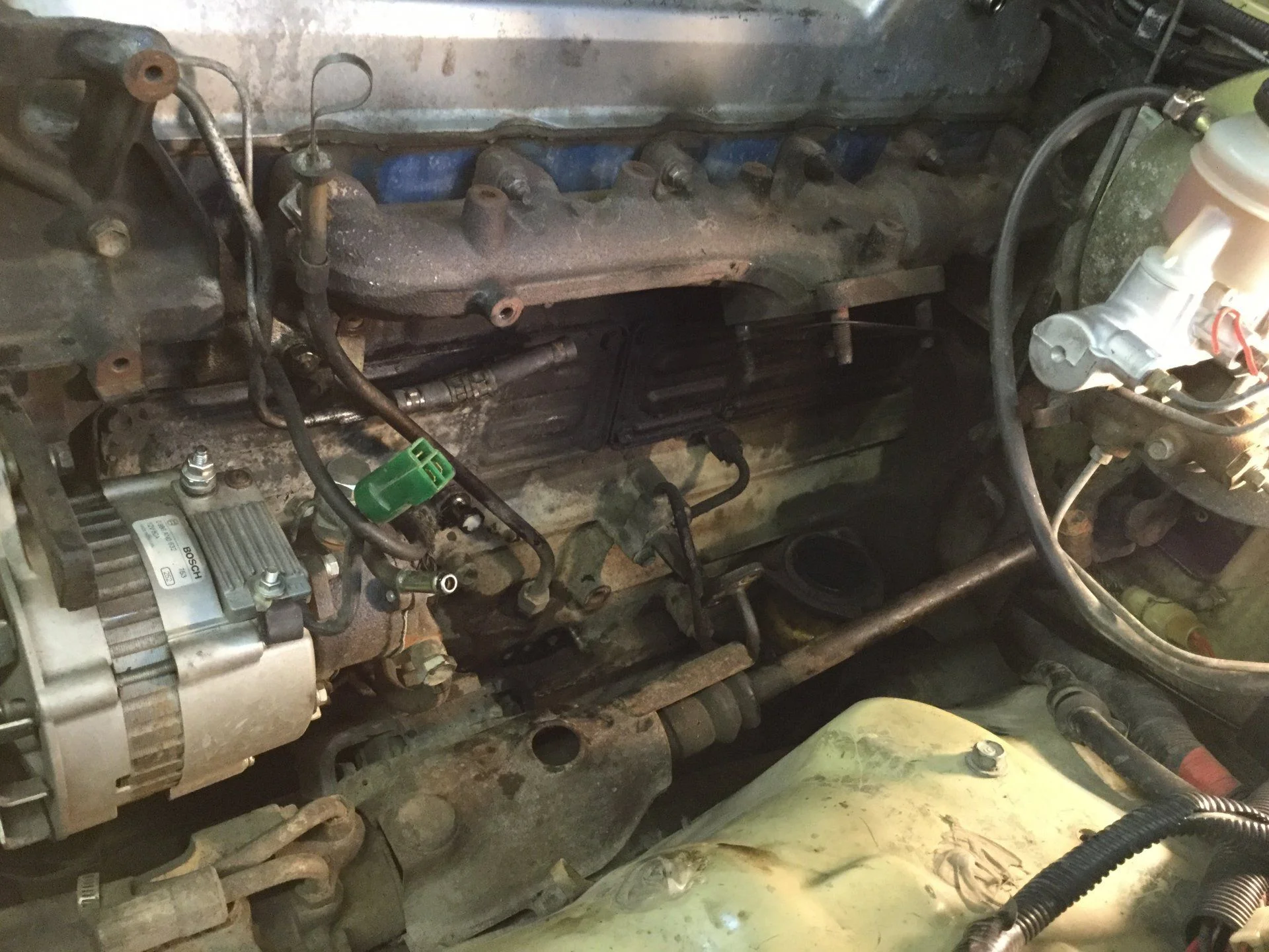

Anyways, the greggs guy was interested and spent some time looking for a solution, at other shop it was just excuses. So, ****em.
Bit of a wrestle to install.
This ends up pretty close. I think a shorter alternator belt will be all that's really needed to give it more clearance. Tho I could see changing to a BJ style ps pump with the attached reservoir if something in this system s***s the bed. It'd be a lot more convenient for plumbing with everything on the same side of the lump.
WXNol_81pGYuXzbIWjMlCE8AIb8G2dACUsEeEhOllGE7MxcNop3UxVijyWOXtduoMVqlAN2EnT6x3-bI4NnZ7AZKkRj6D-Pzh-Fq2B8wTkT3aIHutaN2WQA2JcAa8xd0dPL4eiGUdrqffDcIjohdCmDWxzyPPmIVLxgnr1f8_8-MBbw7XlLlCqYXWGPrHQ_nlRavZo67PGYiC2Li4l_7_0gusrMlx9jvC8nANJFsyvEa9XS1YiL8MioHVMpo2aSXV-iDAXrhxyXkzSi2ZaZJnzWQuhHp88QEOO4trDQGQ2Vi82sZ7N4FpC1ZaHKaA69Enf6aDpiz6kQWfUu42fJXU9ZWHGz_BbFYKP43pKhuuLSmGTb7z9kIkTPZN-XkEAog3KtqL0CuRnjS2jUbWApV2BX0aHUTwSWHRI9PxkpqYh0xadfw8qZ7r4UcYN2AWpeUgmfokeUS8qAVLry2QVad0wcosxHMtb9CHSdi5U83s8eTCYVmh1DU1rfrww6E45MW-81uXmI2F6LisDj-3FzKH7uBZtSabMfV_zBxrUoNU6hQtso7kar21mMhRuIlsULRfQxncE9VVYsFkMaftG1S_W_H5JGPdG3qr1zu8MS8EEy6U7guONC4TbaAXabMIfkXyG9L9lU7jcvucQJK2EB5tfYq96D9L53RMGUks87UKTD9nIc0xEbAg6WpZZgvaQ=w834-h625-no
Ran the lines in some old firehose and strapped them down away for all the spinny bits.
