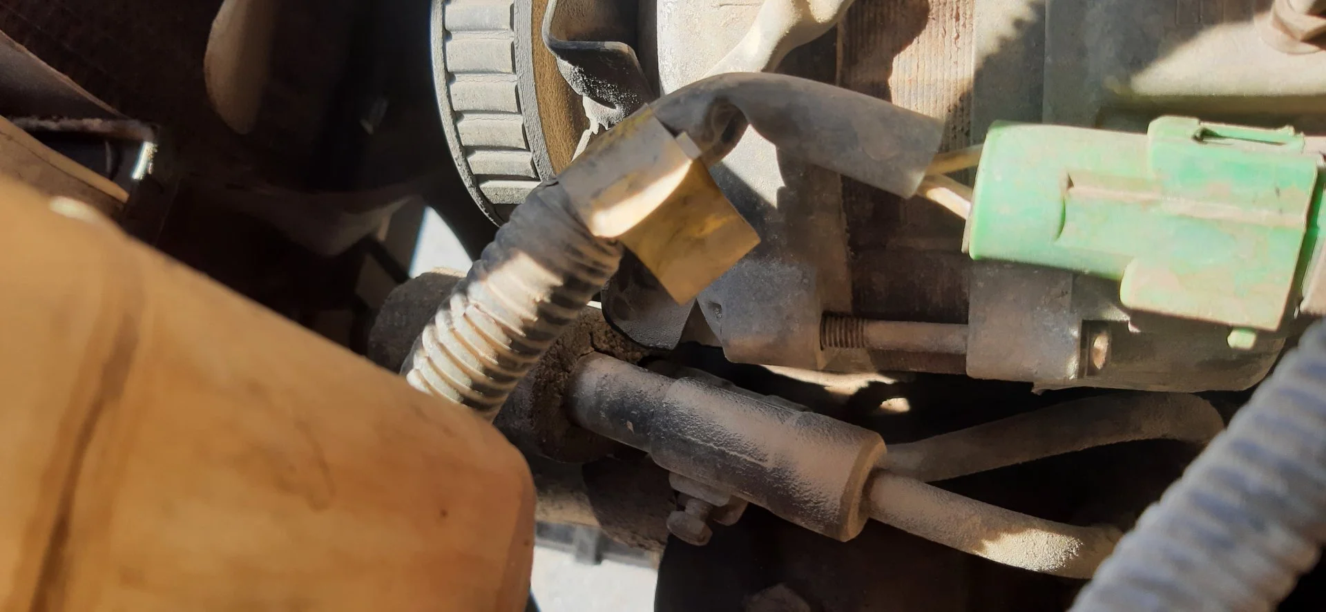

Interestingly, I put the thicker frame mount bracket on the driver's side, and I have a lot more clearance between the alternator and the steering box than I did before.
Thicker one was clearly on the old driver's side before, so chalk that up to another thing that should be moved across on a LHD swap I guess.
Or, it was just in wrong before...:lol:
Hmmm... Interesting. I have the thicker on the right/passenger side on my 2H. I think it's that way to clock the transmission whatever number of degrees it is (the transmission mount is angled for this as well). Not only is the engine not straight, it's not level either.
Could be it's supposed to go the other way.
I'll try this and see how it works, with the thin one on the driver's side my alternator was 1/4" away from the power steering line, so if it doesn't cause any weirdness under the truck, it's better.
Course it it's also going to mean the exhaust needs a little massaging...:meh:
Yep, it's tight between alternator an PS lines... about 1/4".
Check your rad hood as well to see if it fits right with the engine mount shims that way...
Yeah that's next. I'm going to split the shroud so I'll be having a good look at it.
I suspect it'll be ok, because it's really just rotating the engine, not raising it. The fan is pretty much in the middle so it won't change much.
Famous last words I know...lol
My engine is actually sitting level for the first time ever...still crooked as hell, but not leaning over.
So if the shroud clears I'm really not seeing any downside yet.

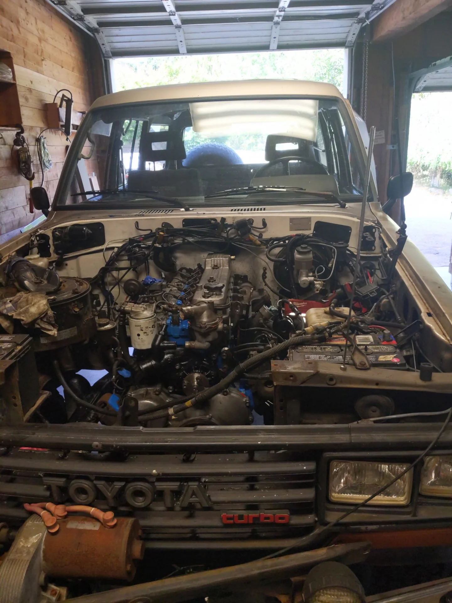

Other than that, attached all the pipes and crap in the engine bay, and finally split the fan shroud.
No clearance issues with fan and shroud with the frame mount blocks on opposite sides.
4BQYPtRwNmSYT_T-MHxD0c1dDiLZZOzLTX_8oosIo2abYDiJCjCUS7sSHz7FKLotNkelm5zdacb7F9jICtnwXIOxMb2RW3BMkvoiAMPn7jtNqUPPldmEb1rNz8lW9WdvJPEk78-gPTIP8TOqoSvqznyFFf3z6_0yvWVBYR9krF632jwYxmaaIdPiYCUT-NrMVnGIjoZGam4ayxMr6Bzp82_2N8ybSjdfHmjjibQmH4QJLLPE_jDIdqyW7zpZAxuN3RYqBBPX72Ab8z_3kGOcVgrxJN-dnN44GxW__TQgiByexw-vRR0KBvfjCSr7aRdAiSBVYcbbj1QCBisi9gvC0KdM7EJ1VPpGGXHv8ARKTFz52dxOTP0NfvBjK6XZ9K3IUY2E22rsRKpfh1S-7iNfgNNUN9Wnlp1f2GuKHNpJ298IMYIzNKgd-_K9ph_EOP8gtzbb33anOx4vL4rAh7kKKbH-HviGWG9o4Aa6SJtvHJl95r-GfZ1rt6Cvvoj7lD9uP7f54HsqInK9VI6dNc3gZPYW1xNhTnHdyDpGDuCAMG0Jum0YvyPBZQ7W8ICK6OQeLCrbIwXoa4kg6lOmeLU69byASGcYgBmSngzCmuq6K5ZG9HV2MuT0F7o6Pt1Kh3VVfhqq4L8YDQlgPNYy1B2hobqjSXhQt2_jpNwl0JGb3ga8trzPAy7DYkElI3uvG0tFmzt50sDmiZ--Pu9fSJ4IN7Ut=w469-h625-no
Doesn't have to eat it's own farts now.
0J5E7CAJ8ubTW_ITvjg7zT1f54amva857MKCt9-SoKRtPwOwDaCYm3m8mwzeuIHLH0SEyQ1pXkIRXtusOMAYDzGd_U3bxm1TUtkwFfPuDROsTgh8toeoZCAe-VtTZxbT8xZo34wUPFcbw1KVNkpH1xT42JMQ4Xuwbeu6gMvw4ww--j5UOcbjnD7hN8reDSiU72XI5Gei8ftpL7d4HFwRp21hYZlAjMRFrF-BBwTZYYb6pnHTjp7LA8eNQQFrcUhJ72-JVqnlY57BcBEsFs_AyjSuN70LZha7HwkigFjCD7nBZtC50H7FiO8h74ueheF2dgSW-EOhbVFpGt9YpFkm7vXVh4EAvjxGR49GcY_sgDstMzqTQnI1LqEhcAJy_4DPT-nTWTecieCS8-ssynx8gIuxLaJTjPFGWs4KAoyyAk6iFsUFtleaa5FHZufAtuuVZ7DrvhpMQ40_O6zbZoIT5Pn9uW3SAexUchJJg8S1FhgSoA34kK6MaDsskx8vkDB_taH0taEVvuLXnmlkXSfWln4ql8DrgsGJZcI_6TTgCvvyPa8jiXzS2txu0irEB6Dat0zk6-404L95wHyzCvuvFtw4dCF4gEqJd7_z468eis1ap7a0ZTFGxYvzfwuv17ajJ1xREpJ63MCTeQcFDOgq2QbCYeMgfyWDJW1aBobIzVF6exnjZTsjyZOFQUr7SWREFW8aLf9UetPnjsIr4MYgY4hz=w469-h625-no
Have the blow by routed down along the frame under the drivers seat with what I'm pretty sure is a washing machine drain hose...:lol:
Decent amount of wind coming out of said blow by pipe, hopefully that tapers off as the rings seat. I was pretty damn careful about where the ring gaps went
More breeze than the 3b has, but there are half again as many pistons so.... :meh:
Took it for a hot lap down the back road, seemed peppier, but that could be because I've been sitting behind a 3b for the last couple months :lol:
Now to see if the assistants all vanish again that I need a hand putting the hood back on.... 😒
