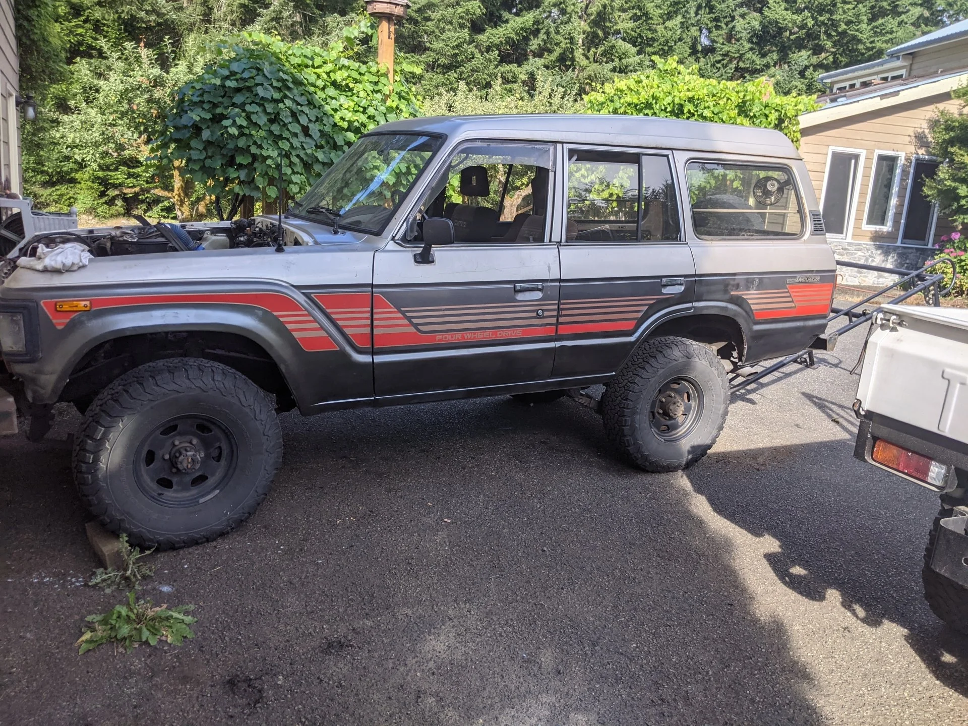

I feel like no thread is complete without some low quality bodywork. :lol:
Nothing but the finest rattle cans will be used. :flipoff2:
The ol' tits down... See if I can't get another couple years out of the stripes.

I have been absent for several pages ….. good work. I’m glad you saved the stripes. Your turbo should be just fine at 8 psi if you leave the stripes on.
Too many people overlook stripes when sizing turbos.
Also, blast some snot of some sort on the inside of those fender flare plug welds. 👍
Oh yes, snot blasting will happen. I tend to hose the thing down till it's an oily waxy mess inside every panel.
I agree, the stripes equal at least 5psi of boost on their own.

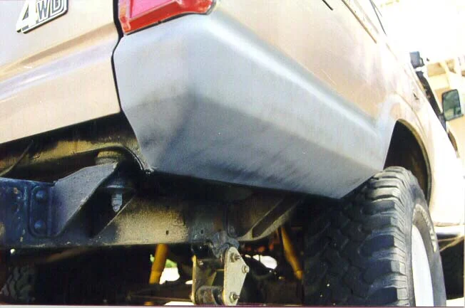

Did the other rear quarter. Kinda halfassed, think I'm going to do the quarter chop maybe next year. Found a version of it I like, I can fold up the tin on the brake to have it look decent. Putting the pic here so I can find it again.
rkredge-jpg.176417
My mother would say, " a blind man would be pleased to see it." :lol:
Spray bomb was a lot darker this side. Oh well. Probably gonna have to lose the decals next year.
