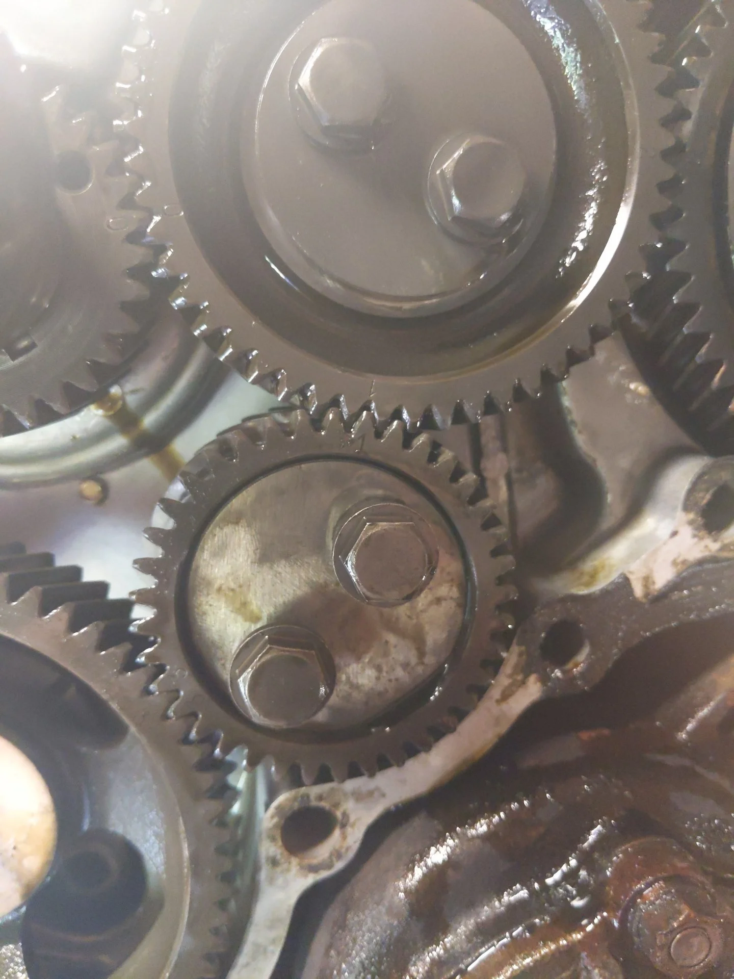

Read the fsm some more last night, and it says just remove two bolts and be careful to remove the cam.
So, I figured I could handle that. Thought to be safe I should get all the timing marks lined up...

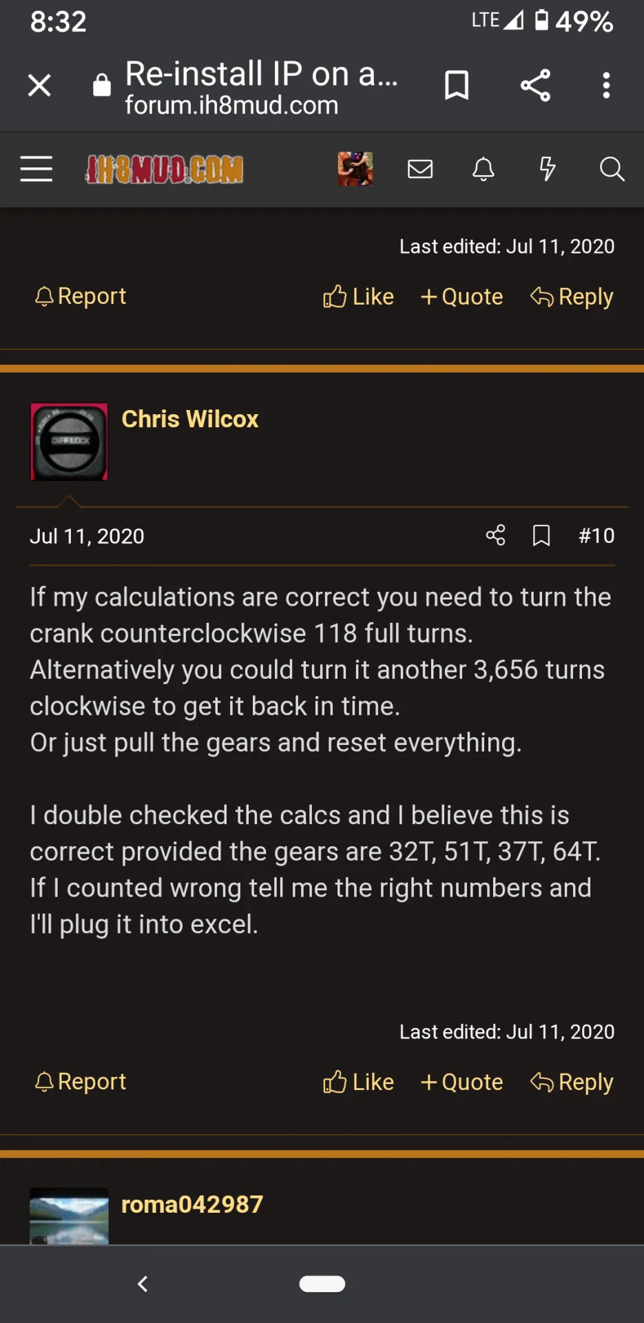

There's some math going on here my sleep deprived brain isn't quite grasping :lol:
Spun it a kajillion (roughly) times, got the zeros to line up a couple times, even the twos this time, but not the rest.
Then I read this and felt like I should go take a nap.
I wasn't expecting 3600+ turns...😳:lol:

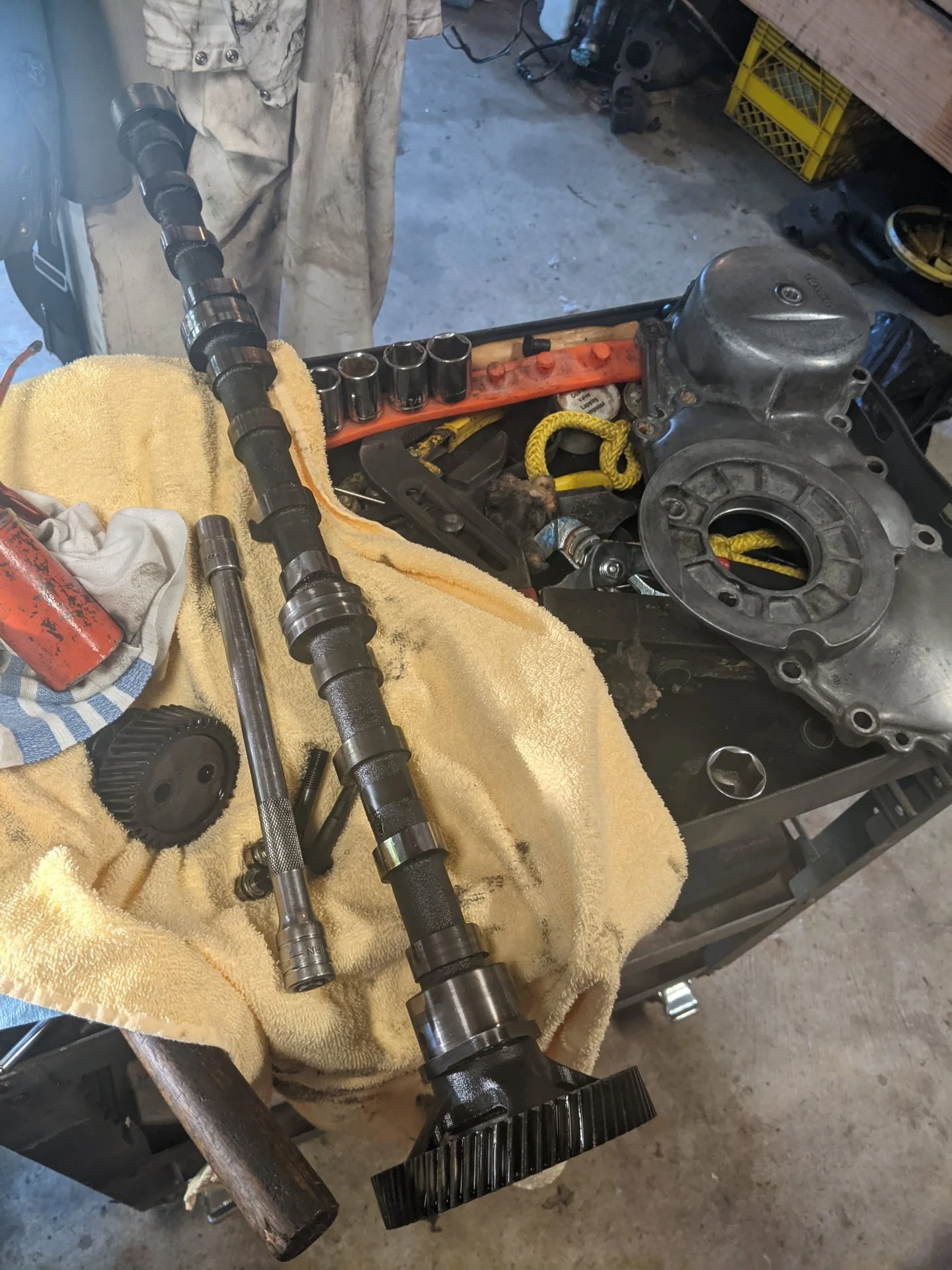

Bearings look good. No flakiness, so back in it goes.
Definitely a delicate operation. Once it's moved an inch it wants to drop the rough castings onto the bearings... which is pretty much exactly what you don't want.
I considered measuring the cam lobes, but the thing is, what would I do with that information?
Even if it was below spec, it's not like I was going to get a new cam. So, ****it.. :meh:
Rather than spin the crank hundreds of times hoping it eventually lines up, pulled the idler that was out and reset everything. Little idler comes off easy, no pullers or anything needed.
And now they line up.
Even if it was below spec, it's not like I was going to get a new cam. So, f***it.. :meh:

Did you measure the cam lobes?, it is very much the same as the 3B cam, except you have more bearings and much bigger.

But nah, I didn't . Could still measure it in situ if my dial gauge will reach that far in, but really, it's not particularly useful information if I'm not going to do anything about it. Doubt I could buy a new one even if I wanted to spend more on it than I did the whole truck.
Sometimes I put werds in between the pictures. :flipoff2: :lol:
Ya, My 3b build budget is out the window. Need a cam or get it ground, injectors rebuilt and rocker arms resurface. Easily up to 2 grand with all the machine work and parts. My oil pump was within tolerance, few small scratches on it, new oil pump gear on the crank shaft due to excessive wear. Your cam looks much larger lobes and bearing surfaces compared to the 3B.
Yeah this was really just about me getting the cam out so I could give the bearings the ol' proctologist finger swoop.
Really didn't want to get into messing with replacing those bearings so, it's a bit of a relief they were ok.
Still trying to keep this in the "refresh" zone rather than rebuild. May regret that one day, but I guess we'll see.
