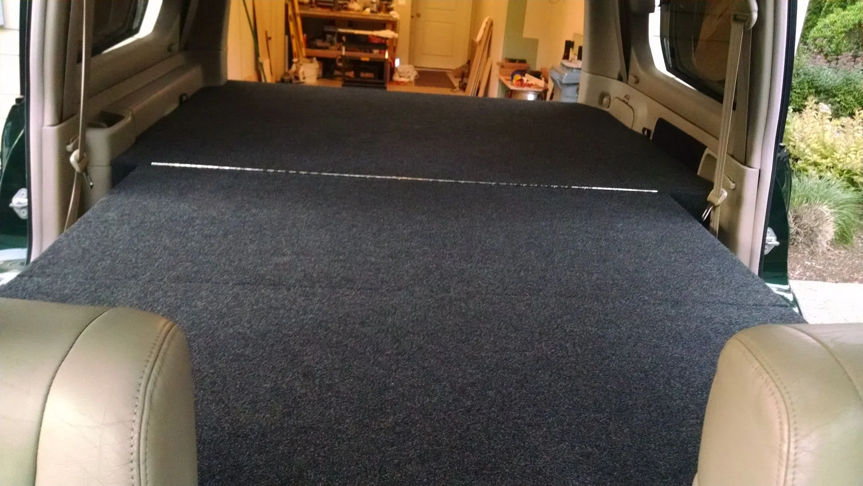

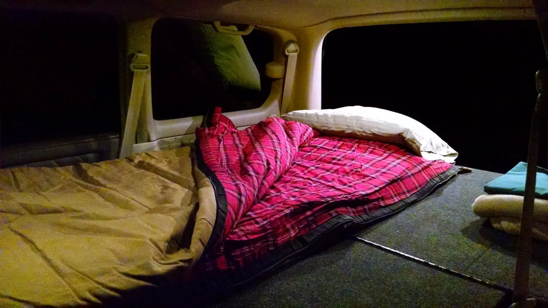

I don't have much for a formal plan. But here's the basic setup. The side sections were just estimates at the time. You'll have to make a pattern to fit the box into the space properly. I wanted a nice tight fit (I know- who doesn't?) to prevent movement and maximize the usable space. The basic dimensions here will take up about as much as you can side to side, but is about an inch short of the tail gate sill. You'll figure it out. Good luck!
Also- you have to watch the overall width of the folding panels. At the length I have below, they just barely scrape the "C" pillar trim panels on both sides as they unfold/ fold.
This is my design and is somewhat more complex and heavier than some of the simpler solutions above. It works pretty well for my use- it holds alot of gear securely in the two drawers, unfolds for 7+ feet (and about the full width of the interior), then folds back up into the cargo area (which means it can stay in the rig indefinitely) and still allows full use of the 2nd row seats. When I get the rooftop tent next summer, I'll take off the extensions and just use it for gear.

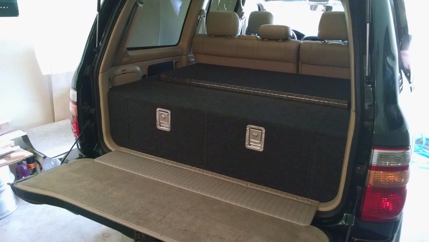

Platform Dimensions
Rear (semi permanent): 38" long, 51" wide
Front (only for sleeping): 34" long, 51" wide
At those dimensions, adding and removing platforms is simple and requires no strange movement. Pulls straight out.
The sleeping platform is exactly the size of a full mattress. I love it.
Total cost: $230

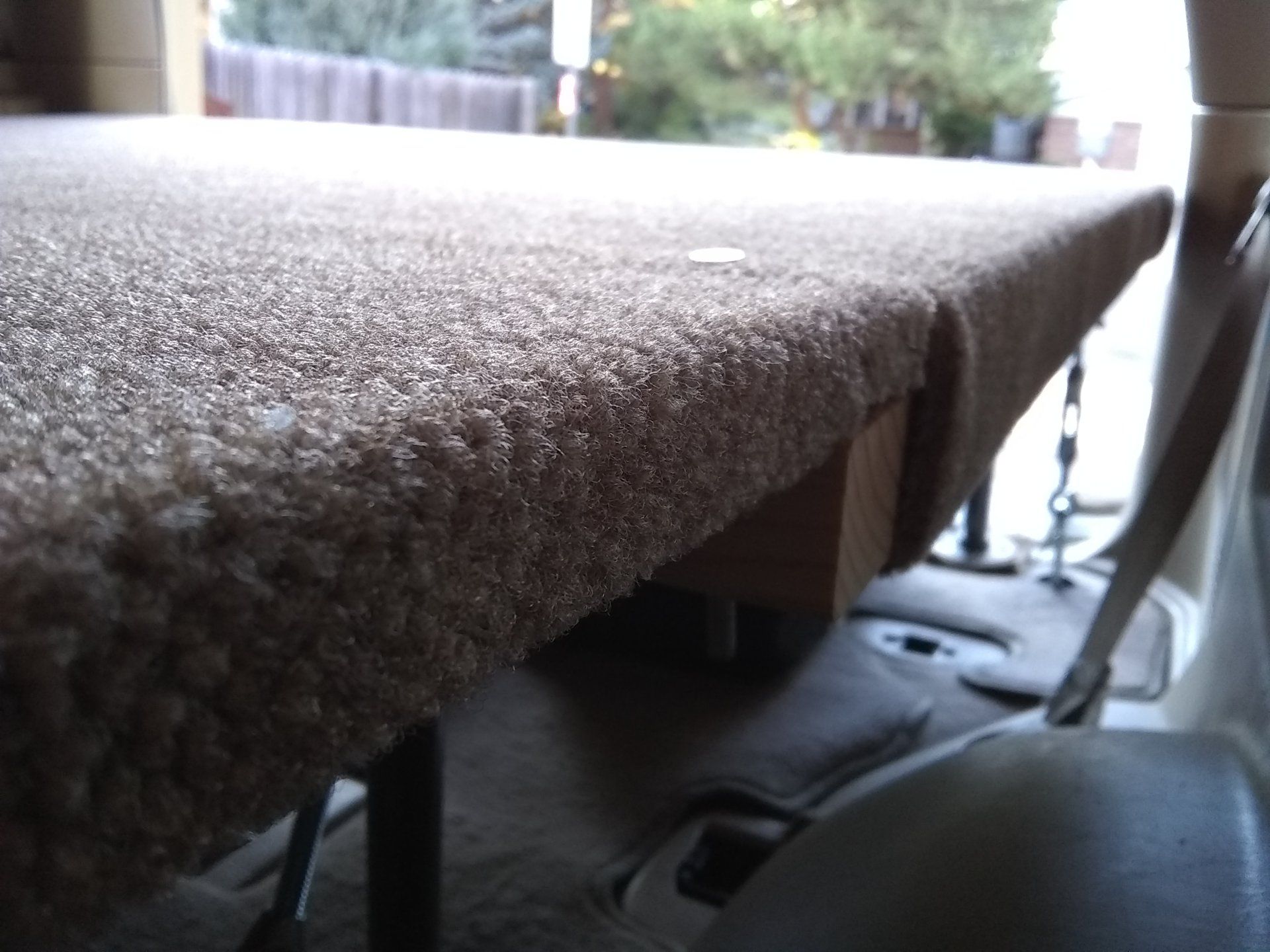

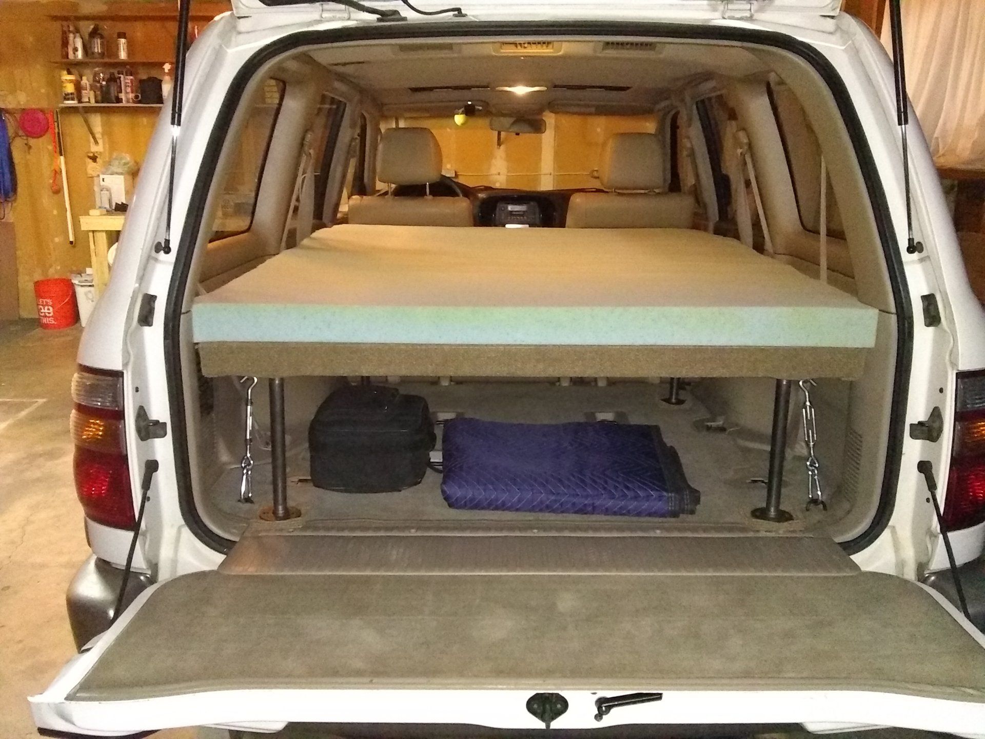

Found this thread a week or so ago as I was planning my own road trip from SoCal to Colorado. Given the cold temps and plans to go solo, I thought it would be perfect to build some sort of platform that would allow me to travel and sleep inside of the Cruiser. With about $90 in wood from Lowes (not including the $15 12-pack from the market) my buddy and I built this platform to meet all my needs. Given more time — and ambition — I would probably mimic @VinylSeats build as the modular aspect really appeals to me.
At any rate, here's how my build turned out. Perfect sleeping platform for myself and my dog, while also leaving room for storage underneath, a 54qt cooler (or single seat) in the cavity and the ability to bear as much cargo weight as I would ever put on top:
Just wondering because I’ll be doing this soon what is the height of the legs? How far up is the platform? I’ve been working this on my head between a combination of others posts and I like the height on yours.

I'll have to get a measuring tape out and check when I get back, but when I built it I just put the plywood board on the rear seats to get a height estimate, which I believe was in the range of 12" total? I'll check and get a more accurate measurement this weekend.

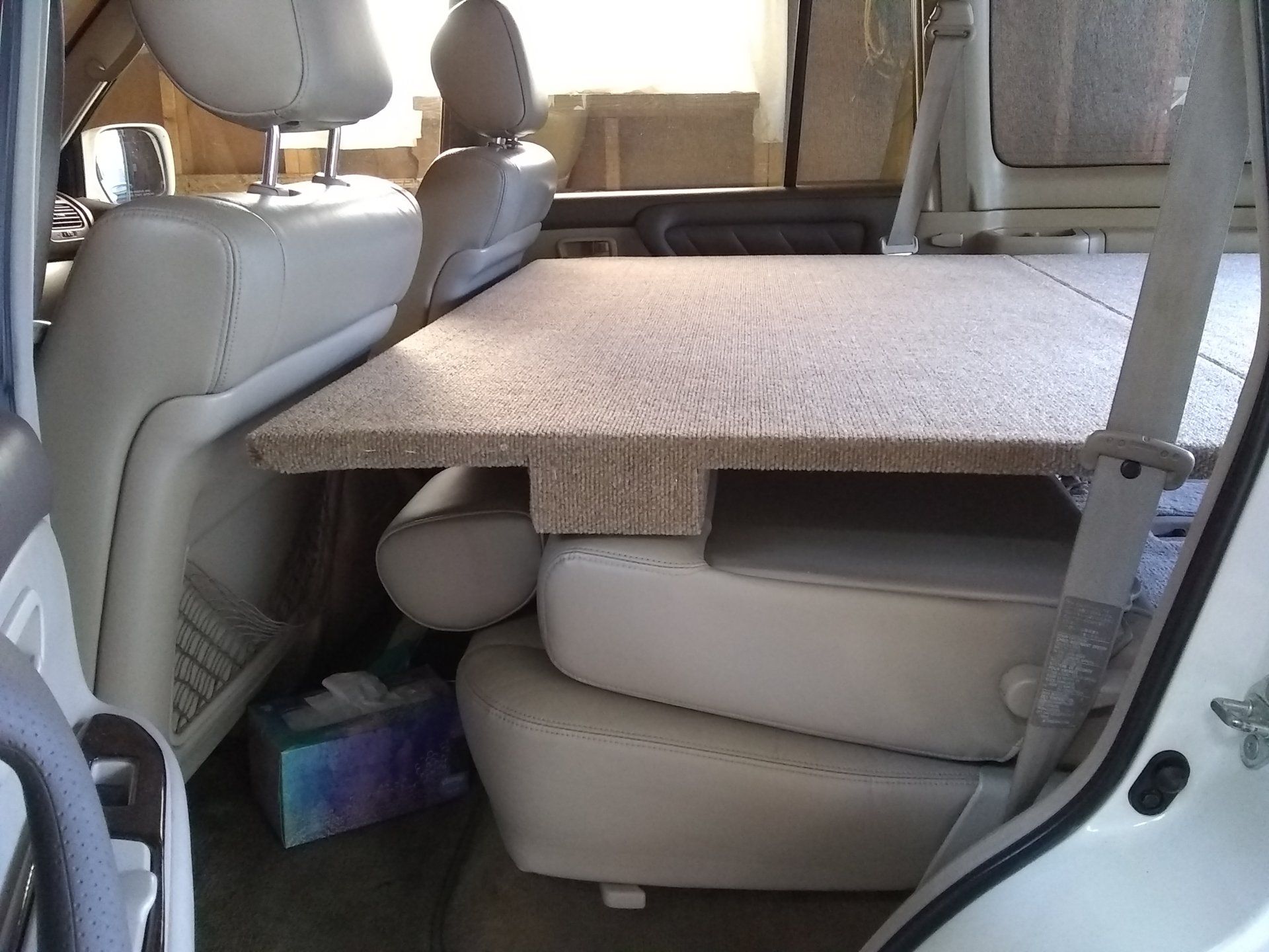

If you want to use the second road seats as part of the bed I think around 10 1/2" - 11" high is what you want. I am building a new set as we speak.

Thanks! Actually I’ve already extracted the second row seats and just need to build a full length sleeper. I want it high enough to where I can fit storage but not too high where I can still lean forward while I’m in there. I’m going to go out tomorrow and see where 12” gets me.

Got ya. I would do as low as you can for room to sit up. If it was me I would go 6-8" for room to sit up or stretch. 10 1/2-11" doesn't leave much room for stretching or sitting up.

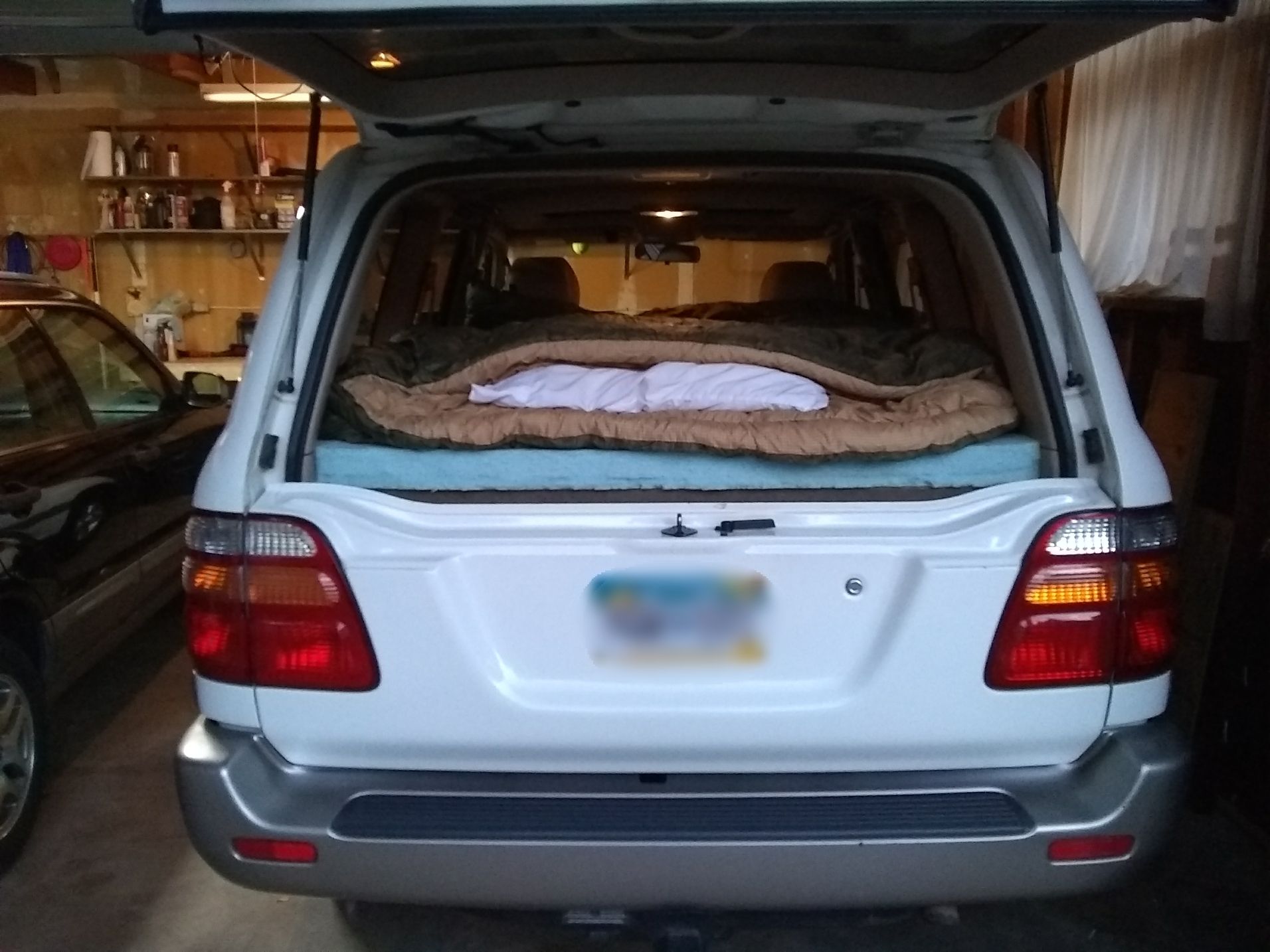

Almost finished with my set up, getting ready for Cruise Moab. Shelves in back a tad higher than the tail-gate, cut to fit the Rigid Tool Boxes. I pulled the 40% rear passenger seat and put my fridge shelf there. I cut up a Queen foam mattress from amazon for ease of removal and increased secured cargo area. Added some aluminum anchor tracks for securing anything that won't fit in the shelving, want to limit this to soft bags, clothing bedding etc. Any camping heavy stuff to be secured in the shelves within boxes.
I can pull this entire set up out in about 15 min. 4 turnbuckles holding the main box in place, 2 seat bolts for the fridge shelf and four bolts holding the sleeping extension to the main box. We'll see how it holds up in moab. lan on using that as a test run, then pulling it apart and making any adjustments needed, then bracing and gluing it all up.
