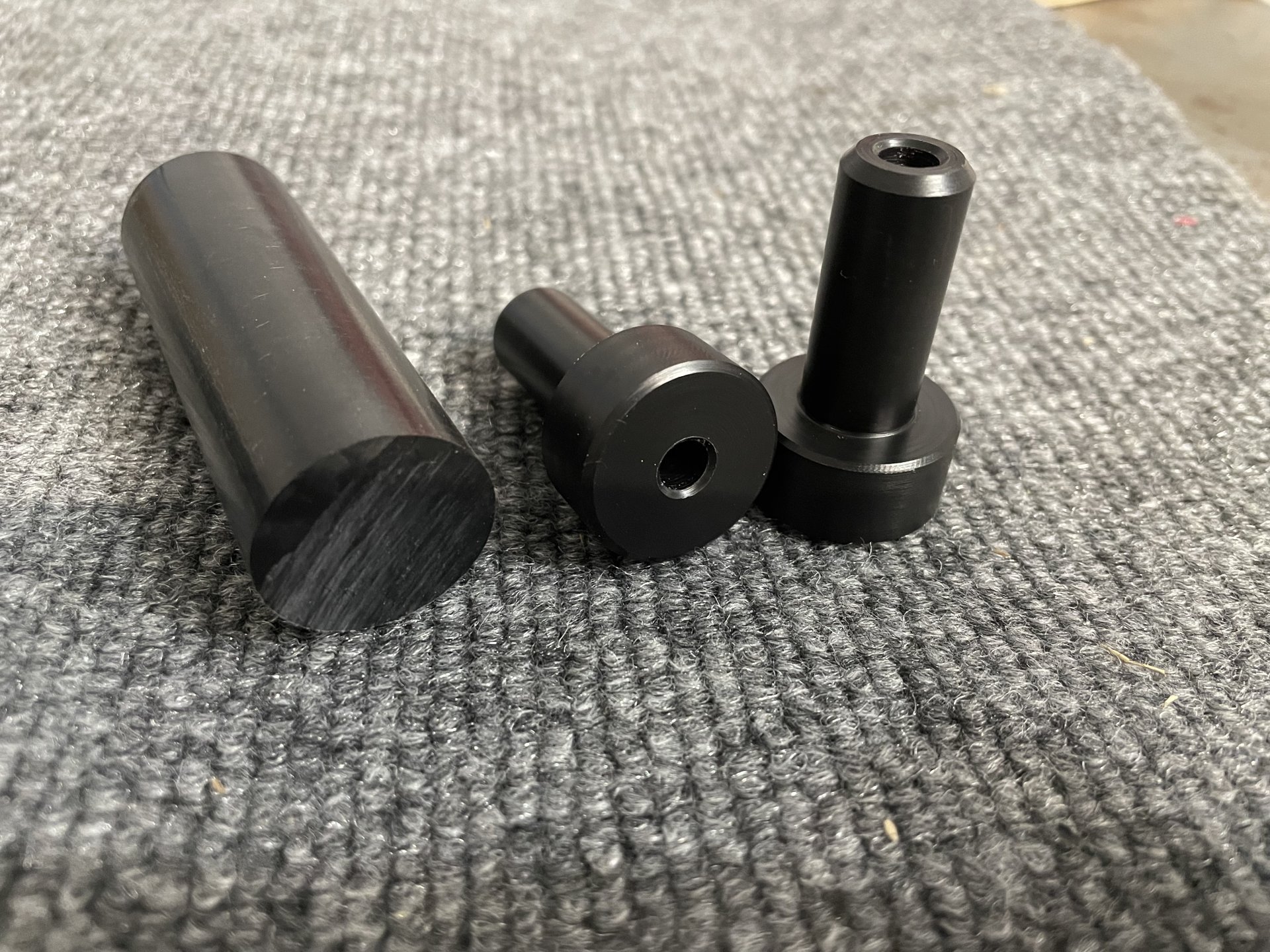

Quick update and a look into how one of the parts is made for those who are interested. 4 kits are made and heading out the door now/Monday/Tuesday. Parts for 13 additional kits are about halfway made as you can see below.
Raw Derlin stock is cut down to length on a portaband then faced on one side and chamfered so it runs true in the chuck as it’s faced on the other side.
The parts are made two at a time in one piece of stock then cut in half between them. The purpose of this while slightly wasteful is to provide enough surface area so the part does not slip in the chuck. Each pass is cut at .100” deep removing .200” off the part with each pass while advancing into the work at .078” per revolution at 1270 RPM. That’s damn fast on this little machine and I’ve found when clamping on the smaller feature or less of the larger diameter it tends to throw a good number parts which obviously ruins the parts.
Those two parts are cut apart on the bandsaw again then faced to final length using a shop made tool. It’s a MT3 taper that’s tapped 1/4 20 that gets drifted into the headstock. It lets me set to depth of the part .050” per revolution of the screw inside the chuck. I need only to dial in the first part, check the next two or three, then I lock the carriage and I can cut the parts down to size in one cut without even measuring.
Parts are then center drilled and drilled using a special plastic specific drill bit (6.1mm for a great fit on the 6mm fastener). All outside chamfers are done by hand with files as it’s faster than using a chamfer tool. Inside chamfers are done on the lathe with the tail stock. And here are the finished parts ready to go into a kit and out to you folks!

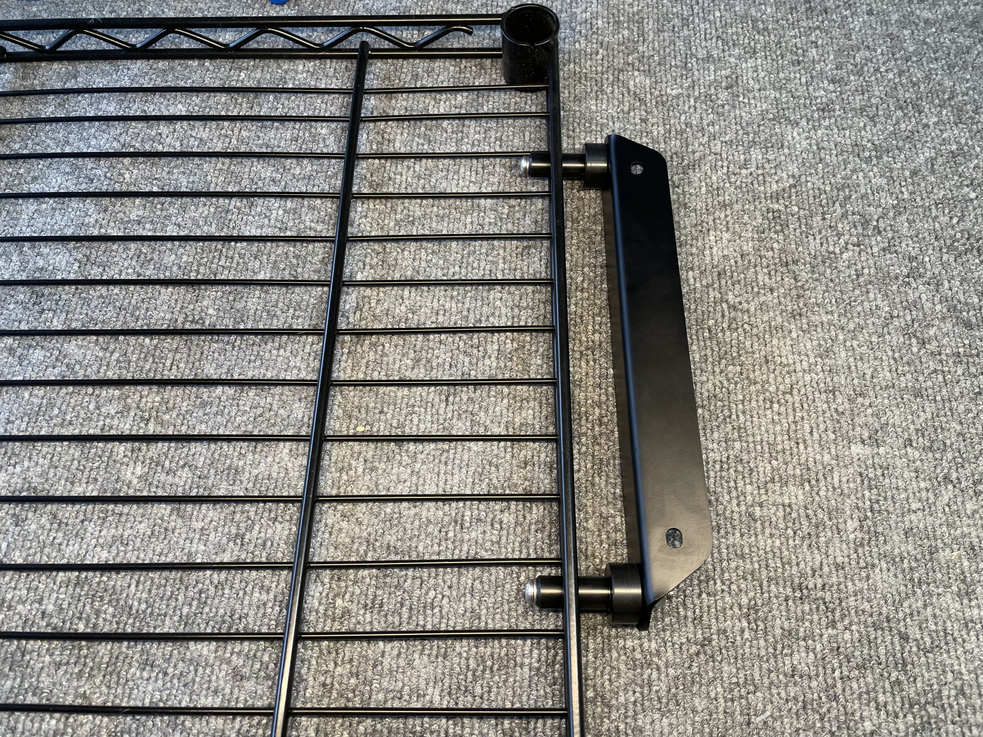

You really can’t see them in use but here is a picture of things mocked up on a work bench. The pins engage the trusses on the rack allowing left to right movement during assembly. These hold the rack on one side during assembly so you don’t have to balance and align all four corners to align screws.

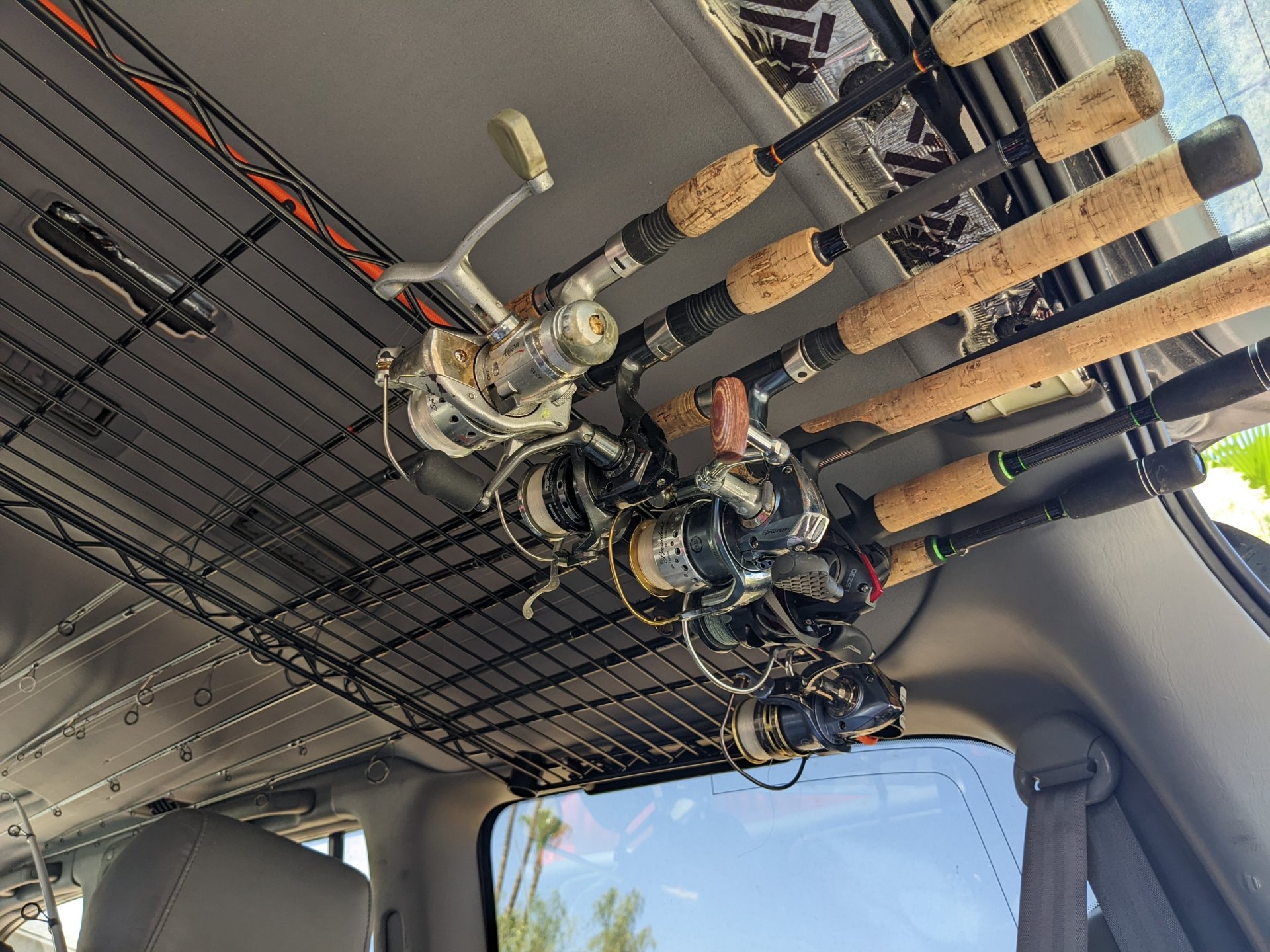

possible to get more photos of how transported? do the reels sit in the rack or rod ends interfere with hatch closing? this may be the selling point for me :)
I don't have any other photos at this time, but I put all of those rods in there this morning and have been driving around with them just fine all day. All of those rods are safe with the hatch closed, and they're your typical 6'6" to 7' medium power rods. I have some bigger saltwater rods with longer handles that I use for my catfish rigs, and those do interfere with the hatch.
For now, I just put a 4' bungee cord over the top of the shelf, and I just lift it to insert the rods. I don't think I have this whole thing perfected yet, but it seems to keep them pretty stationary when driving around town. It might be better to secure the front of the rods together with something like a velcro cable tie to keep them a little more planted when off-road.
