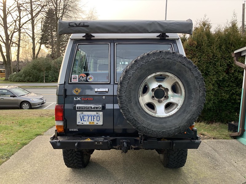

The nice thing about the length of those 65" Thule bars is they left a nice amount of space at the back to mount an awning.
I don't know what the hell I was trying to take a pic of here, but you can see one awning bracket hanging off the right bar...
After scoring a Foxwing 270 degree awning for my 81 off craigslist, I had a small CVT left over gathering dust so on it went - oh yeah, I also removed the fuel can swing out from the bumper. Since the 74 will be mostly a day tripper or weekend rig most of the time I figured it was dead weight. Easy to throw back on if it gets pressed into "emergency back up wheeling rig" status on a long trip though.
Pretty good fit, though it does stick out past the sides of the 74 top some. We have some pretty tight brushy trails here that I would probably remove it before doing, but I think the majority of the time it should be ok.
Nice to have shade/dry space at the back of the truck.
I'm pretty happy with the whole rack/panel/awning set up, it looks decently tidy. Badly needs an air deflector up front though.
