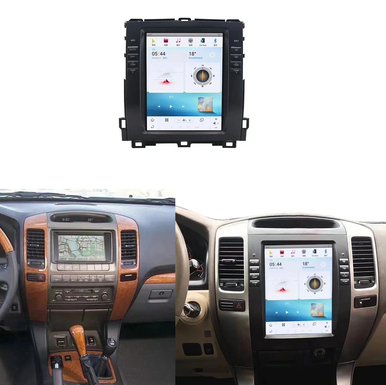

10.4" TESLA-STYLE VERTICAL SCREEN ANDROID NAVIGATION RADIO FOR TOYOTA LAND CRUISER PRADO 2003 - 2009
Got an ‘08 GX w/factory NAV and looking to pull the trigger in this unit shortly:
A couple of questions I have are:
1. Has anyone ordered this unit from Phoenix in the last couple of months? They are claiming the new model has built-in carplay but I need to make 100% sure as carplay is 70% of the reason for me getting one for our GX.
2. Is there an aftermarket backup camera that fits in or with only slight modification to the factory location? (eg. replace the factory one with an aftermarket one in the same hole). If not if I install one on the spoiler what’s the best method/location to run the wires to the unit?
3. Has anyone also gotten the WiFi ODB II scanner that enables viewing of the vehicles vitals and such? Example: WiFi OBDII EML327 Adapter Scanner (Fits vertical screen units) - Does it show MPH? How well does it work?
4. Where’d you mount the GPS & Satellite radio antennas?
I’ll be having Best Buy install mine along with the satellite radio antenna and new backup camera so any upfront installation tips from those here who’ve done it is appreciated.
Hi Torgue,
Installed this unit over a month ago. The unit works with wired car play very well, but wireless car play has failed (claimed to be able to function on wireless). The wired connection is via an OTG cable which unfortunately on my unit failed to work after 2 weeks. I’m in the midst of sourcing for replacement unit which unfortunately is not easy as the cable with 8 pins at the back isn’t common.
Q2 - yes its easily available.
Q4 - gps antenna on mine is just stuck behind the headunit - somewhere inside the dash and I’ve had no issues with reception or gps detection lag when using waze.
Hope the above is of help.

HI All
i bought the android radio back in mid 19 and its never really worked....disappointing for sure. it looks great but the mediocre performance and many features that just dont work... i'd hesitate to recommend this. i dont daily drive the GX but i am growing frustrated and thinking there has to be some resolution. seems many people are having success.. Maybe someone knows the correct firmware or whatever may help get it mostly functional?!?!
  1. from day 1, only the side buttons for climate controls work. the only on screen buttons that work are the air recycle, dual AC on/Off. the speed control, temp and zone (where the air comes from) dont. seems the hardware (canbus? interface) is working... since some on screen buttons work.
    1. I spent 4 hours on video conference with the android guys, we hooked back up the original Lexus climate controls, (everything worked) but ultimately they wanted me to try to load every version of firmware to see what works. i havent had the time for that!
  2. the RPM, speed things on the home screen never worked.
  3. the clock comes up with a different time just about every time i turn it on.
  4. Play store used to work, doesnt now. this means Spotify doesnt work now either, it needs updating.
    1. when Spotify used to work, it never stored/played back downloaded music.
  5. downloading a google map was never stored on the unit
  6. the built in music player (for memory stick with music on it) works fine, but there is no way to change to artist/album view, it just lists the songs. not good when you have a ton of organized music.
  7. Bluetooth audio works great with iPhone 7 and 11, but Pixel 3/4 have skips in the playback.
  8. dont really care about phone link, video, etc.
if i could get the climate control to work, i guess id be happy. seems to get the rest working, it needs updated firmware and probably a new android version if the play store isnt working??
if anyone can point me to working firmware version and maybe some reset instructions, id try that. im in an 06 with ML stereo.

I'd say my Android unit is 95% functional. The side buttons don't work (depends on your vehicle OEM setup so that's normal) My only real complaint is the hardware is a bit outdated and slow sometimes but it's still a much nicer experience than using what came with the vehicle.
The other issues you list sound like it's losing power between power ups. My guess would be either incorrectly wired (it's not easy, worth checking) or the unit has a defect.

Got mine installed today. Naturally have issues, some I got fixed but most I didn’t.
1. No audio at all. Zero.
2. AC controls on the screen do not work
3. Zlink got my carplay up and running using the usb cable. Runs mostly ok.
4. Hotspot from my phone connected once and now won’t connect again.
5. Cannot figure out how to change the meters to feet for the altimeter.
6. There are three connectors from the vehicle that do not have a home connector from the radio...
7. My right wood trim piece is almost cracked...I guess I have only one or two removals left before it cracks. So I really don’t want to take this out again. I had to remove it three times during installation.
Those are the main gripes so far. Overall I am a little unhappy but this will change to happy IF I can get most of all of these issues fixed.

Did you turn the volume up on your OEM radio before taking it out? I turned mine up to 38 before taking it out. The AC temp up/down normally won’t work on the screen, but are you getting the fan speed, auto, recirc, etc to work on the screen? The 3 extra connectors on the car I think is what I had....don’t remember. Altimeter is weird...mine never worked. Leave the wood trim off until you can get everything tied up. Mine is the same. :(
