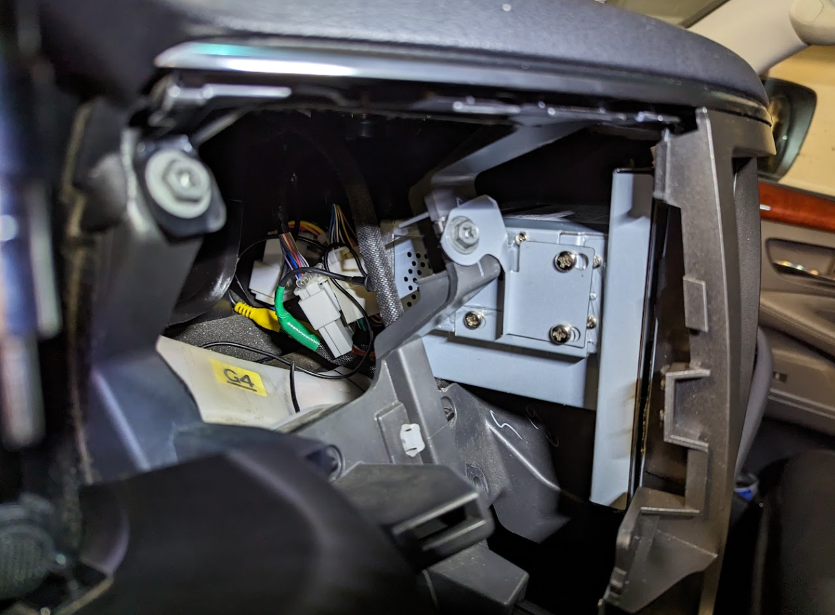

There's a ton of harness and plugs to deal with. My GT6 came with primary harnesses and I used the ones with a * for my 2009. That needs to be combined with the other two minor RCA harnesses to interface with the ML amp.
The harness on the car side is pretty wicked. Need to bring the car side harness from the lower area to the upper area if that makes sense.
Not going to try to detail what goes where, but basically work through it to see what matches where and this picture might help. Good luck...
Harnesses use
The metal brackets are poor fitting and needed to be tweaked to bring the HU tight and close by slotting the two holes on the GT6 side.
Here's what that looks like
