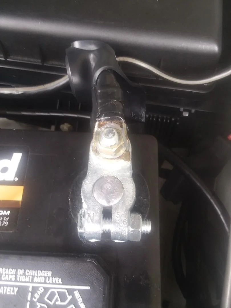

Electrical : 04-10-18 New DieHard Gold Battery with Marine Grade battery Terminals

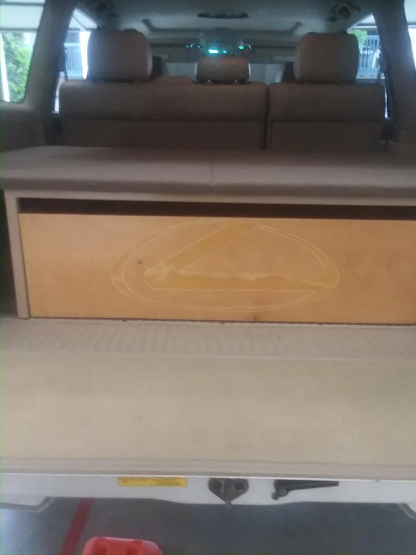

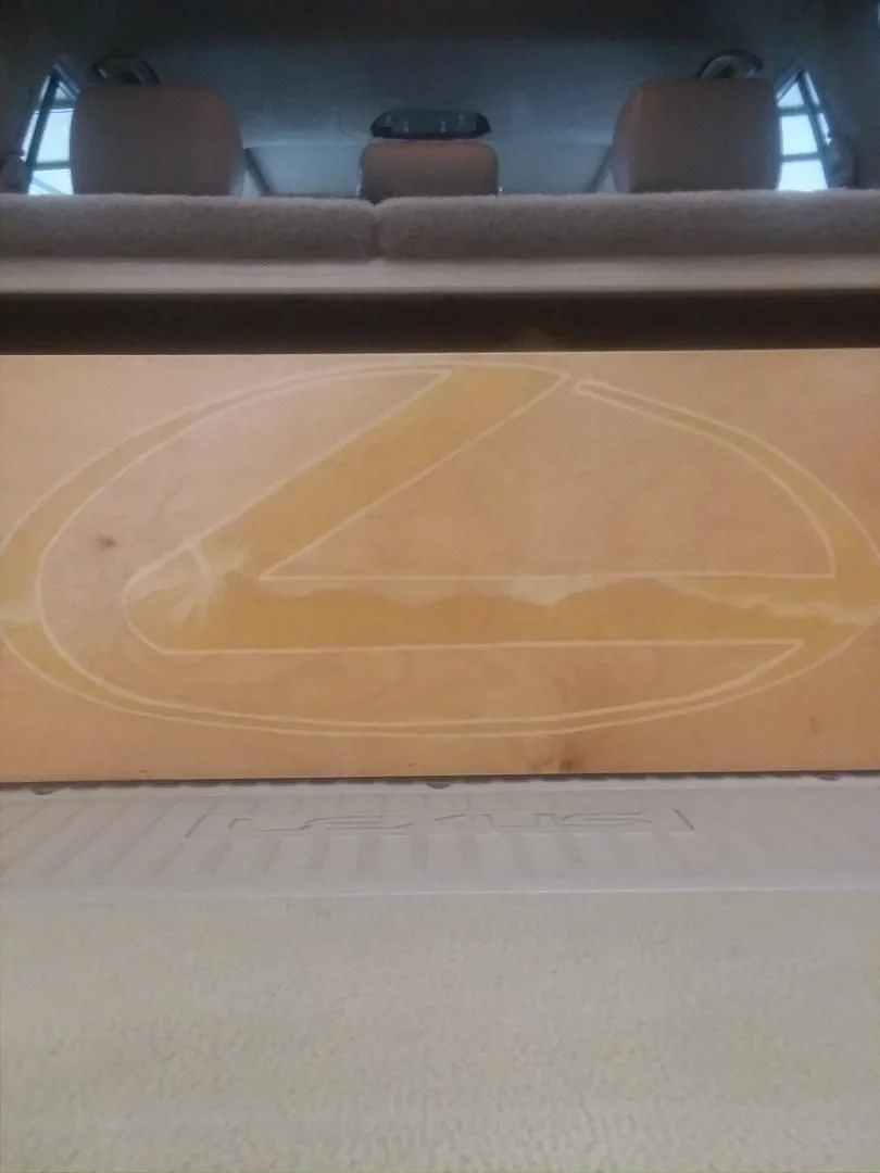

Interior : Rear seats delete, homemade rack and spare tire storage with custom storage drawer

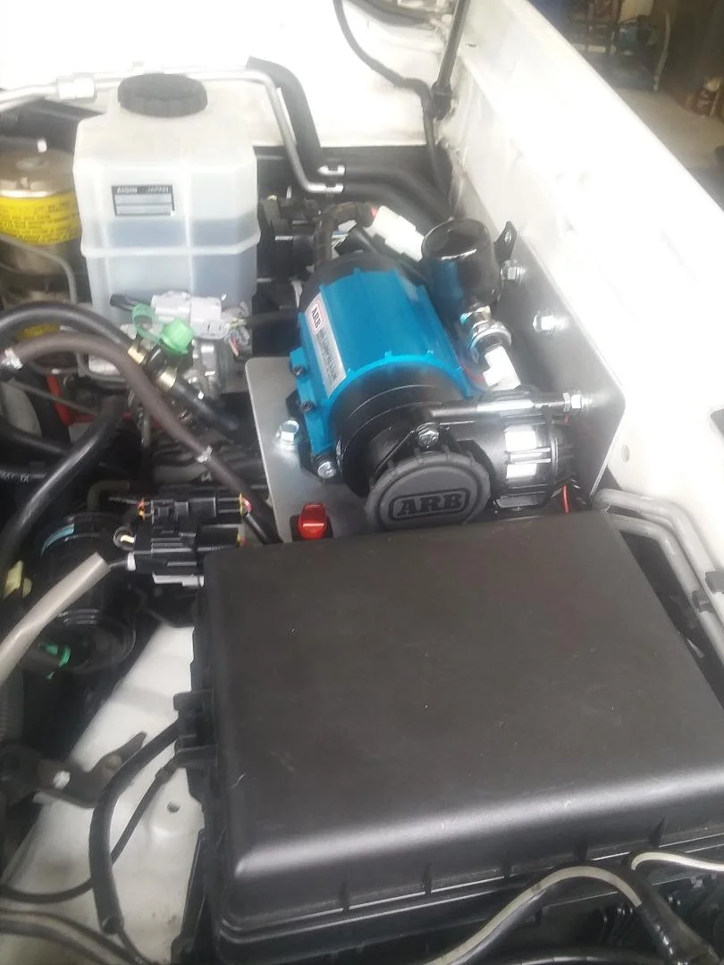

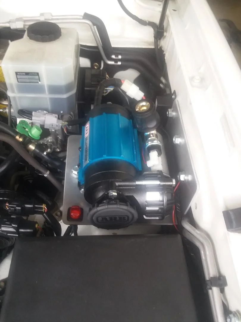

On-board Air : Homemade engine bay ARB comp mount

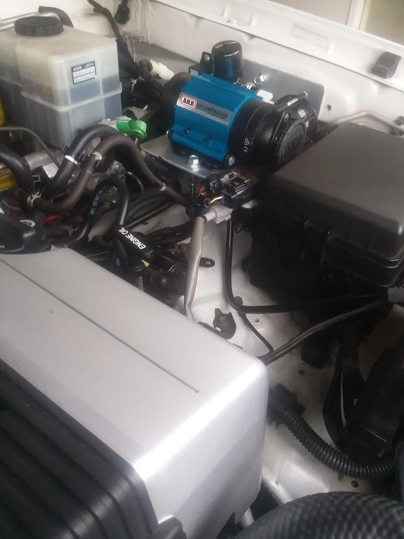

New hood and hatch struts

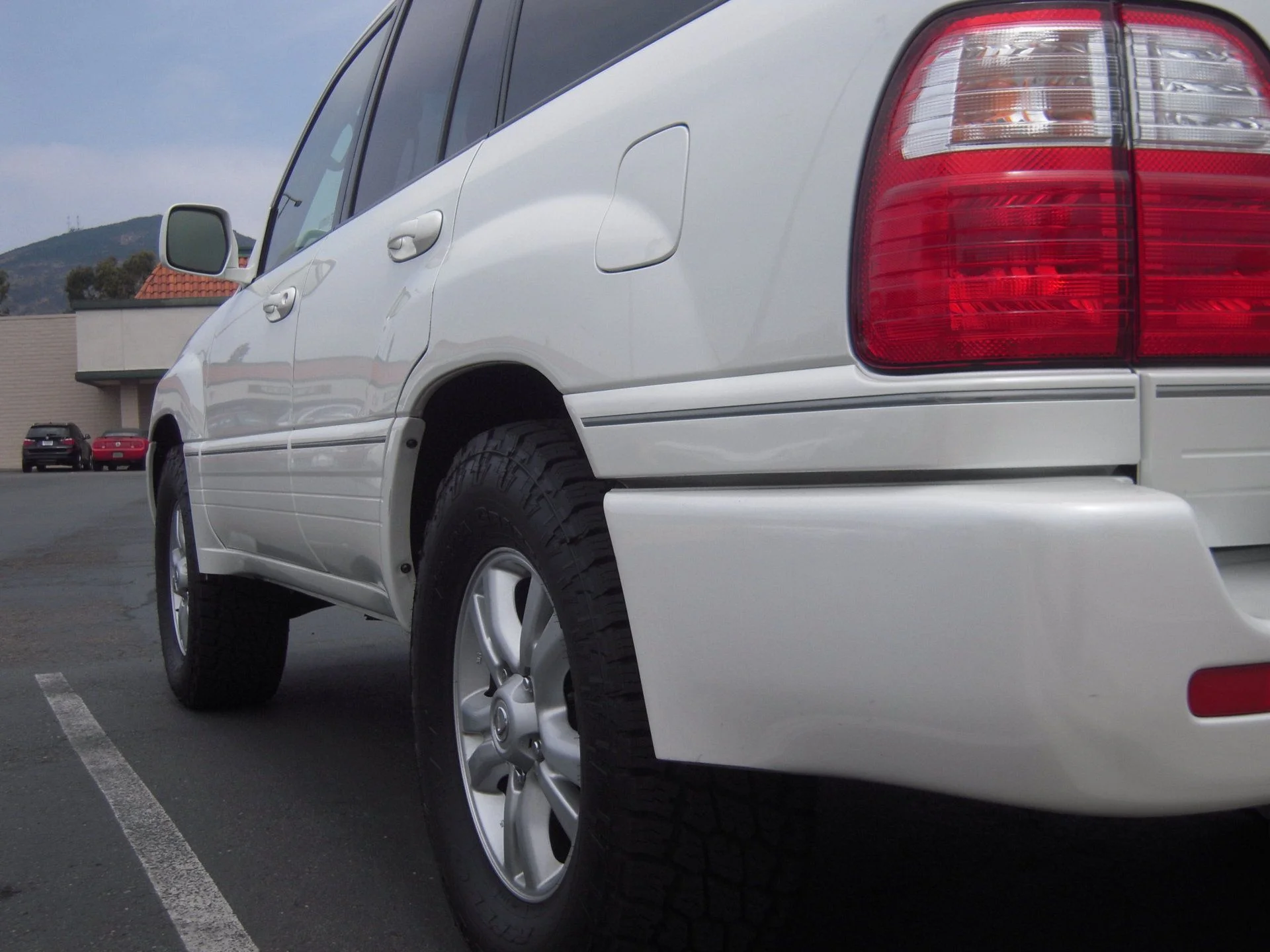

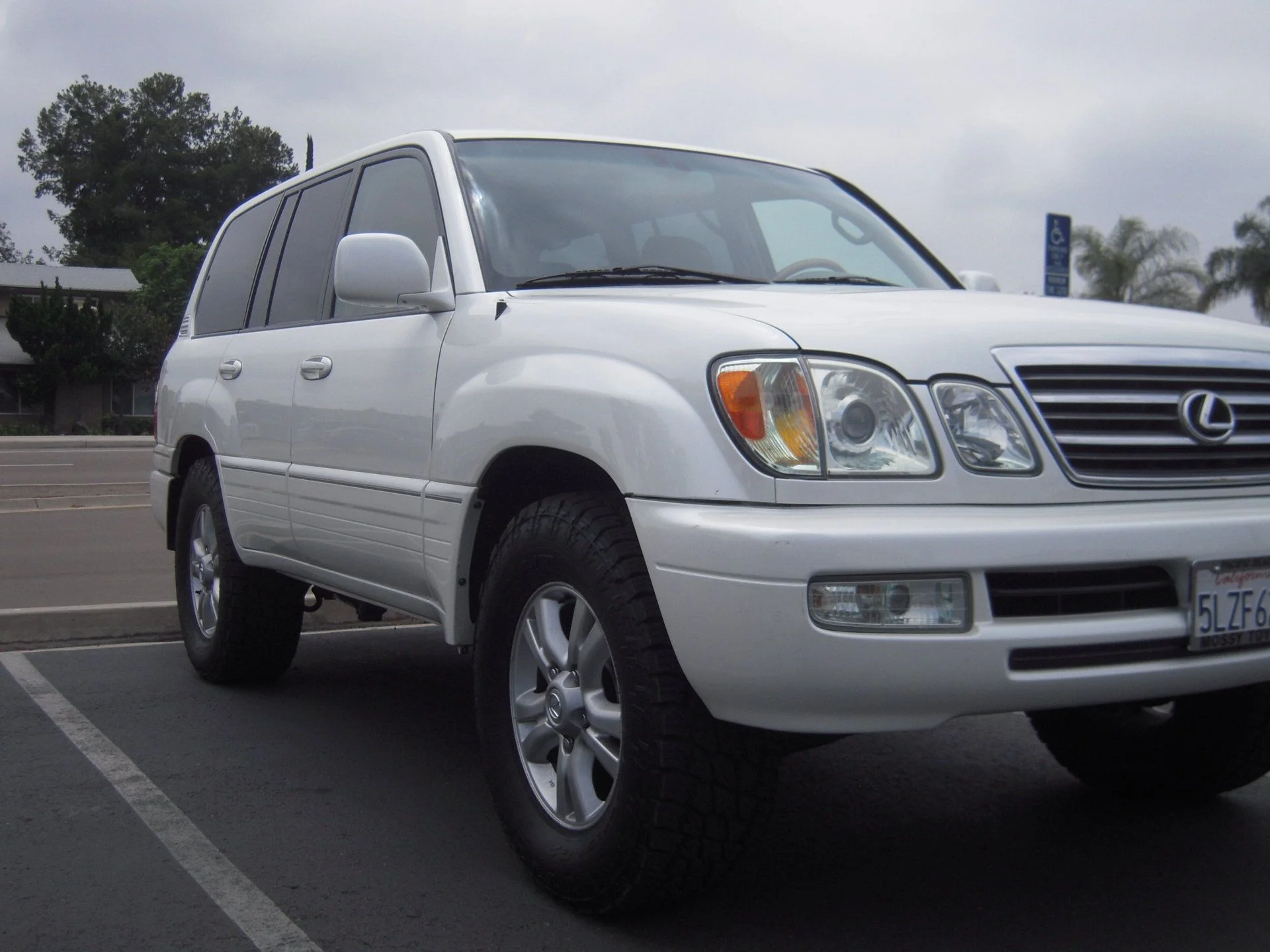

Wow that tire size looks great with that amount of lift! Interested as well in how you tweaked the AHC.
Do the tires rub? How did you adjust the suspension?
No rub on the tires.
I did the standard AHC minor lift with advice from this forum. I only used the slide adjustment on the height sensor and did not touch the adjustment rod. I then adjusted the torsion bars and used my scan tool to get the AHC pressures back to factory spec. The car sits perfectly level now front to rear and side to side. I know the majority of people on this forum say these LX/100 series have to have some front to rear factory rake or it doesn't handle correctly. Mine is only 1" higher in the front from stock and the vehicle handles perfect at 5MPH or 85MPH. If you do a thread search on AHC sensor lift you will track down some good results. I would advise only doing a minimal amount, as anything to much is when things will start handling/wearing funky. If you notice even with my 305 tire (12" wide) on the OEM wheels, it still stays inside the wheel opening. Keep in mind too, the higher you lift these A-arm vehicles in the front, the further "in" the tires suck in. If you have AHC, drop it into "L" and see where the tire sits and put it in "H" and notice how far in it sucks. I think the 305/65-18 on OEM wheels is a great combination. I have a 5spd trans and no re-gear needed with this 33.58" x 12" tire. And it rides nicer than stock !!! Good luck with all.

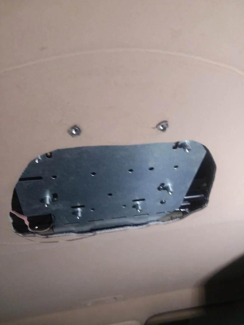

Started my overhead DVD screen delete. The only dome-light the LX had was in the far back and that only came on with the middle row doors. The front doors only triggered the lights on the doors and under dash. The forward map lights are manual switched on only.
Here is the giant hole and existing metal plate the DVD screen hooked to:
Here are the 4) 10-32 threaded stand-offs that I tack welded to the existing plate. I took accurate measurements for the 4) stand-offs with critical measurements from the OEM dome light.

The stance looks perfect... pretty much what I'm looking to do. Did you need to do an alignment, or re-center steering wheel?

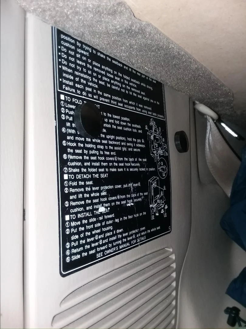

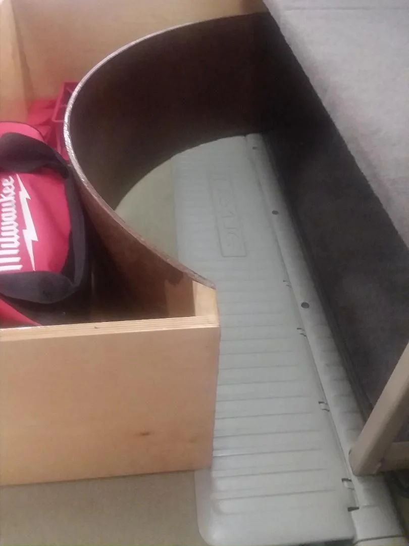

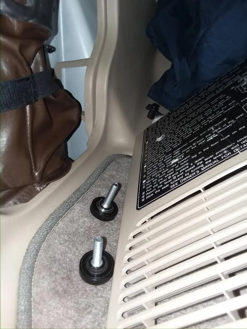

After I made my storage rack I realized I didn't have easy access to my spare tire jack/tools. I could of taken them out and put them in my pull out drawer, but the factory location holds everything nice and tight and rattle free. I wanted to utilize every square inch of storage inside too. The carpeted platform did not allow for release of the jack storage panel, so I cut a seam in the panel just below the storage rack and bolted in 2 aluminum straps and tapped them 1/4-20. Then a used 2 black knobs to hold the lower panel to the upper panel. I made the aluminum pieces a little to long so it's little tricky to get the tool kit out, but how often am I in there ?

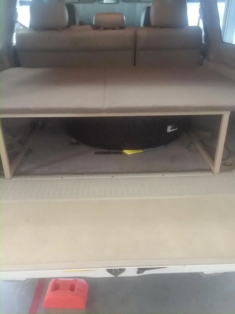

I've gotta ask, Why the spare in the back and not under the truck? The 305/65r18's should fit in the OEM spot, may be a bit snug, but you could drop the PSI a bit and use that compressor if you ever needed the spare
That is a whole lot of storage space that could have been used for other stuff :)
Surprised you are the 1st on MUD to ask. Two reasons. I was originally thinking of a bigger lift and 35's, so I had the inside storage designed and built in my head. Glad I stayed with the AHC minor lift and medium size tires. I am also very particular about looks, and that spare tire hanging down from the underside just didn't cut it for me. Plus I like to be different. With the pull out storage drawer and carpeted platform, storage/hauling has not been an issue. I like your question though.o_O
I’ve got a follow on question for you ;) have you looked into raising the spare tire support frame? Take a look at this link Spare Tire Mod ... Pics
That’d solve your problem!
The main reason i ask is that i love my drawers and wish i had even more space, I couldn’t imagine giving any up for the spare.
I had looked into that, and the small amount it raised it and with my 305 it still was very noticeable. I don't tow, so the OEM upper hitch that came on the vehicle works perfect for my bike rack. Some have the lower frame mount hitch for towing and that hides part of the spare, but gives you horrible departure angle.
