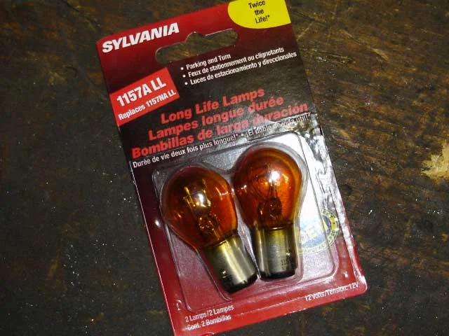

to make the bib light act as a running light and a turn signal, just add another wire (pronounced "war" for those Texans out there. :D)

Now get some clear lenses from whoever...and run an amber bulb... ;) 1157A
