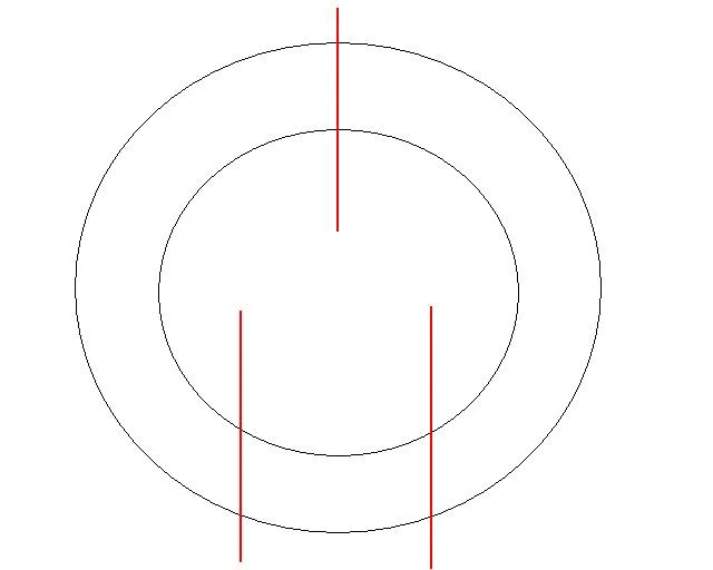

When I changed mine I used a small knife to make three cuts in the grommet and removed it in segments. Here is a crude drawing of the cuts I made. I made the two cuts at the bottom first, removed that piece, then made the third cut and twisted the remaining two pieces out. My grommet was also very brittle, and I still had a small amount of breakage, but it seemed to work pretty well.

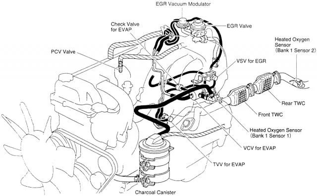

Does anyone have a picture of the PCV valve - and/or a short description of its purpose in an engine?!
