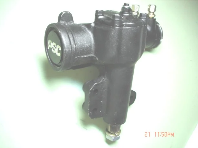

I'm using a Scout box, modified for hydro assist, by PSC. Larger sector shaft than an FJ60 box:

The scout box has more power, but the 60 has better road feel. It's your choice.
