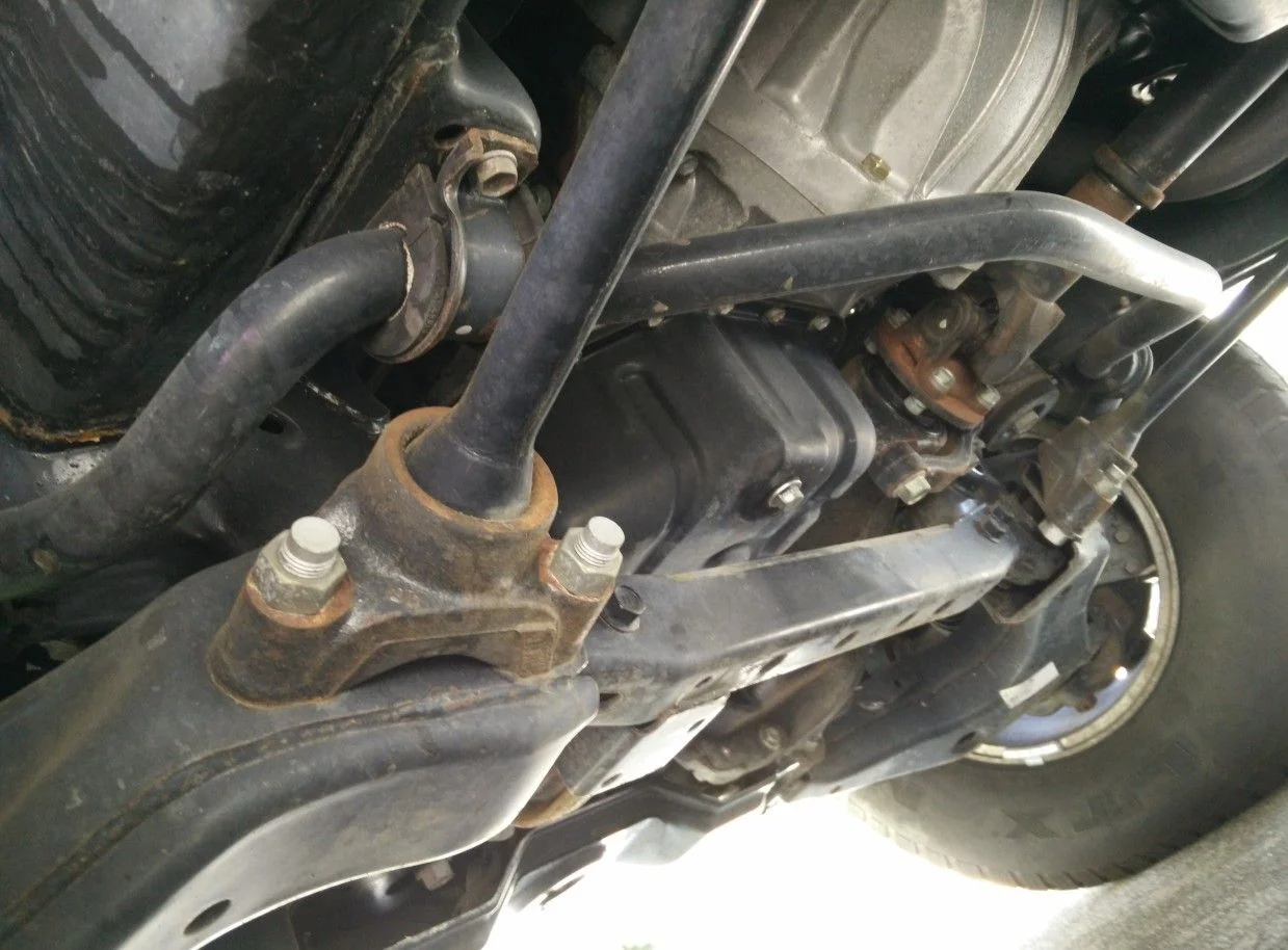

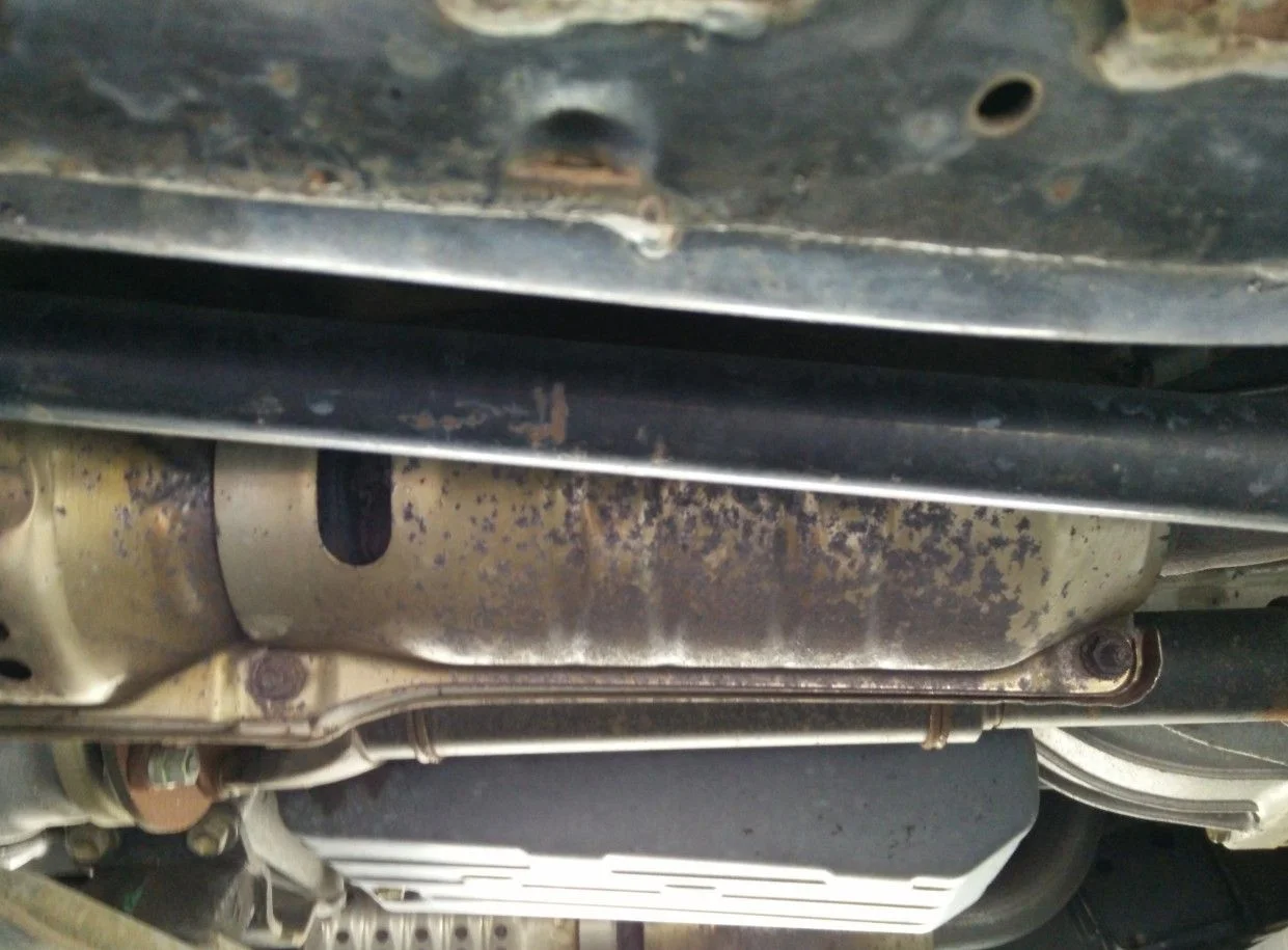

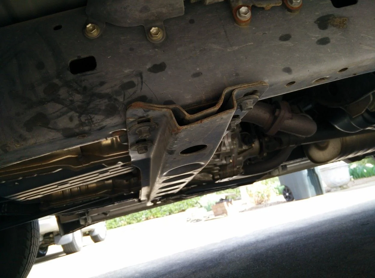

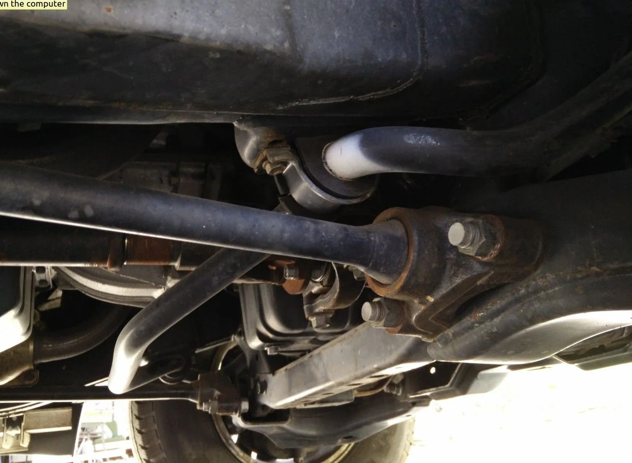

There is going to be a little Surface Rust on nearly all 10+ year old LX's.
As a reference, here are photos of my 2002 LX from Santa Barbara, California - 24K miles:

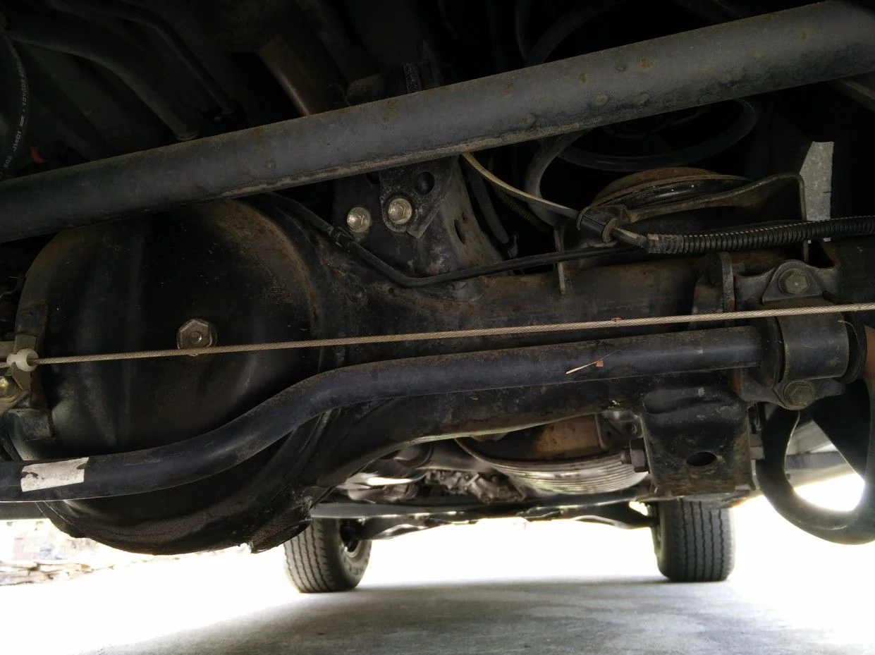

Here's another reference of underbody rust...I saw this car in Charlotte 2 weeks ago. Its sold now..which i cant believe. It was a rust bucket. It also had rust bubbles on the doors corners. It was in bad shape.
https://goo.gl/photos/jWi3KBjMRkhdBdSg9
@cwmoser- don't think your 100 counts as rusty, that's not really rust- that's rust dusto_O- heck you still have shiny fasteners.
The OPs prospective truck however is a good example of sub par Japenese steel marinated in New England brine. Not what you want to buy. Especially the ad stating Excellent condition- Wtf ?
