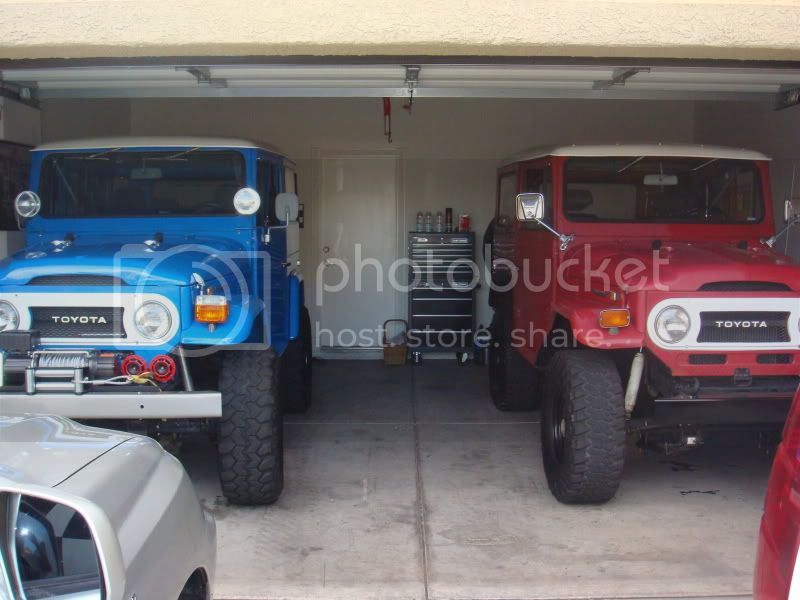

I picked up this 40 from a fellow mud member and have been getting it back to streetable condition. It's a 1974 FJ40 with a SBC400 mated to the stock tranny/TC. Overall in good condition... a little minor surface rust on the rear panels, some surface rust on the chassis, and one spot of rust through underneath near the driver's seat. Nothing that can't be fixed or alleviated! So far I have:
- new plugs, wires, distributor, oil change
- new valve cover gaskets
- new thermostat and gasket
- flushed radiator
- new master cylinder for drum brakes plus one wheel cylinder
- in process: mini truck power steering conversion (almost done)
Next up- fix a couple of minor electrical issues, then start treating the rust. Will probably not do a frame off, but will treat underneath with rust bullet, treat the surface rust on the body, and patch the one rot spot. Otherwise, I'm ready to drive it!
