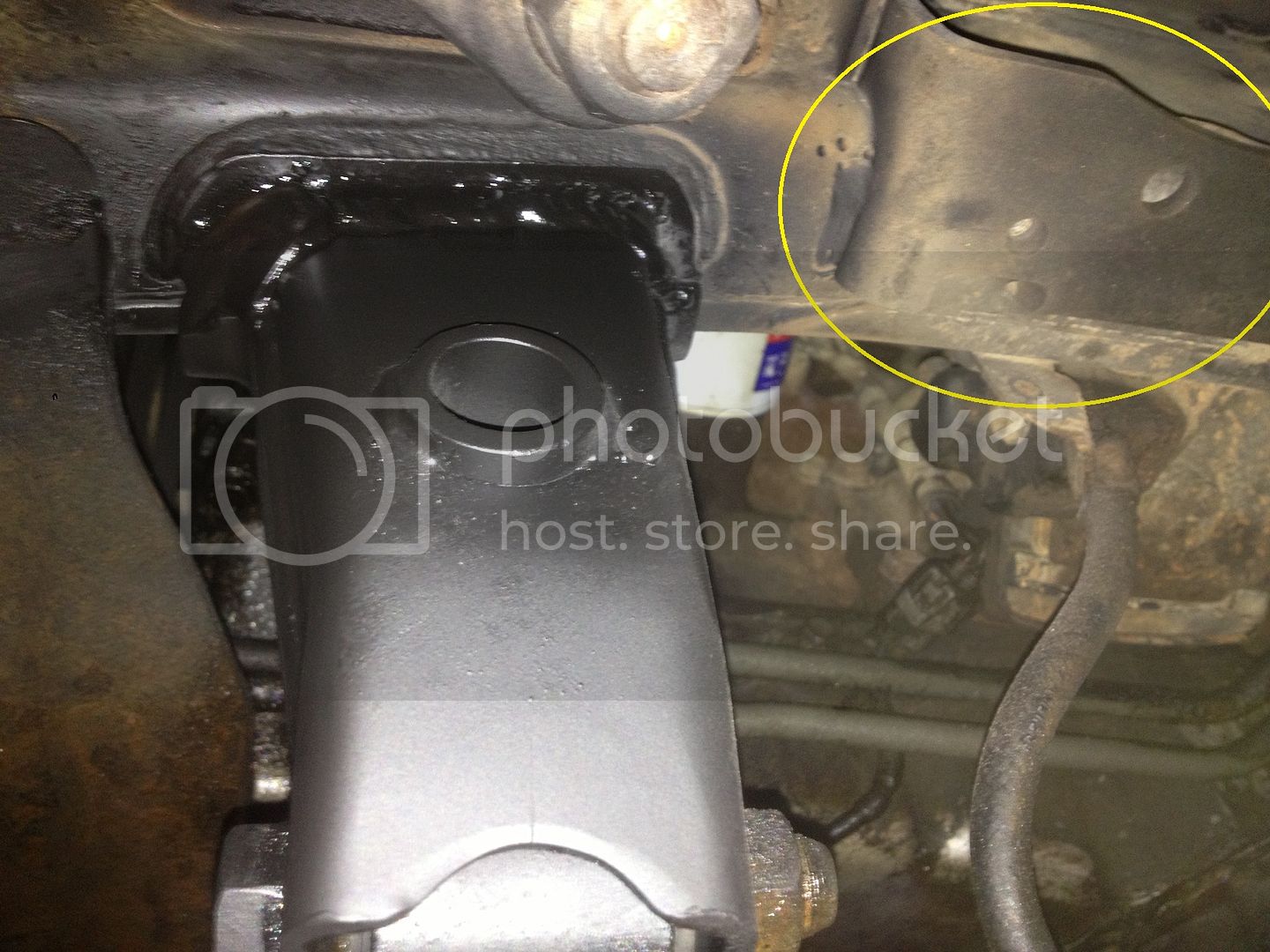

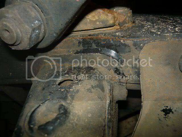

From the Aug 92 update we got chassis bump stops on our 80s as the coil towers were bending badly just running the inner rubber stop, so for us they come in contact with about 40mm of up travel and we cant bottom them out.
This is what happens without the chassis bump stops on early models. [From memory the USA get the bump stop bracket from bottom to join to coil tower to hold it against chassis with holes to bolt the bump stop on, just no bump stop * see bottom pic]
And this with no inner chassis double plate.
This is SNOWY set up so 96 with the plate on, but no rubber bump stop on it. [yes, had weld the panhard bracket on LHD too for cracks]
