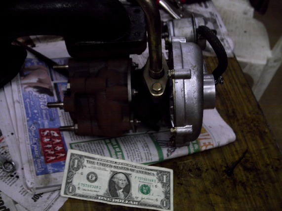

I order my turbo gauge with new 3 pod and bla bla bla .. here some pìcs of my turbo what a Faw**** nice view eehhh !
I found it for a nice price .. is rebuild as you can see
I'm not sure about the exactly model .. but I thought is same as my buddy Julio ( redstang here ) buy in a 3B turbo kit
This is the place in my turbo housing ..
This one is the Julio's Tubro with my pipe .. ( hahaha well I need to copy it )
Waht do you thing about the size . ?
Comparisions .. this is mine
other view
This is the Julio one ..
Enought for my 2H .. ?

The turbo that comes with the turboglide is a bit bigger. Also, they sell different sizes for 3B and 2H, same as AXT.
However that does not mean yours is not big enough :D
Where will yopu mount the intercooler? I would suggest to do the turbo first, then tune it and optimize it, then add the intercooler. Like this any potential issues are easier to narrow down.

What are you using for a manifold? The turbo I have (i believe it's an old Safari unit) is a little larger as well, but I (and a few other cruiserheads) thought long and hard about running a turbo from a mercedes 300 series which looks about the same size as what you have posted. Without the a/r numbers it's all speculation, but you might like the fact that the turbo spools sooner than a bigger one.

looks great IMO. I have done a couple intercoolers with the cummins. What determines the intercooler is space in the actual truck IMO. I would measure measure measure, see where you want to put it and carefully get the dimensions of each before you buy. Also make sure you measure for the ports.. It would be a bummer since you have to ship all the way down there. Neat enough though. For what its worth, I think the benefits will be mild possibly hurt it if the intercooler is too big, if your EGTs are already decent it might not be worth it to put it in. Also ports on that turbo and on the intake for the 2H are small so I would try to match with the intercooler, otherwise you will need some weird adapter pieces. We got all ours at www.intakehoses.com who has been great, 3 orders from them now, more to come :) Intercoolers are neat bling factor thing but possibly overkill IMO. Some people have reported bypassing their intercoolers and better performance.. It is not always a good thing for what its worth... :beer:

In my mind I don't have a really huge intercooler .. I'm still thinking in a little one, coz my turbo are not really huge as you can see ..
Also I'm plan 3" exhaust pipe .. to keep cool the EGTs .. I'm not sure about the 2H intake diameter .. comments .?

I would recommend using the smallest size piping you can get away with. I dont know what size the 2h intake manifold is but on a 3b it is 2 1/4 inches. In my situation 3 inch piping was a waste. You do not get any benefit from the excess size. The turbo has to pressurize these pipes and intercooler to 10-20 psi and any excess in diameter of piping, or excess of volume of intercooler will be wasted in turbo lag.
When I first put an intercooler on someone told me 'bigger is better' so I went with a powerstroke intercooler off a big nasty diesel Ford. To make a long story short it took about 15 seconds to build up 10lbs of post intercooler pressure, which was excessive for me. Needless to say I switched my 3 inch piping to 2.5inch and added an aftermarket supra intercooler. Things have been golden ever since.
I would go with the size of your intake manifold. My guess is that 2 inch or maximum 2.5 inch would be the way to go. I went 2.5 as this matches my intercooler.
