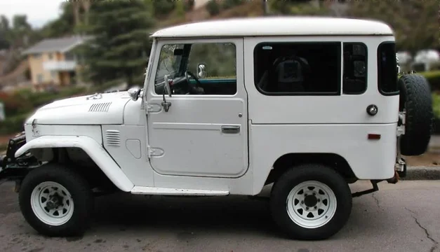

Of course, having the parts wouldn’t tell me where they went and what better way to complete the puzzle but to buy a California correct Cruiser as a donor vehicle. See how the sickness works? I found another 1977 Cruiser in Orange County for very little money. She’s bone stock, suffers from a terrible paint job, and unlike FLYR has some rust damage in her rear quarters. Also, in her teen years, she was apparently something of a metal head as she has multiple wires that lead into blackness and numerous holes in her dash, pillars and body apparently for various ornaments most of which were long gone by the time I got her.
I got the second Cruiser home and it was not well received nor was the time, energy and money I spent acquiring various necessary Cruiser parts. After the divorce, she sat in a storage shed patiently awaiting her awakening.
This winter the time has come to air up the tires, roll Patience out of storage and began the long road back to health. Unlike humans, Land Cruisers can be made young again. The wrinkles and rust will all be removed, the awful white paint job will be peeled away and Patience will be given back her original color, most all parts that can be replaced or rebuilt will be. I appreciate your comments, insight and :flipoff2:. .
