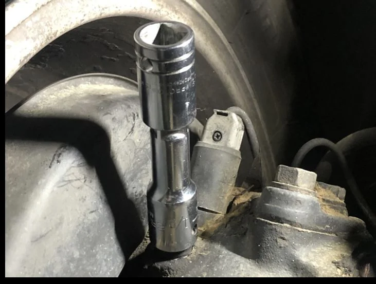

looks to me like a 14mm 12 sided socket fits these square studs. my geometry is not kicking in but anyone know how wide these are of why they are square?

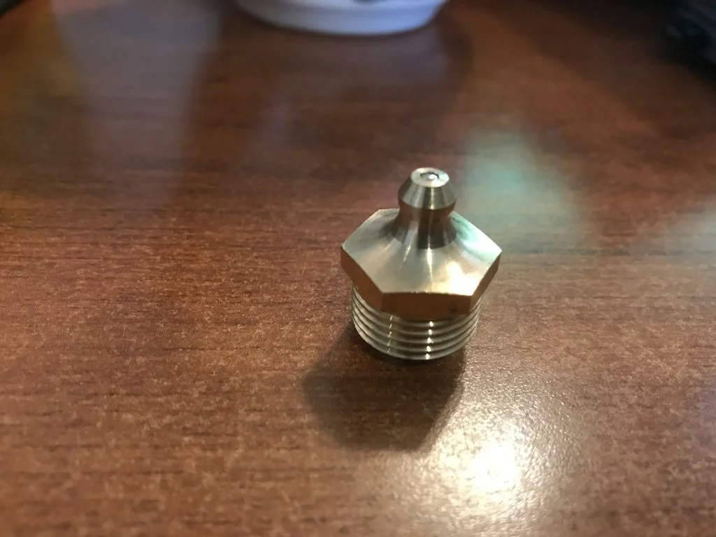

also. does anyone sell a zirk fitting you can just leave in there? or one you can put in temporarily? it would be way easier to just hook it up.
Use an open ended wrench. People have modified them for zirc fittings but I would be a little concerned about adding pressure to that cavity. You only want it about 2/3 or so full. Not critical to get it perfect.
hi WE. sorry i missed that part. so you don’t like a zirk in this location because you could add air pressure to the cavity? so it would be pressurized while you fill if you fit a zirk basically? THANKS
With a zerk it would be WAY to easy to pump in too much grease and pressurize the cavity with grease. That would blow your axle seal.

And the open end wrench in your tool kit, in the back quarter panel with the jack, fits.

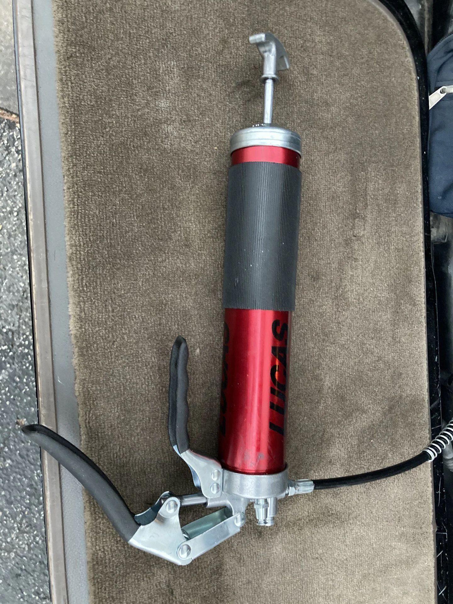

got it. i suppose once i get sorted (eventually...) in understanding the grease gun i am trying to use is not going to behave in the same way as a ratchet style construction glue gun i will have an easier time with this.
between jumping tires and ****ing with the grease gun and fiddling with the business end of the fitting i had my hands (literally) full i guess.

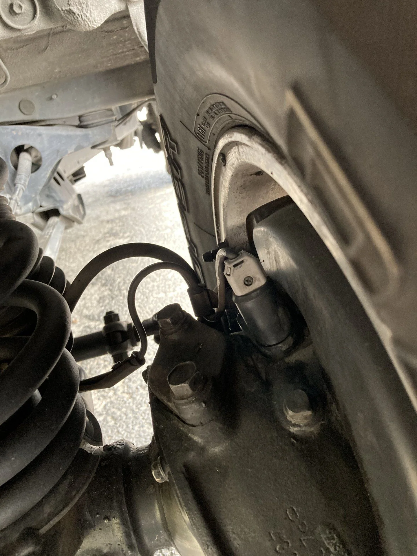

the issue is that a grease gun takes a truck ton of effort with one hand. i personally don’t have a good place to jack up the truck, take the tire off and have it be safe.
so i have the tire on, with one hand on the gun and the other holding the fitting in there or just balancing it with one hand.
presumably if joey put a zirk on the ABS replacement part he made it can’t be that hard to figure out it could be helpful.

With Joey's ABS replacement part you can still pull the fill plug as to not over pressurize the knuckle when adding the grease.

Because Universal Joints are pumped full until fresh grease is squeezed out of the seals, you don't care how much is pumped in, as long as it over flows. You have a single fluid joint, new grease displacing old grease. In the Birfield Knuckle you have an axel seal separating the knuckle grease from the the differential oil. If you over pressurize the Birfield you'll blow grease right into the axel and destroy the axel seal, allowing the diff oil to contaminate the knuckle grease. That little hand held grease gun can produce something on the order 5000psi of load on the grease. You would destroy the axle seal before you even knew you did it.

i'm still figuring out how to use the grease gun honestly. i'm used to ratchet style construction glue guns so i'm not really using it properly.
but just to play devils advocate you could leave a zirk fitting in there and undo that two bolt fitting partially couldn't you? or i suppose the risk of stripping those when retorquing would outweight the convenience.
i suppose if i look around there is a rubber fitting for the grease gun that would be long enough and i could take off the zirk fitting. or one of the long needle fittings. not sure i like the long needle fitting for this location though.
