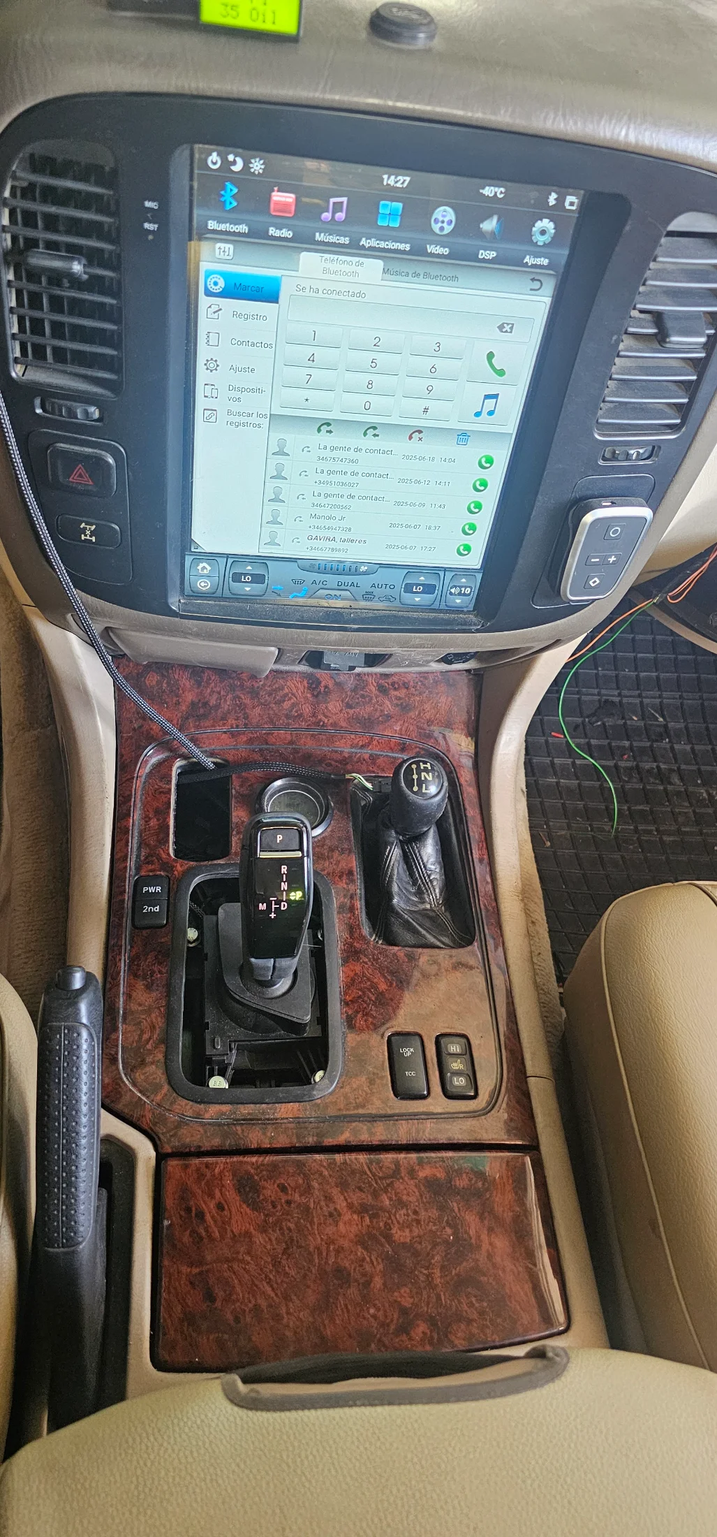

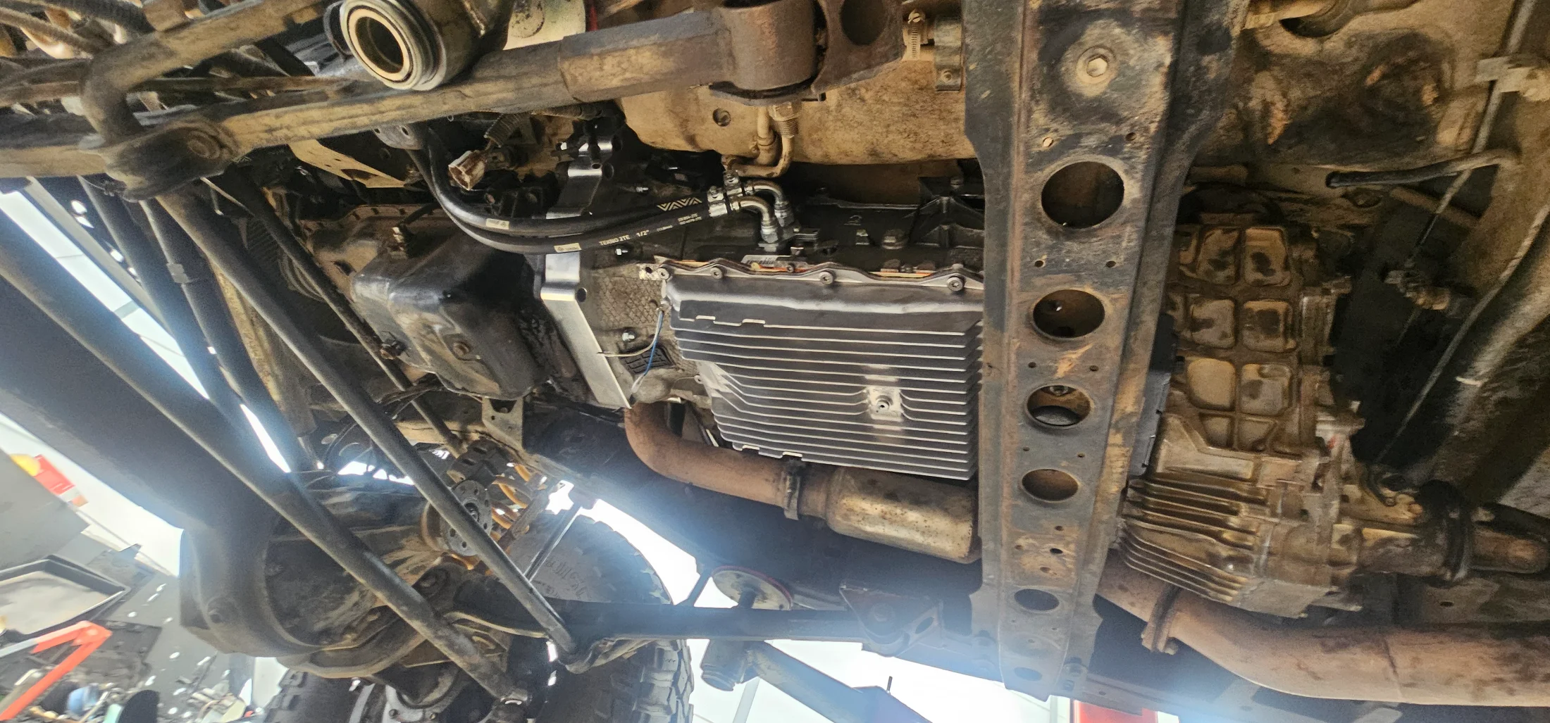

Hi.. My name is Manuel from mwr4x4 Spain. Two months ago swapped my 2001 a442 hdj100 to 8hp70x and results more than amazing... Im running with 35 and 37" with all mwr4x4 upgraded and frobt nisssn y61 solid axle.. Im the happiest person in the world now.

1. Who supplied your transfer case adapter? There appears to be a number of these around but their thickness varies and the subsequent modifications on the driveshafts also vary. I am awaiting supply out of the Netherlands by Patrick Roselaar currently. His adaptor is only 30mm or so and apparently does not require driveshaft mods.
2. What mounts have you utilised for the gearbox and what trimming or mods have been required on the gearbox , bodywork and other gear to enable fitment to happen.
3. Did you make your own gear lever cover and mounting or did someone else supply. Am keen to source a suitable cover and mount for my own conversion.
4. What type/brand/model of sump did you fit and did you integrate a temperature bypass as apparently the 8hp takes some time to get up to operating temperature on our Landcruisers.
Keen to see more pictures of key fitment challenges, work arounds and mods specifically for our IFS version 100 series. The Aussie folk have lots of 79 series and a 105 with the fixed axle but there does not appear to be much in the way of photos for the 100 series
