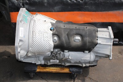

Messaging here as to not muddy up your other thread. I found a low mileage 8HP75 local to me 64k miles. Looks solid?
Higher price than I would pay imo. And I feel like I paid a lot ($1100) for the trans I ended up with that has lower miles. I would also keep in mind if you get a 75 which is a GEN two transmission you are limited to Turbolamik as they are the only ones with support for the gen 2/3 transmissions at this time. Keep in mind you will still need to spend about $2600 on adapters.
Thanks that’s a great point. Planning to also supercharge so Maxxecu will be a better option with a gen 1 8HP70 transmission instead of having the ECU + TCU.
