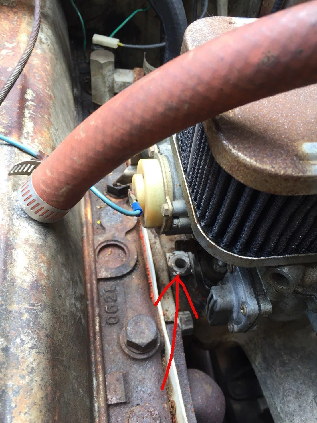

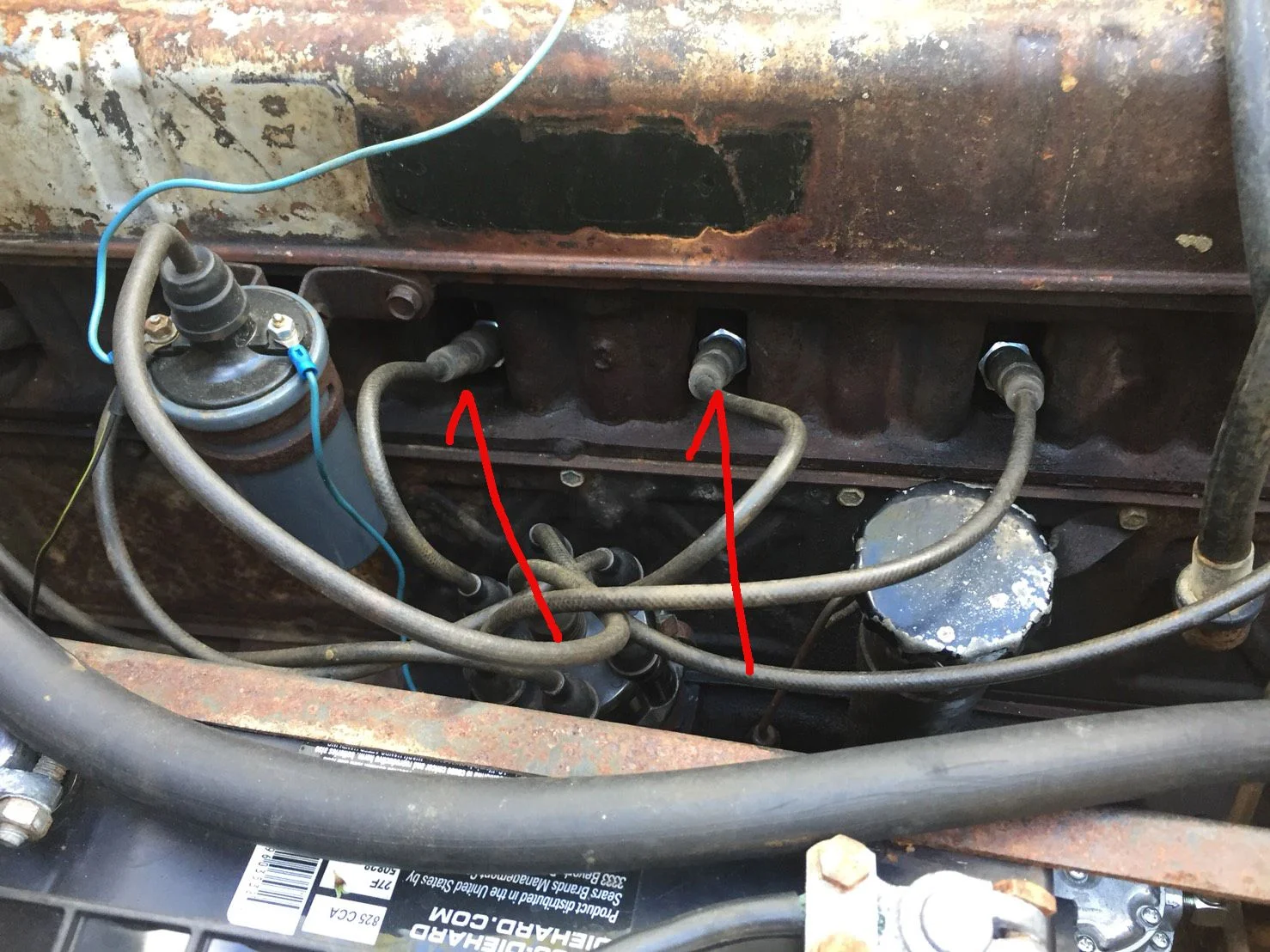

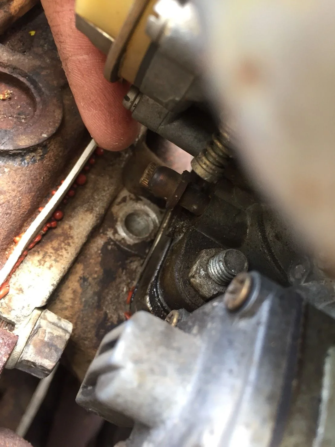

My truck was running fine until suddenly it wasn't. I limped back home and discovered that the two middle cylinders were not firing thought they had spark. Today I did a compression test and the numbers are all 160 and over except for those two cylinders that have zero compression. The gauge did not budge and instead the engine made a different kind of noise from when testing the others. What can I conclude from this? I thought perhaps the head gasket between the two has blown? And then I saw the hold in my manifold which I have included in the photos. Was there something screwed in here that has fallen off/out? I plugged it with my finger when running engine and did not notice any change or feel any suction but it does look like there are marks on the intake from a bolt. Any takers on this one?

The hole in the intake manifold is for a bolt to fasten the OEM exhaust manifold to the bottom of the intake manifold.
It appears you have headers. Ergo, no need for the bolt.
Good! Thanks!
Good! Thanks!
