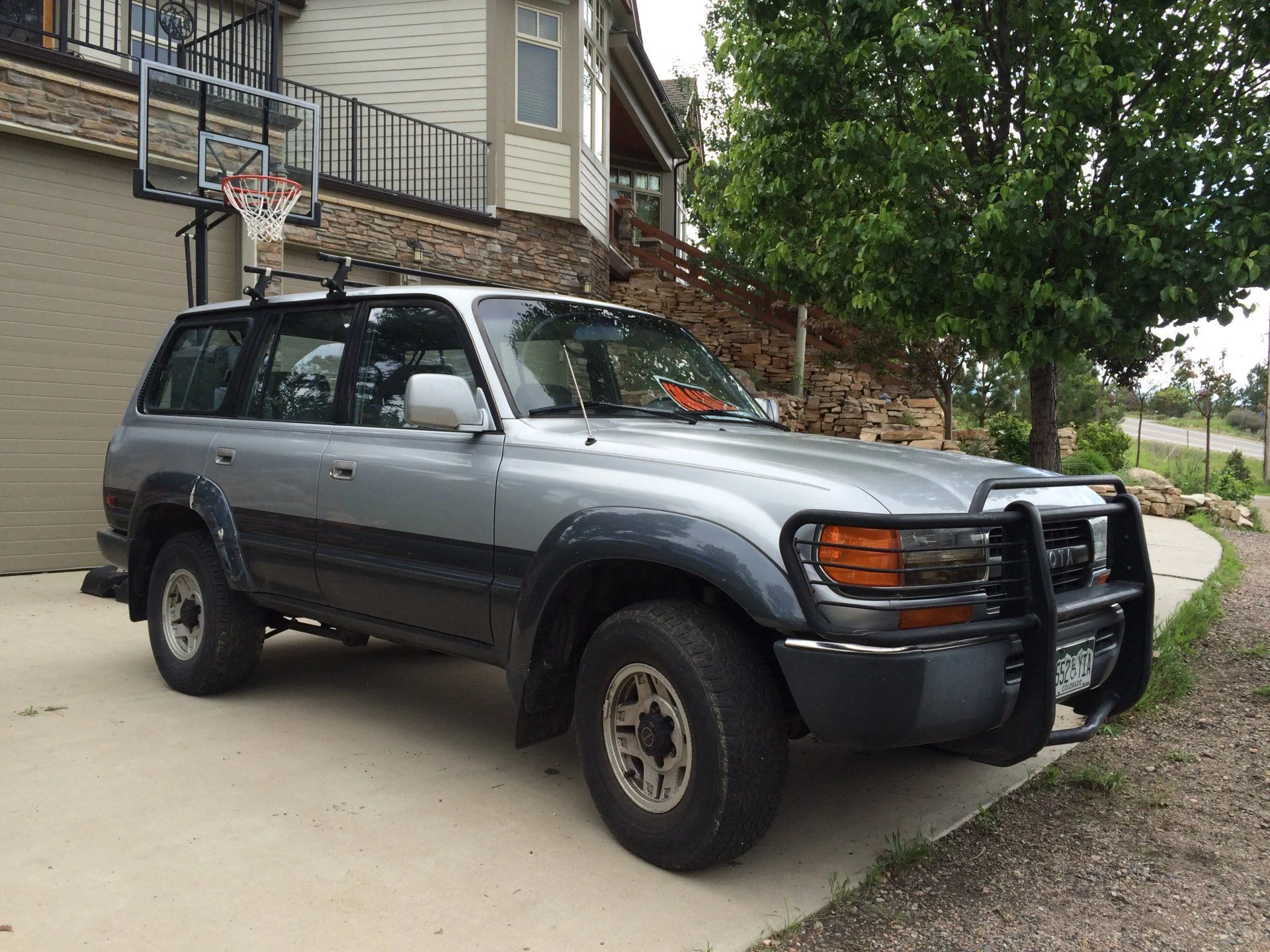

This summer I finally had an excuse to find the 80 I've always wanted, I became a father. I'm a gear head with a biking problem, so I've never really owned a "practical" vehicle, something with seatbelts I could put a carseat in, AC, a heater, that would fit in the driveway, and was reliable. Found an unmolested '91 in town for the right price. As a kid, my parents had an '86 4Runner, then a couple Troopers, and finally an Xterra…none of those were near as cool as a 60 or 80 LC which I tried to talk them into every time they were looking at a new SUV. So, in June I got myself a dad truck!
Got it to my shop to make sure everything works. It needs some love, but nothing major jumped out at me.
First things to do...
1) Fix the hanging-by-a-thread side mirror
2) Fix the drivers side window
3) Find some used tires to test out sizes
4) Replace right-rear fender flare that's broken and falling off

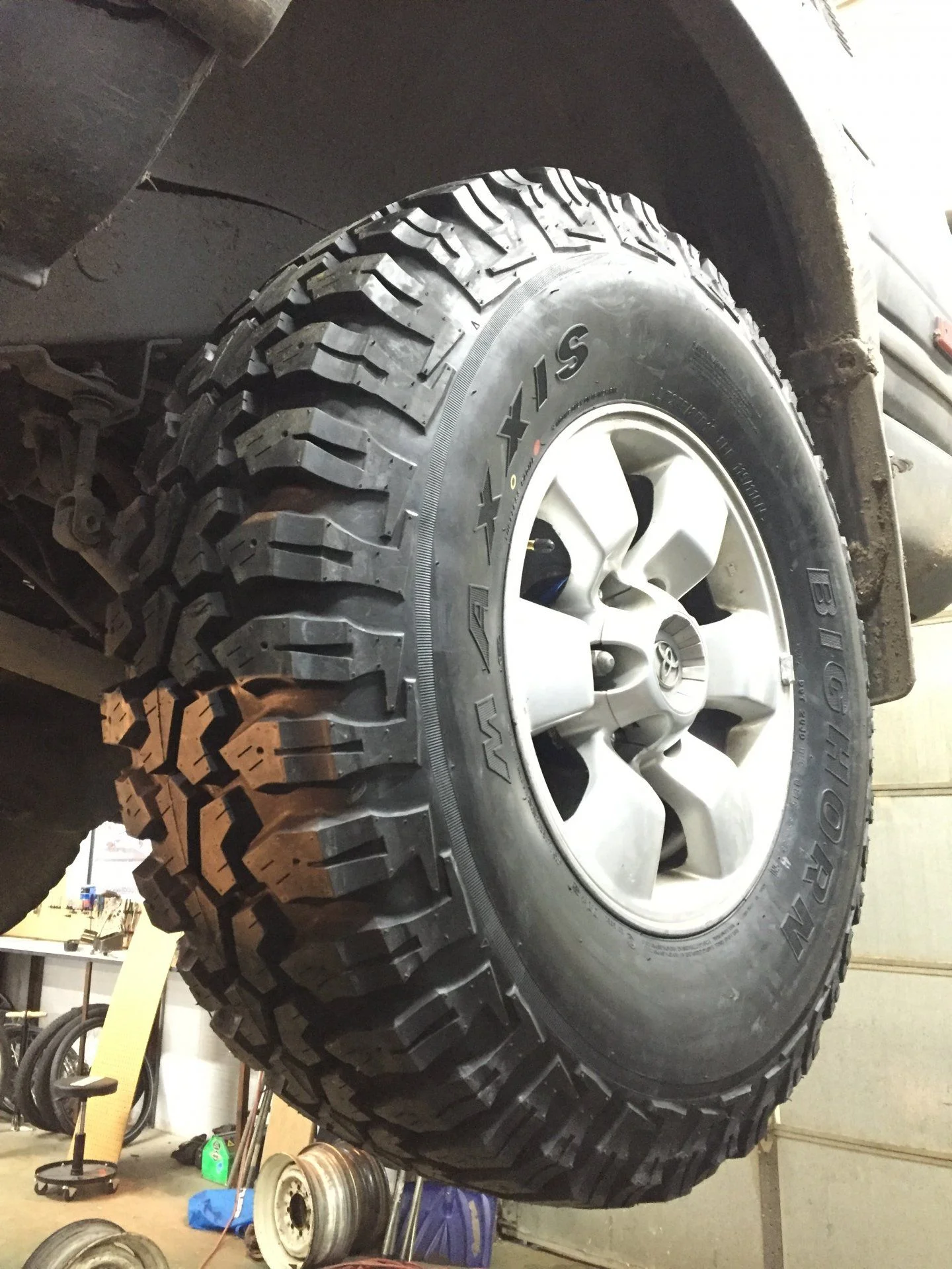

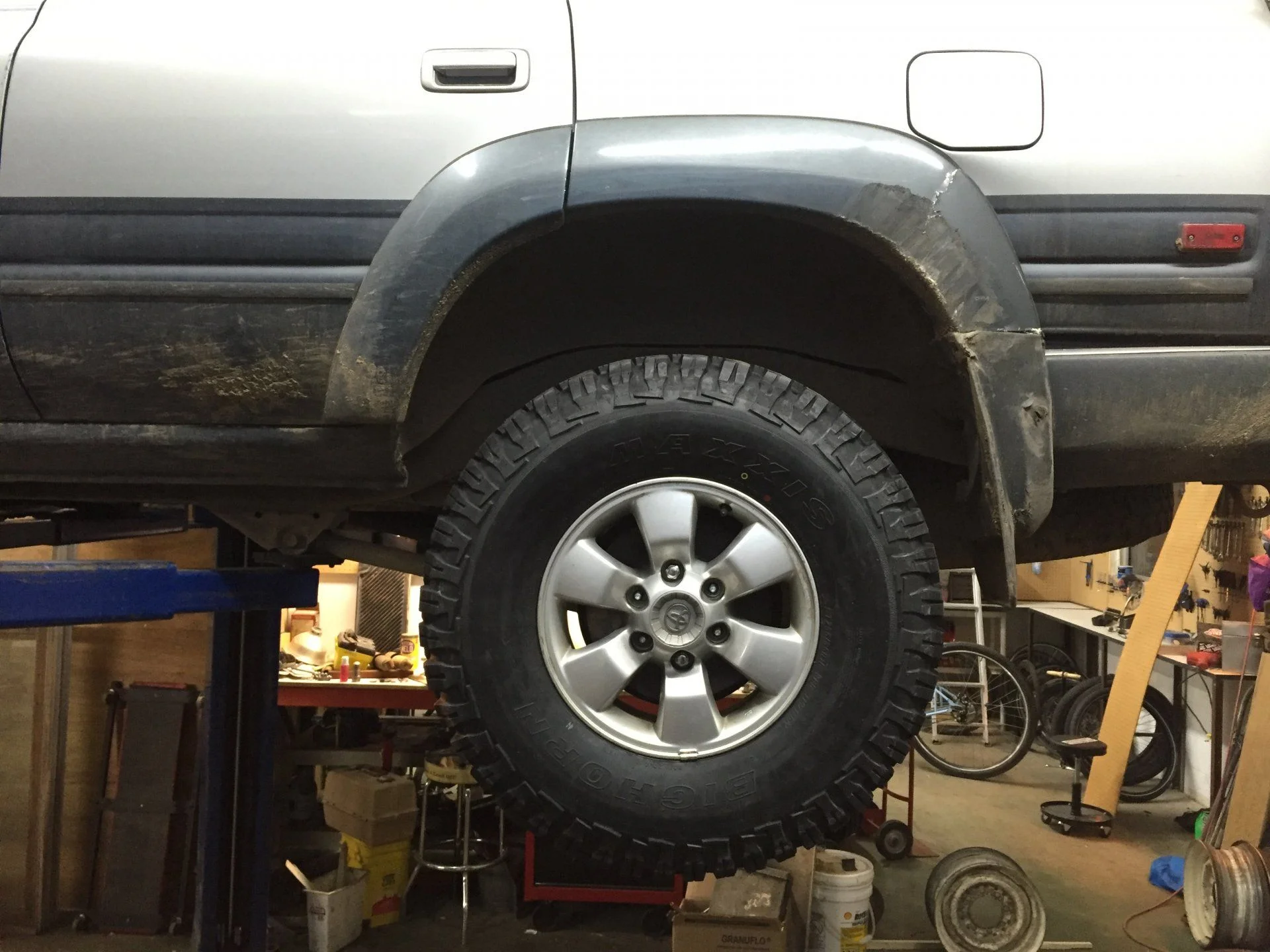

I'm a big fan of the Silver/Charcoal Gray, glad I found one! Ditched the 33x10.50s for some 255/85s a few weeks ago, I'm kinda working backwards on this build thread to try and catch up to where I'm at today.

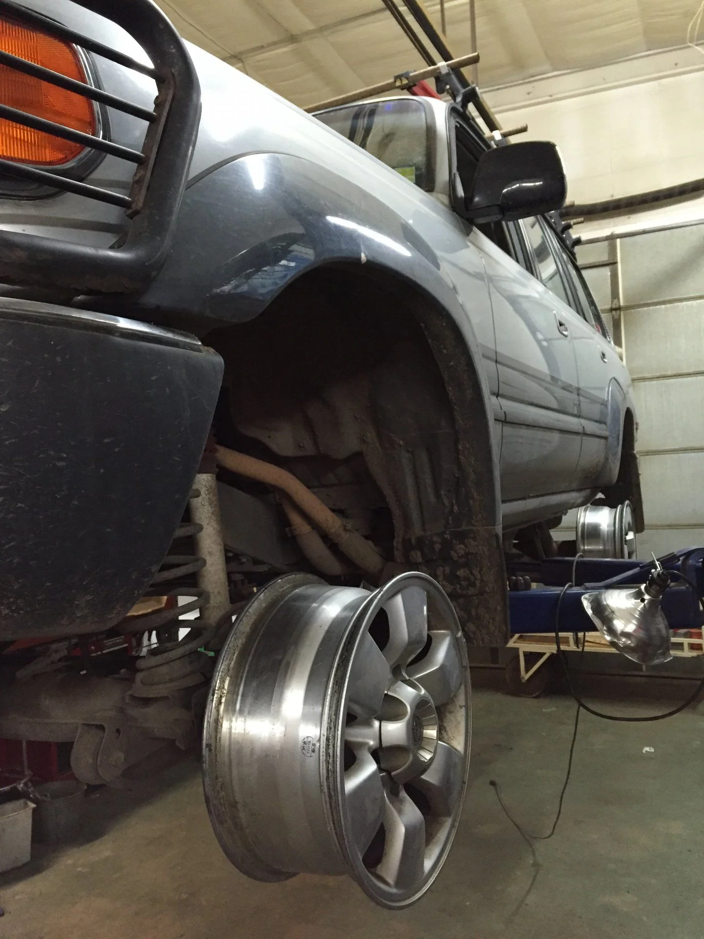

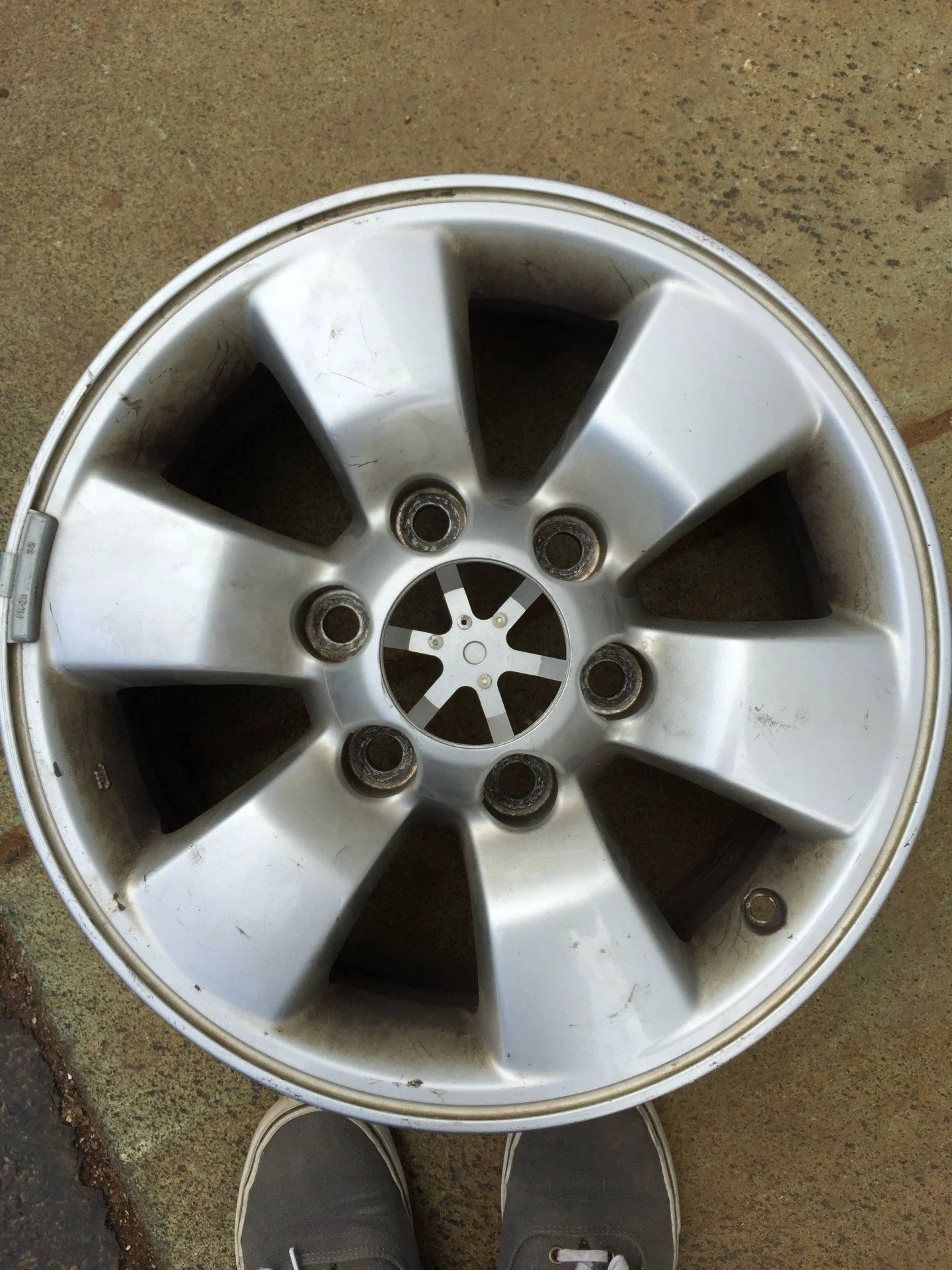

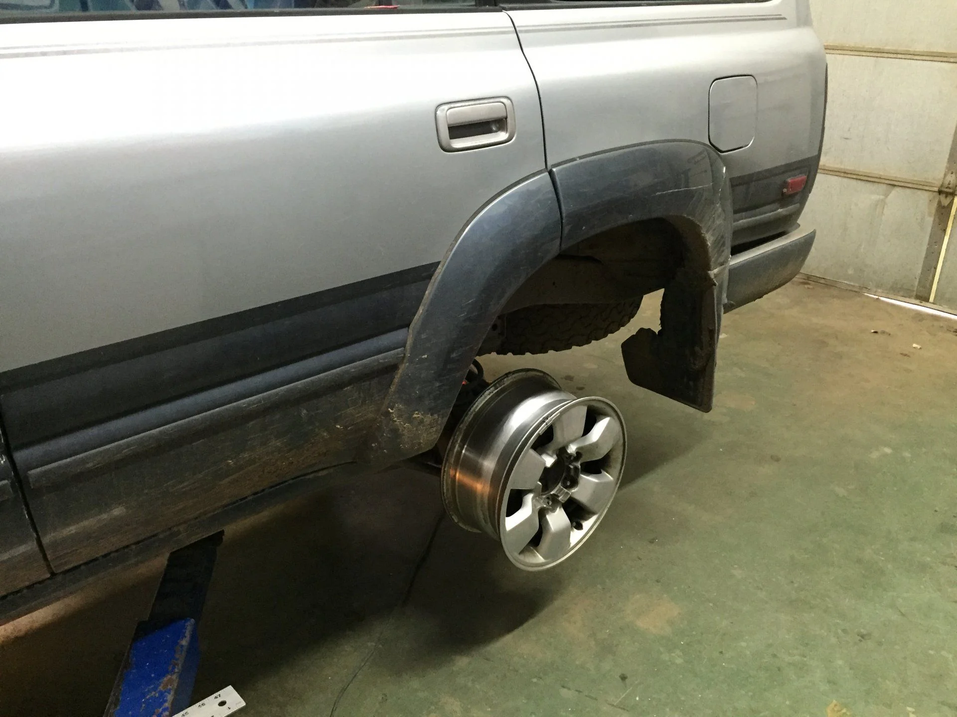

2004 16x7 4Runner wheels, picked these up off CL for $200!

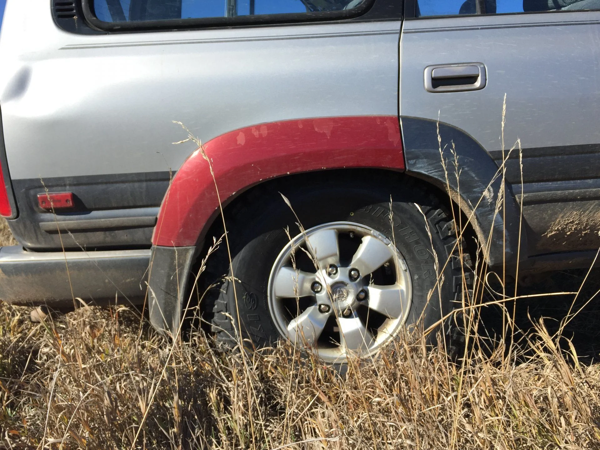

Love the color... IF you are looking for a cheap way to match your red fender flare I sanded and bedlined mine then black bedlined flares and bumper caps.. they look great on this color scheme.. I've seen it on the white 80's and they do look kinda outta place but not on this color..
.. $15 for sandpaper, self etching primer and bed-liner spray... :)
I think I'll be spraying the hood, mirrors, bumpers, and repairing some scratches at the same time, so I'll use base/clear. I have a serious problem with taking things too far...

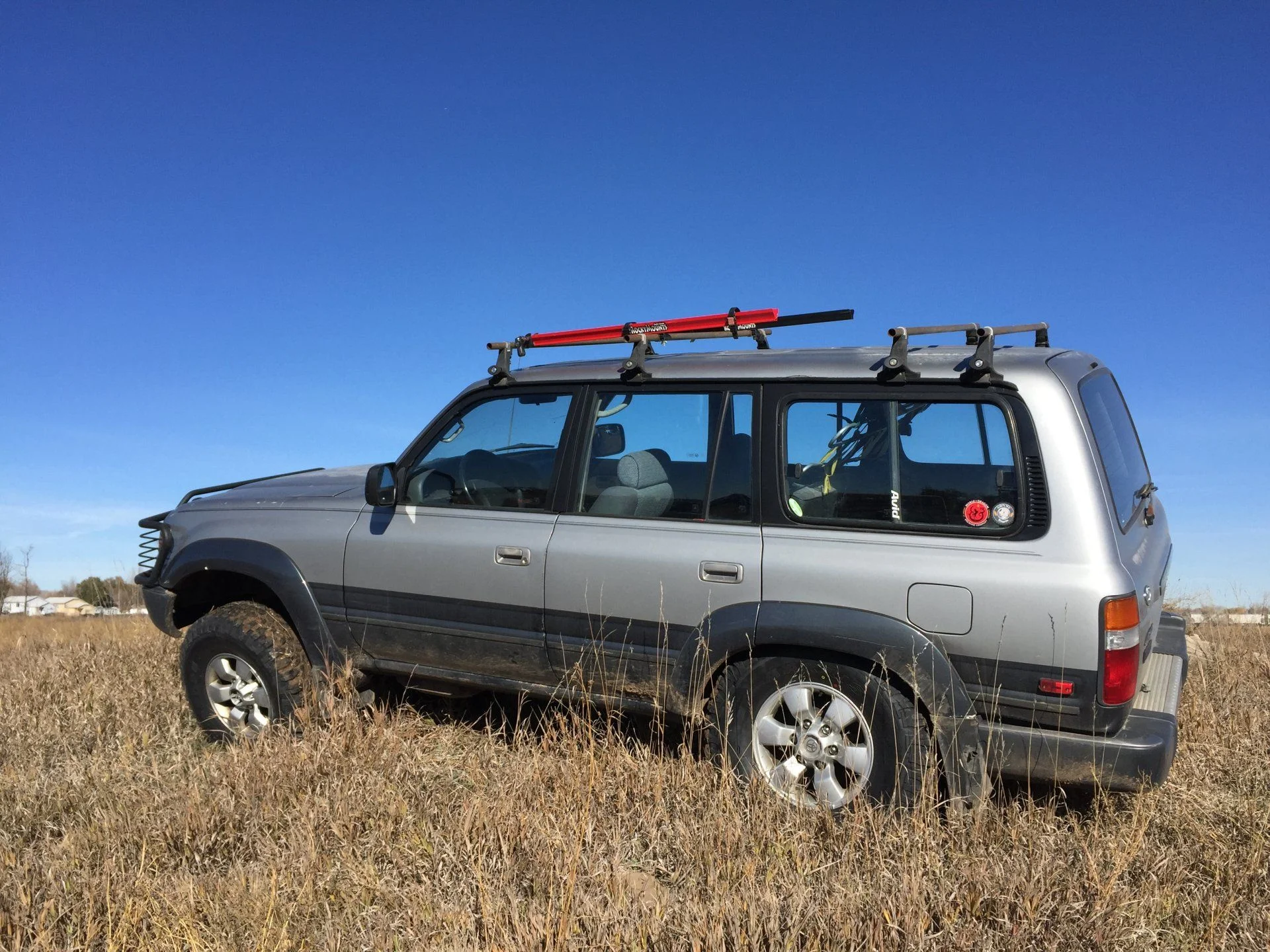

Finishing up the drawings for my roof rack, throwing the parts in with some work we're doing for another brewery. Waterjet cut 1/4" aluminum for the sides and front, 1-1/8" x 0.049" wall 4130 chromoly for the crossbars, 3/4" x 0.049" 4130 for the runners, and 8x Yakima 1A towers to hold it all in place.
Only thing left to do is add some 6mm holes for mounting lights and other accessories,
I *really* like that roof rack.
Thanks, want one? Haven't built it yet, wanted to use the Cruiser for the summer, get some miles under it before I got carried away building stuff for it. I've decided to make a low basket in the rear, while keeping the crossbars even from fr-bk for carrying steel tubing, lumber, and paddle boards.
I actually might, money's tight right now, but I'll gladly buy one if you start building them in a couple months.
