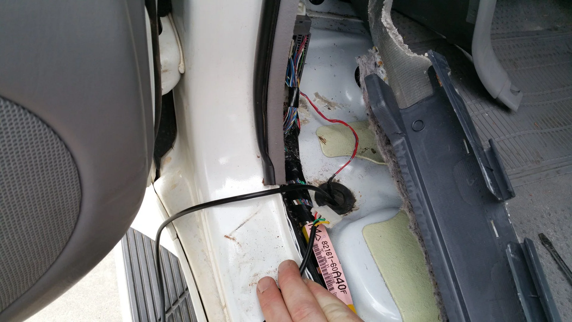

I ordered it a few weeks ago and asked for a 2m plug and play harness. It arrived yesterday so I climbed under my rig to see if I could get it installed. I was going to snake it under the steps (temporary reinstalled for prego wife) in through the door when I noticed a gasket with a wire running through it. After further inspection its the wire that provides power to the lights on the side steps on my LX. I pulled the driver door entry trim, the dead pedal, and the plastic trim that conceals wires next to the dead pedal and pulled up the carpet a little to access the gasket. This is what I saw.
I sliced a hole in the grommet and pushed the molex connector through. I had enough wire space to be able to plug in the yellow box and hold it comfortably in my hand while driving to make the needed adjustments. I buttoned back up the trim pieces (except the dead pedal, couldn't get the tabs lined up) with the wire hanging out the bottom of the vertical plastic. Right now I plan to finish fine tuning the speedo then zip tie up the cable and stash it behind that trim plate next to the dead pedal. It'll be out of the weather and easy enough to access should I need to make further adjustments.
I had kind of thought I'd drill a hole and bring the wire up under the center console but this was a much better solution for me.
