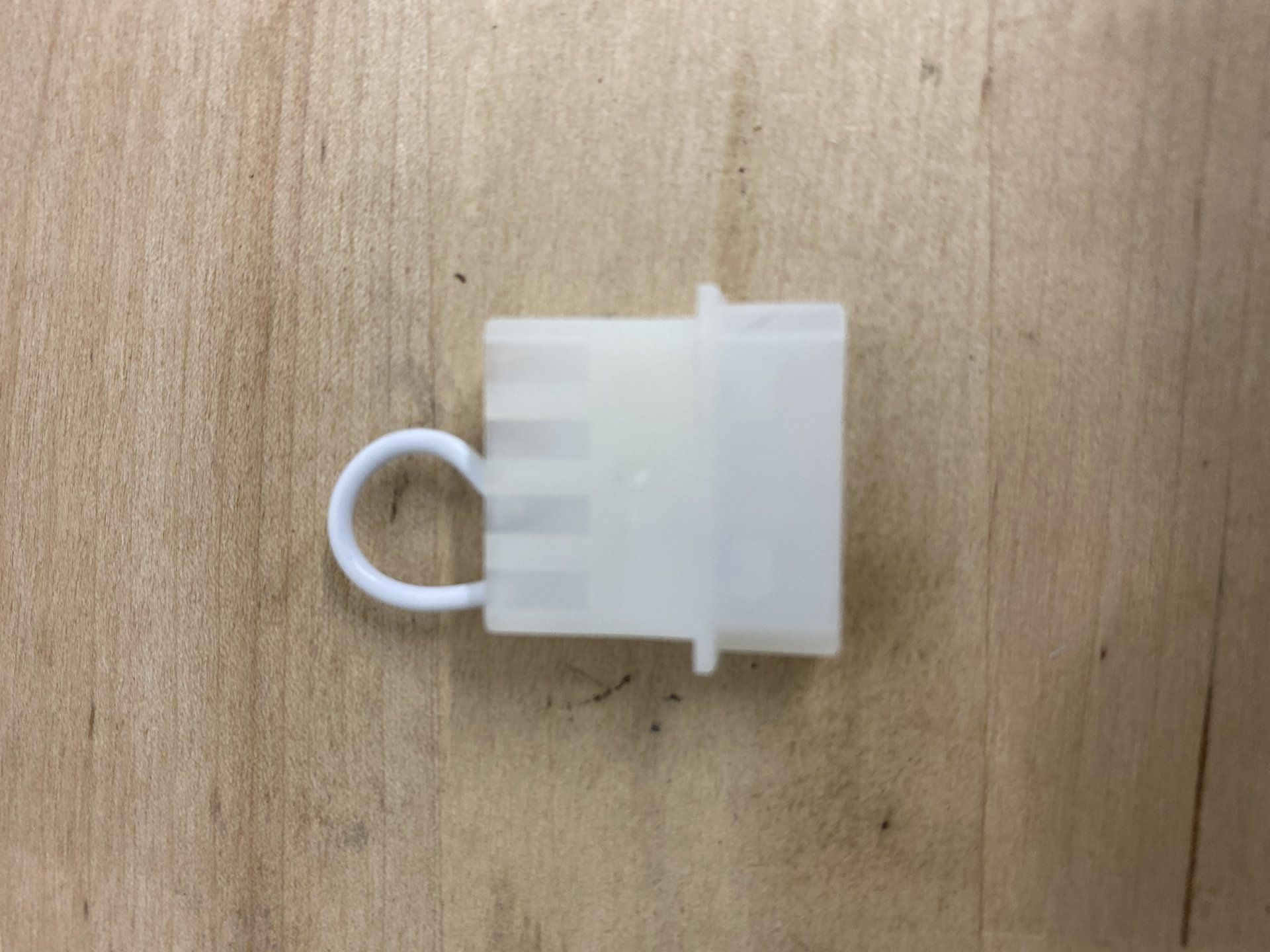

I installed my plug and play Yellow Box in my '99 100 this week, and it's working great. I didn't bother to calculate the offset, but with the +/- pushbuttons it was super easy to dial in. The cable length was perfect to run up through the grommet under the DS floormat and locate the box in the kick panel. I wanted a tight seal in the grommet, so I drilled a hole slightly smaller than the Yellow Box cable housing, pushed the pins out of the connector on the box end using an Amp pin pusher (see pic), and pulled the cable through the grommet hole. I'm slightly ODC, and I didn't want to cut a slit in the grommet.
I also like that the Yellow Box now includes a spare plug with a jumper wire so the Yellow Box can be deleted without having to mess with the cable connections under the truck. Just plug it into the cable end instead of the Yellow Box.

@Eyedaho is this the spare plug with jumper you’re referring to? If so, one just needs to unplug the Yellow box and use this in its place and the speedo is back to factory settings?
Sorry for the slow response. I was guessing that was the case, but I wanted to actually try it to make sure. I plugged that jumper in in place of my Yellowbox tonight on my way to work, and it did in fact bypass the Yellowbox and return my speedometer to factory operation. I'm not sure what the other two wires in that cable are. I'll have check in the EWD when I get a chance, just to satisfy my curiosity.
Awesome to hear! Yeah, mine came with 2 of those jumpers and an extra length of cable with splice ready ends.

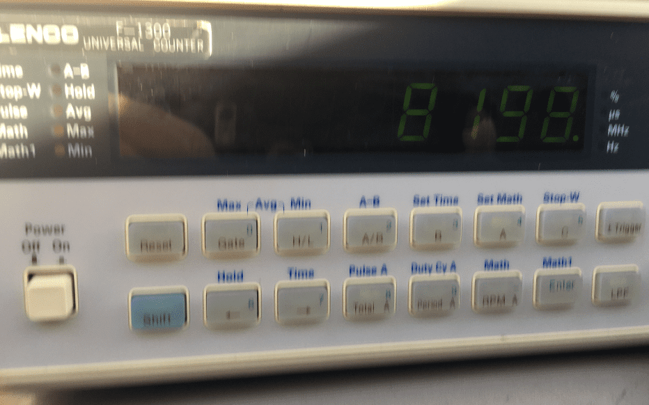

So I've ordered one of these and will install it in the next week here. In preparation to install it I've studied the signals from the speed sensor and confirmed couple things I've not found documented elsewhere here on IH8Mud... Hopefully others will find it useful.
  1. The number of pulses per mile (PPM) from my '97 80 series LC - For this I put the truck up on jack stands and ran the truck for two miles as indicated on the odometer trip meter and recorded a total of 8198 pulses for an average of about 4100 pulses per mile as measured with a Universal Counter.
  2. The nature of the signal into the speedometer as viewed with an oscilloscope - A very clean square wave 11.5V signal with a period of approximately 60mS at an indicated speedometer speed of about 15mph.
