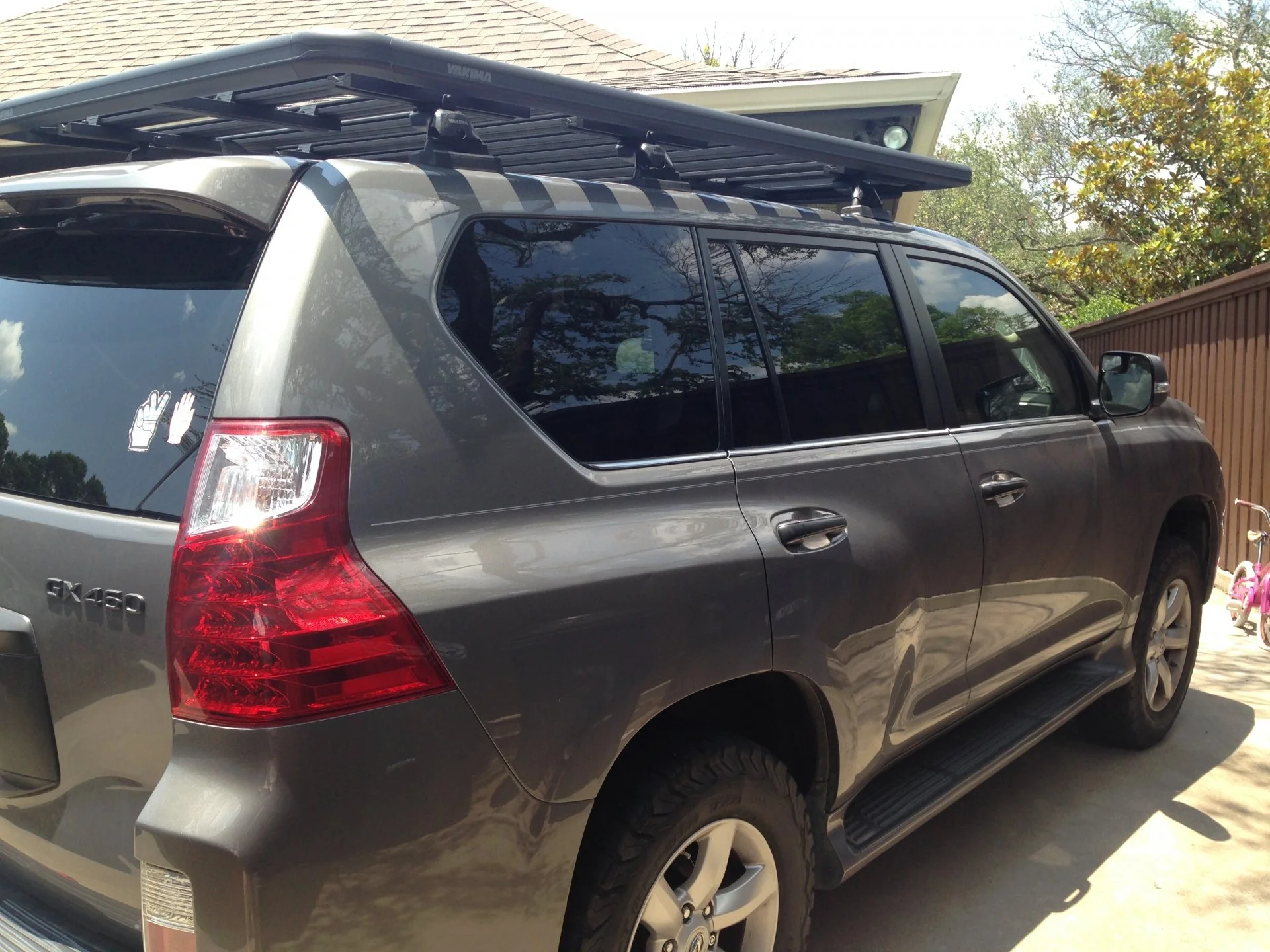

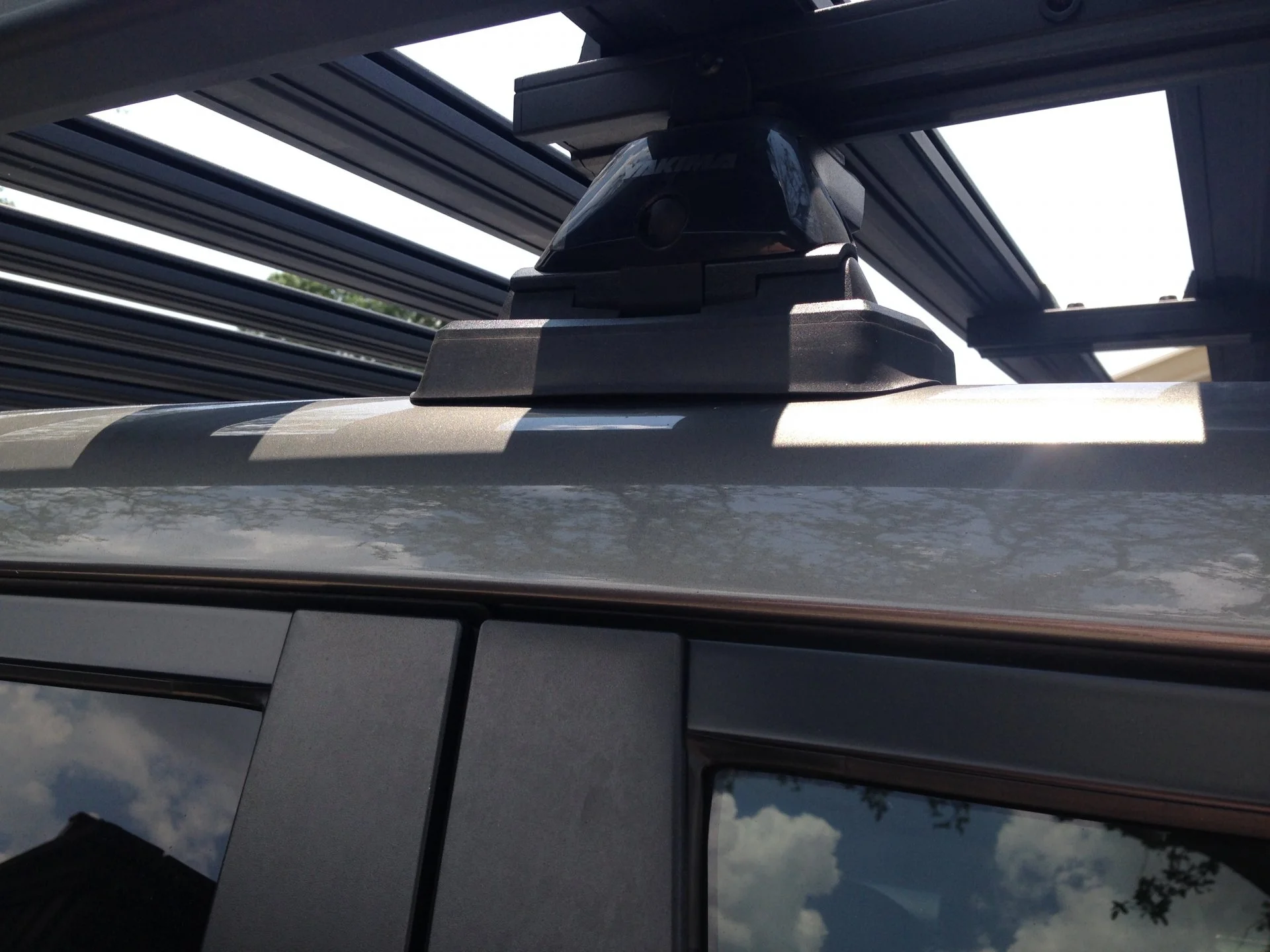

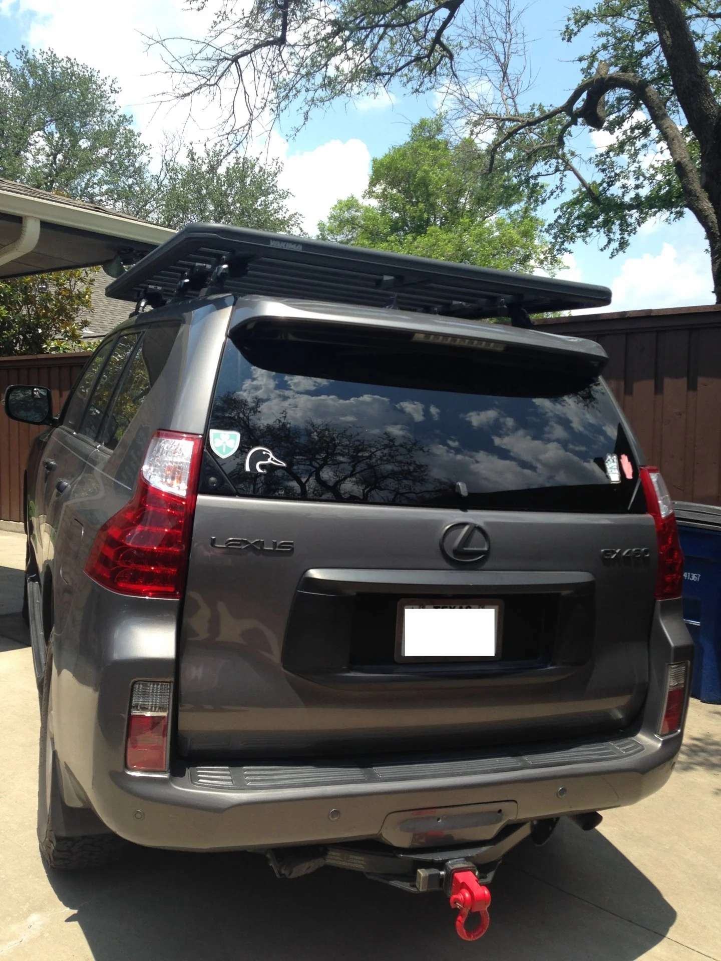

Hey gang, I wanted to come back with some pics of the new Yakima / Toyota specific install for their Lock N Load platforms. This is from a tester I know who was part of their GX group. The pics give a good representation of the install and also have been tested and approved by the teams at both Toyota and Yakima, not to beat a dead horse...
I also got word that the two landing pad kits for this fit are now up for sale on the Yakima website or through your local dealer. If you have a 5th Gen 4Runner you would want Landing Pad 29 and if you have a GX460 you want Landing Pad 30. The web page for the LP30 doesn't seem to be up, but I'll check back on it. I also attached a PDF of the details from their dealer workbook page on these two little buddies.
For those of you with other Toyota/Lexus SUV's other than the Gen 5 T4R or the GX460 (such as the LX's, 80-series, sequoias, older T4R's etc) I have a request in with the fit team at Yakima to find out if these could be crossed over to fit on those models. Theoretically it seems possible, but they may not have tested those fits yet.

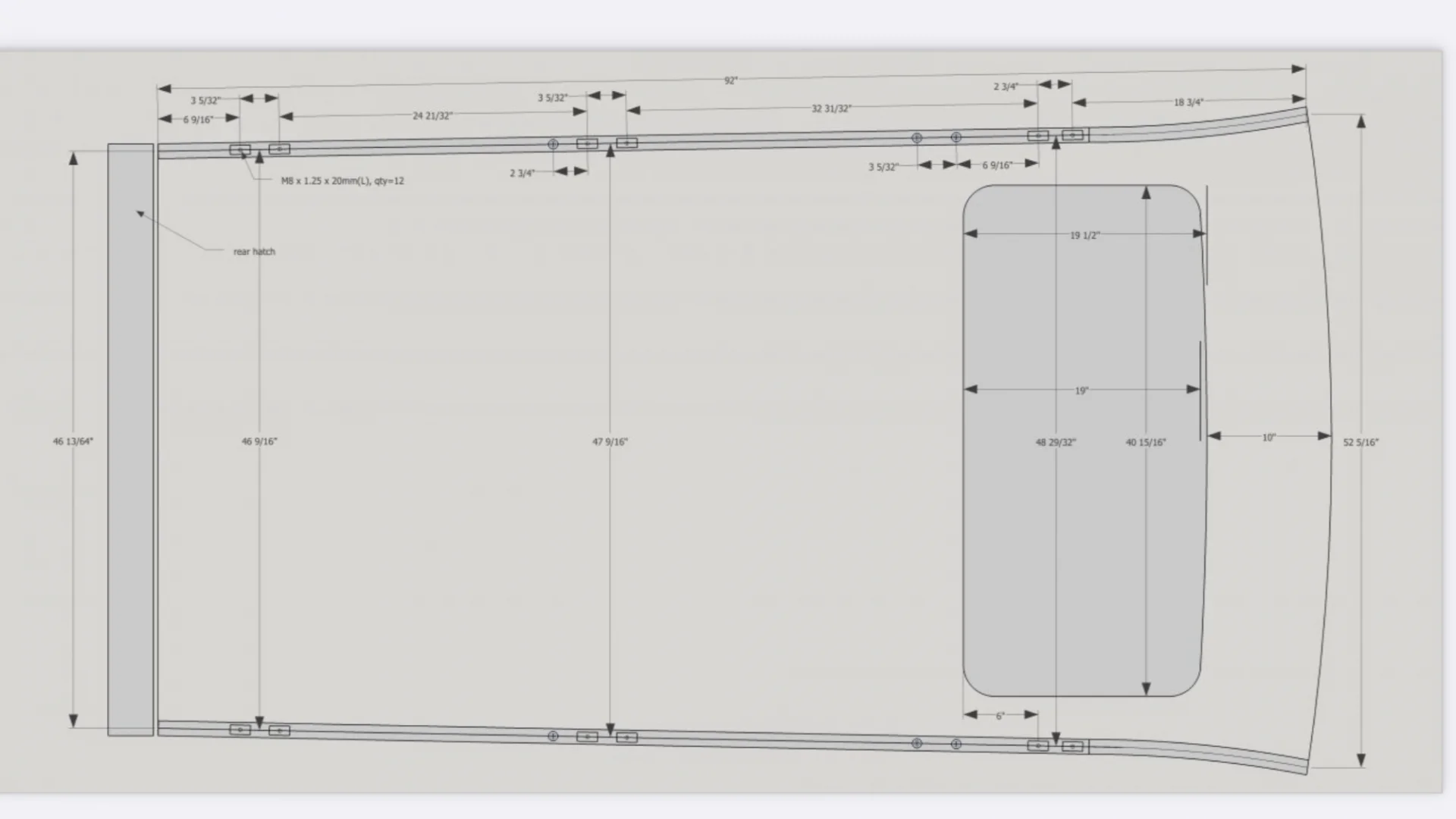

I appreciate the quick response, just let your buddy in Oregon know the factory 100 series rack is a 6 feet mount on the early years with the very front mount having a narrower set of bolt holes however the Lexus model vehicles only ever used four sets of feet and the distance between those bolt holes is the same.
This little diagram has been floating around (not mine) a while and could come in handy, the later years of the 100 series indeed used four feet but underneath the molding both the 100 series and the LX 470 have four sets of mounting holes per side the front most set near the sunroof glass is narrower. The bolts in the very center technically the middle set has three bolts and not just two.
That's stellar info! Thank you for that and for the chart. I've got to think that would come in super handy and I just passed it along now. You rock!

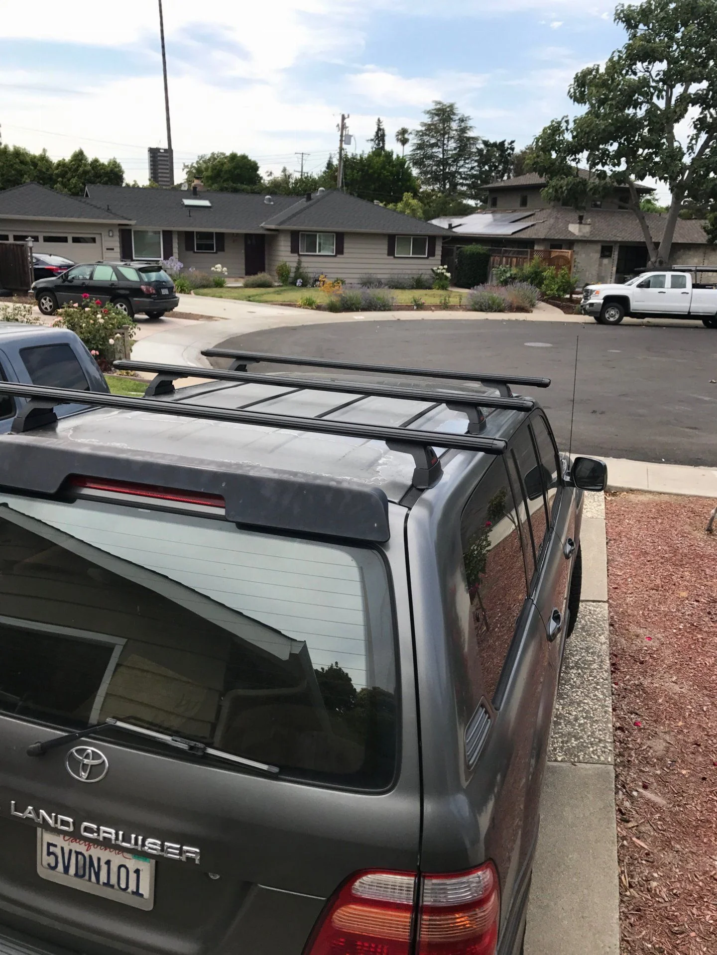

Hey guys,

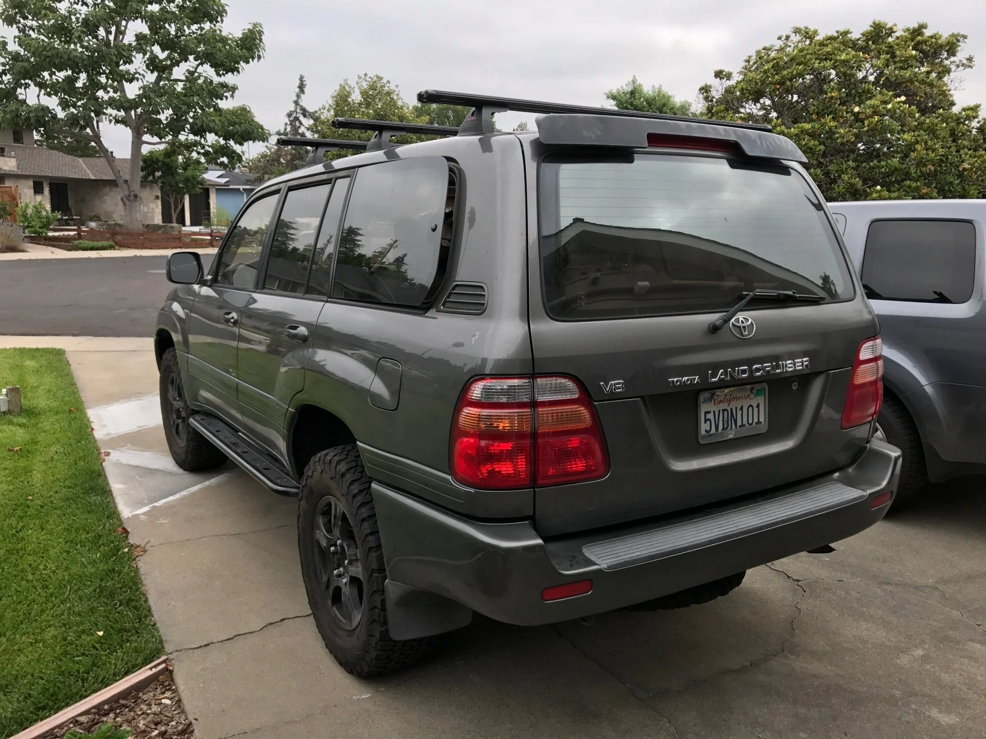

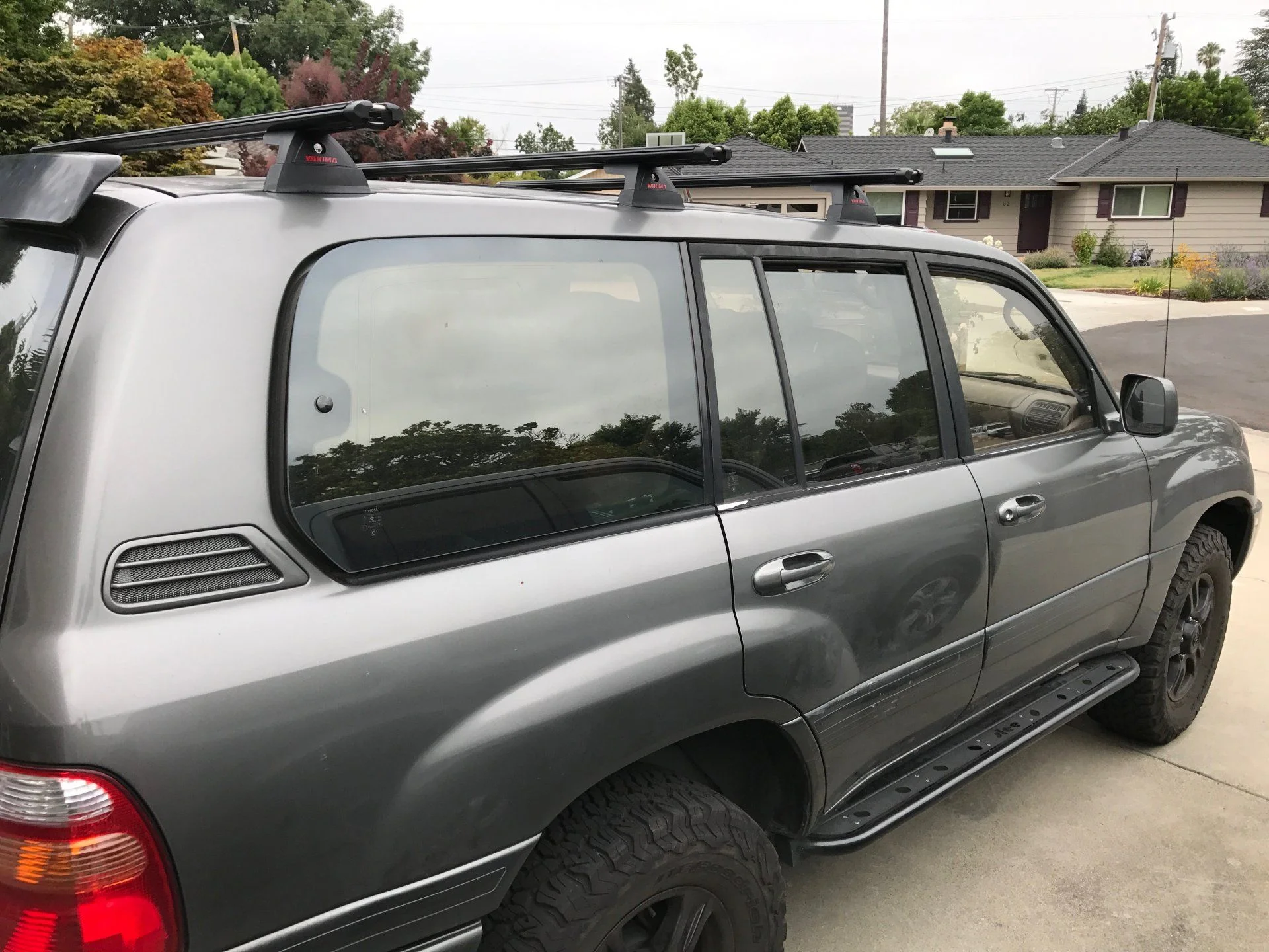

I have been hitting up a bunch of different threads and finally pulled the trigger on a tip by @87warrior and got the Lock n Load | Yakima roof rack.
Apparently Yakima/Thule don't sell fixed point racks for the 100 Series in the US, and I needed to get bars rather than a platform rack, so Rhino Rack was the only available option. Didn't love how the Rhino kit looked up close, and I have Yakima accessories and like their stuff, so I wanted to go with these. If you're in the same boat, hope you find this useful.
This kit sells in Australia and New Zealand only. Not all of their online sites offer shipping to the US, but this site said they would do it: roofrack.com.au. Total cost was around $620, including expedited shipping, it got here in 3 days.
There was a random glitch - the kit they sent me was packaged incorrectly at the factory. There are supposed to be 6 unique pieces in the kit, but the one they sent me had two front adapters, and was missing a middle one. First time in 20+ years of modding cars that something like this happened. Maybe some Australian dude had too much Fosters the night before and packaged the kit wrong. I wrote an email to the vendor and to Yakima Australia's help line. Yakima Australia ended up taking care of it, the support guy I was emailing with went to a shop down the street, grabbed the right part, and drop shipped it to me. Dude went above and beyond and helped me sort stuff out when the package was stuck in customs. All he asked for in return was to take a picture of the truck with the rack in front of some famous US landmark. Pretty good way to promote customer loyalty if you ask me :beer:

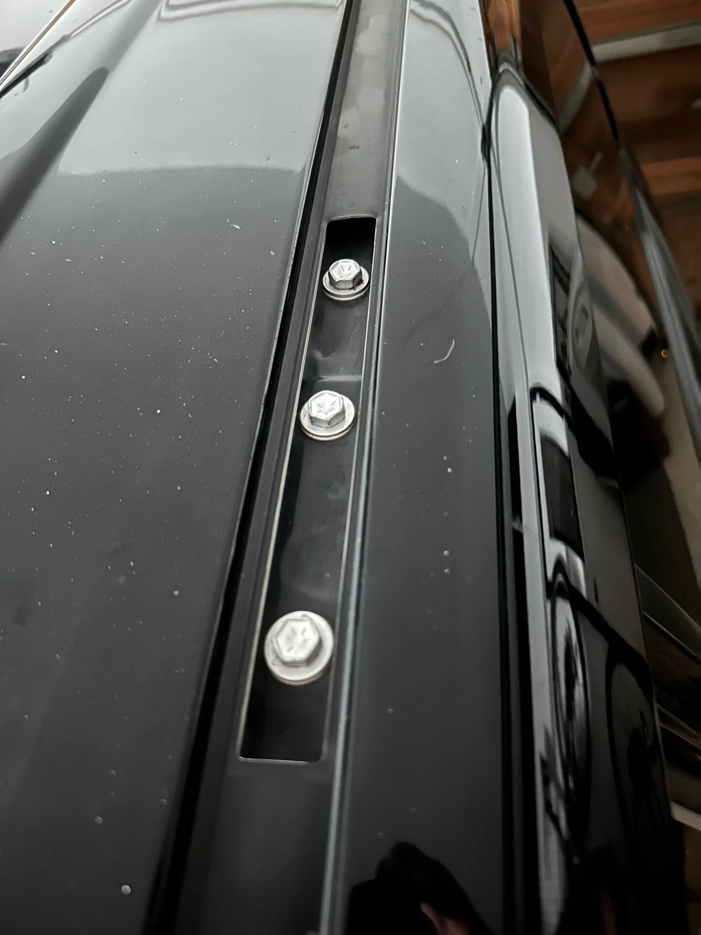

Once I had the right part, the install was quick thanks to the many threads on this site - you guys rock! Factory rack removal was a breeze with all the instructions on here. This kit is three bars across, bolts into the B, C and D mount points, and produces a level plane across the three bars so can use for RTT, etc. There is also a platform option that attaches to the same feet. The feet/adapters bolt into the roof mounting points and the bars attached to these. My factory rack was mounted to A,C,D mounting points, so I had to cover up the A mount with the P/N (75557-60010) cover, and cut out a new hole in the gutter cover with a Dremel tool (spent a lot of cut off wheels cutting this out).
The kit comes with foam pads that stick onto the bottoms of the adapter feet to keep the water out. I still dabbed silicone into all of the mount holes for extra insurance to prevent leaks. Overall looks good and super well made, like all other Yakima stuff. Bonus part, the ends of the bars have bottle openers in them. Seriously. I didn't take any pics that show these, but will take some tomorrow.
Special thanks to @ga89hoss @geanes @azzaLX for answering a bunch of my n00b questions :grinpimp:
Here are some pics.

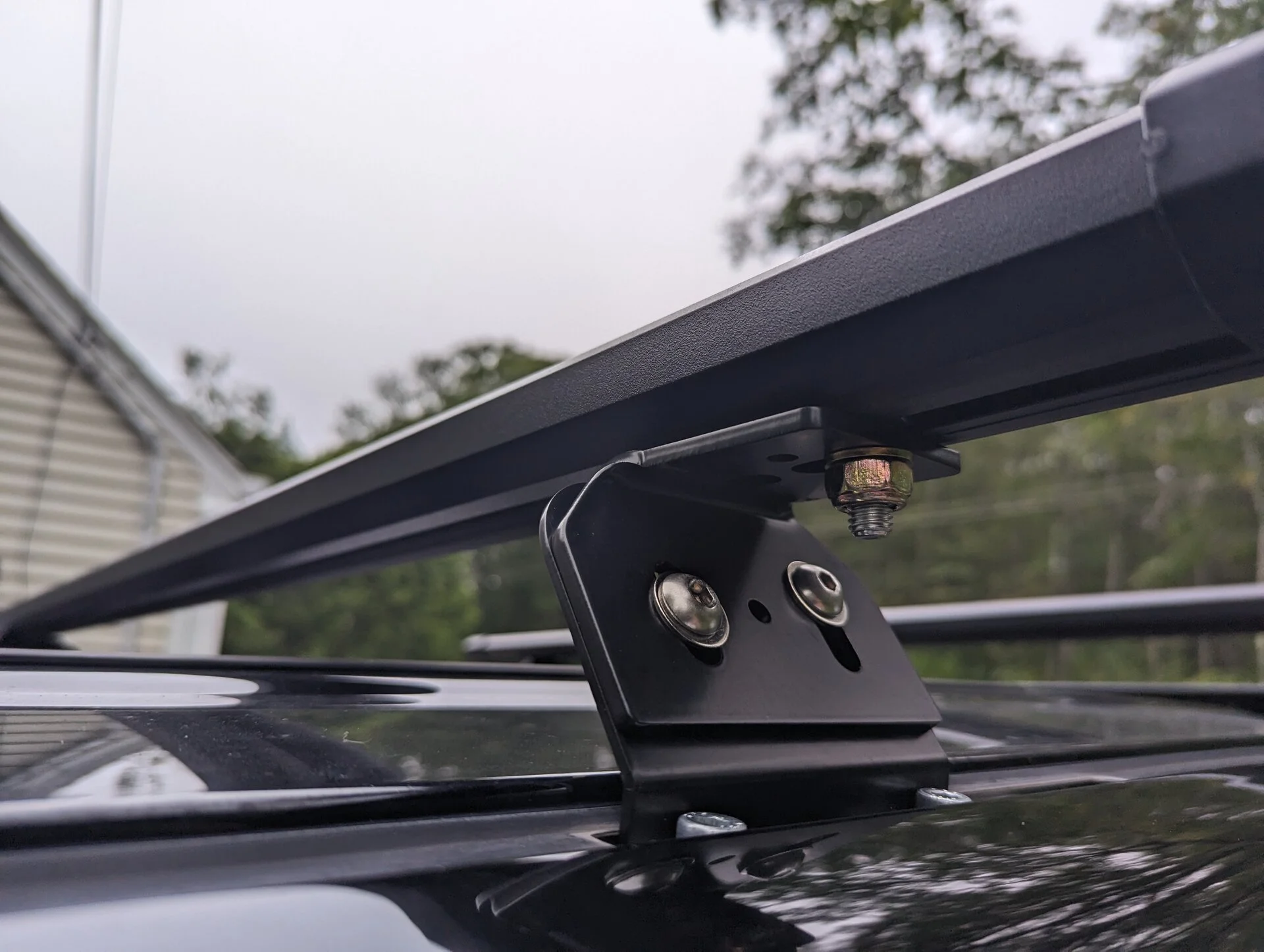

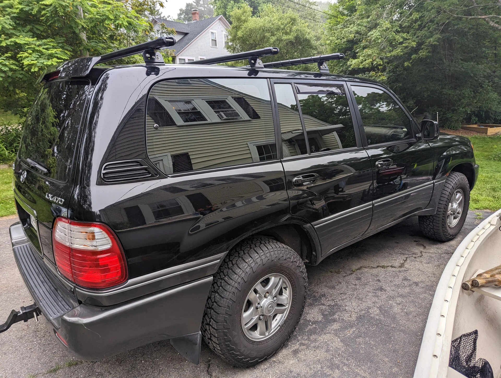

Reviving an old thread. This is a great setup. I am interested in these bars + Gamviti brackets. Specifically these bars because they are 59in vs other brands are 54in. And specifically Gamviti brackets because they are full metal. Seems like the best of both worlds. Has anyone else done this? How did you attach? Any other alternatives?
My yakima bars came with their own proprietary mounts that attach to the factory holes in the roof.
I will add to my post by sharing my results with noise control. The racks were very loud out of the gate.
Firstly, I drove the car up to 75mph and took my time to get there so I could pick up what was happening at what speed. For me, I picked up a low tone pulsing sound from the racks at 35mph. This continued all the way up to 75mph.
I first wrapped 1/4" cord 6x around the front bar. This helped a bit, but the sound was still there. I then wrap it 6x more times...FIXED!
Though once the pulse sound went away I picked up a whistling sound from 30-45mph only. This was solved by installing Yakima HD crossbars rubber strip on the bottom of the bars...FIXED!
Hope this helps anyone that wants to install these!
awesome custom solution - great work! especially love the fix for the noise - what gave you the idea that wrapping the cord like that would silence the noise?

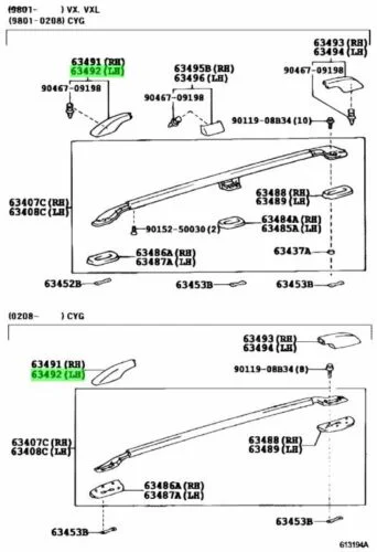

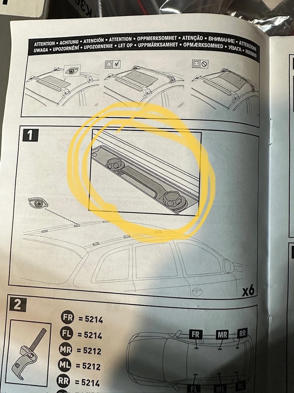

I have run into an issue with the Yakima rack and I am hoping someone can shed some light:
@alpinecowboy
@digitalmarker
I see these hoops mentioned in the roof rack instructions- I don't see them in my kit or on my truck. Am I missing something?
I am thinking they are 63452b and 63453b.
Thanks!
