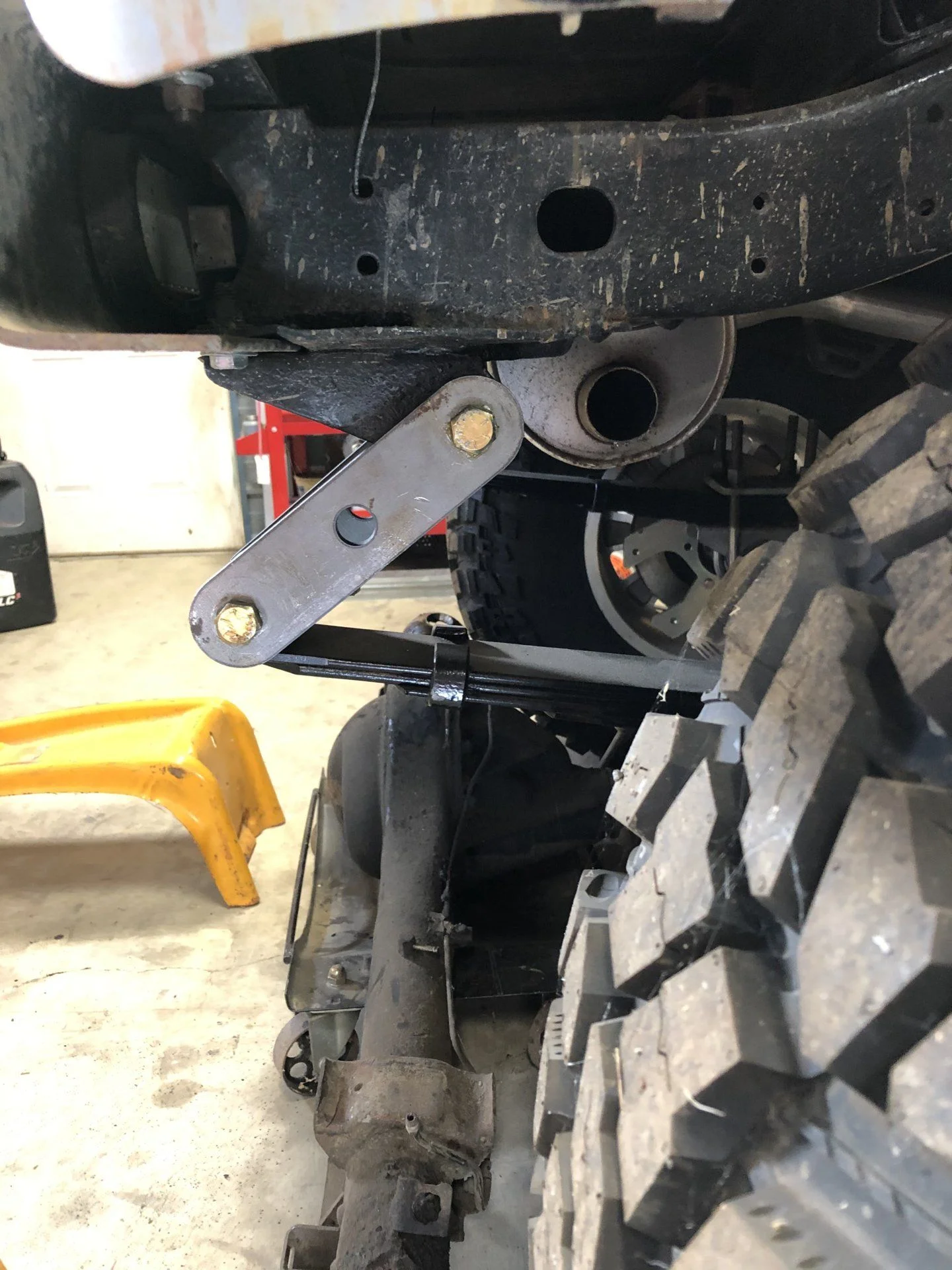

Here’s one of ours. 55’ rear springs with 6” shackle; hanger in stock location. I’m gonna flip it. 37s. Haven’t driven it because I’m still getting everything setup.
