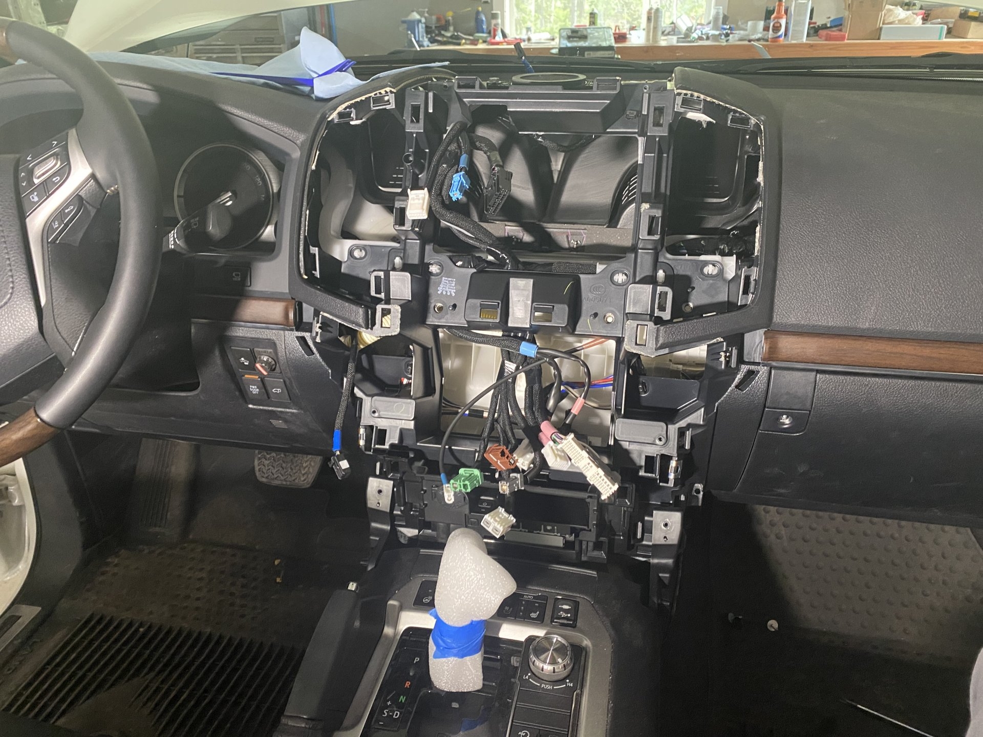

After quite a few issues with the Naviplus unit, I tore the dash apart again and replaced the Naviplus with an EC Offroad unit. I also installed a 12volt Solutions remote start which was super easy.
The EC offroad is a lot more reliable. The only issue really is when you remote start the vehicle it can't find your phone. So you have to manually pair. Otherwise it pairs up every time and starts playing music where you left off. I should say I do not use any of the toyota navigation, sirius, am/fm etc. I'm nearly always on carplay with spotify for music and google maps for navigation - for that it works great.
