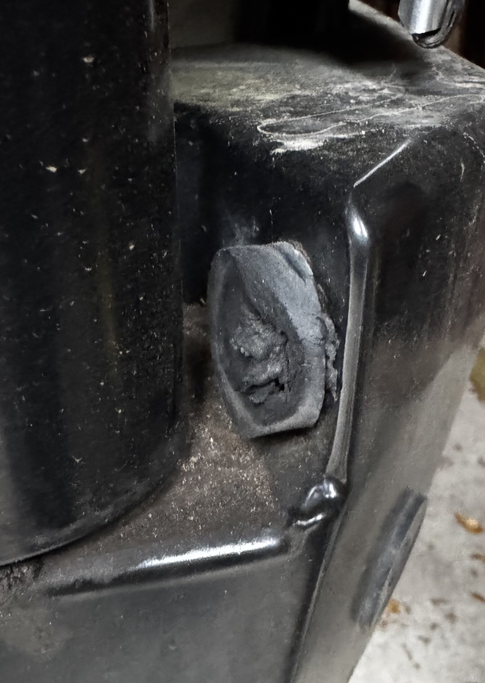

A warning to fellow @sleeoffroad rear bumper owners for the 200. Don't make the same mistake I did. Sometimes I cause my own problems.
Slee makes an awesome product but regular inspection of your bumper components is worthwhile. I didn't realize my rubber bumper for my spare tire swing out has deteriorated over time. Surprisingly, the arm has bent where it makes contact when opened. So if you see any wear in your rubber bumpers, get a replacement on there asap. I ordered some from Slee, will have to touch up my bumper finish now. Unfortunately I don't think I can fix the bend in the steel without disassembling the arm. FWIW POR15 Chassis black seems like a pretty good match the bumper finish on this and my arb front bumper.

If you read a bit earlier in the thread this is maybe my own doing. My 200 has seen some trail time and I know there have been off camber situations where the spare tire swing arm has slipped out of my hand and hit that bumper with force. Apparently that is not good for the longevity of the rubber. I wouldn’t say that has happened a lot, but definitely something I will try to avoid as much as possible. I didn’t hear metal on metal contact, just noticed the issue one day. I changed it without having to dismantle anything. I used a pair of narrow channel locks and a piece of rubber sheet to protect the surrounding parts. Was a couple minute replacement job. I touched up the bumper and it all looks fine. Embarrassing I cause the issue myself, but it won’t be the last time I cause my own issues.😂

See below for what my rubber stopper looks like after about 4 years. It’s not quite done yet, but looks like I’m due to replace it now.
Yeah that looks about like mine does/did. I have a 34” spare, so not massive but it is a heavy arm. The bumper is so solidly built I hadn’t considered that slight damage being an issue so I am sure I was careless at times.
That rubber bumper has a threaded insert inside it. So I used some channel locks and a thin piece of rubber sheet I had to protect the swing arm end surface and the surface where the rubber bumper mounts from scratching as I removed it. My bolt stayed put and I just twisted the new rubber bumper on it.
Oh, and yes that link was correct.
