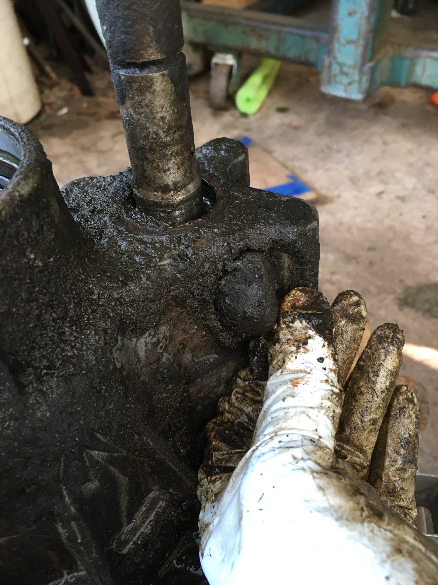

Oh yeah and at one point I was using a paint scraper to get the thick globs of grease off and this thing plopped off.... apparently a rock, good sized, had glued itself to the side of the output end of the tcase!

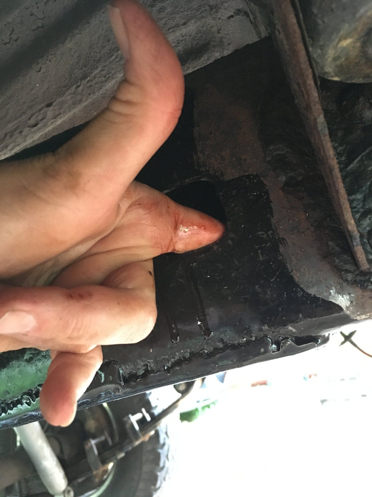

As a smaller sized person I have to get creative to stay safe.... I needed to get the crossmember off so here’s how I kept it from rolling while I used the impact wrench.

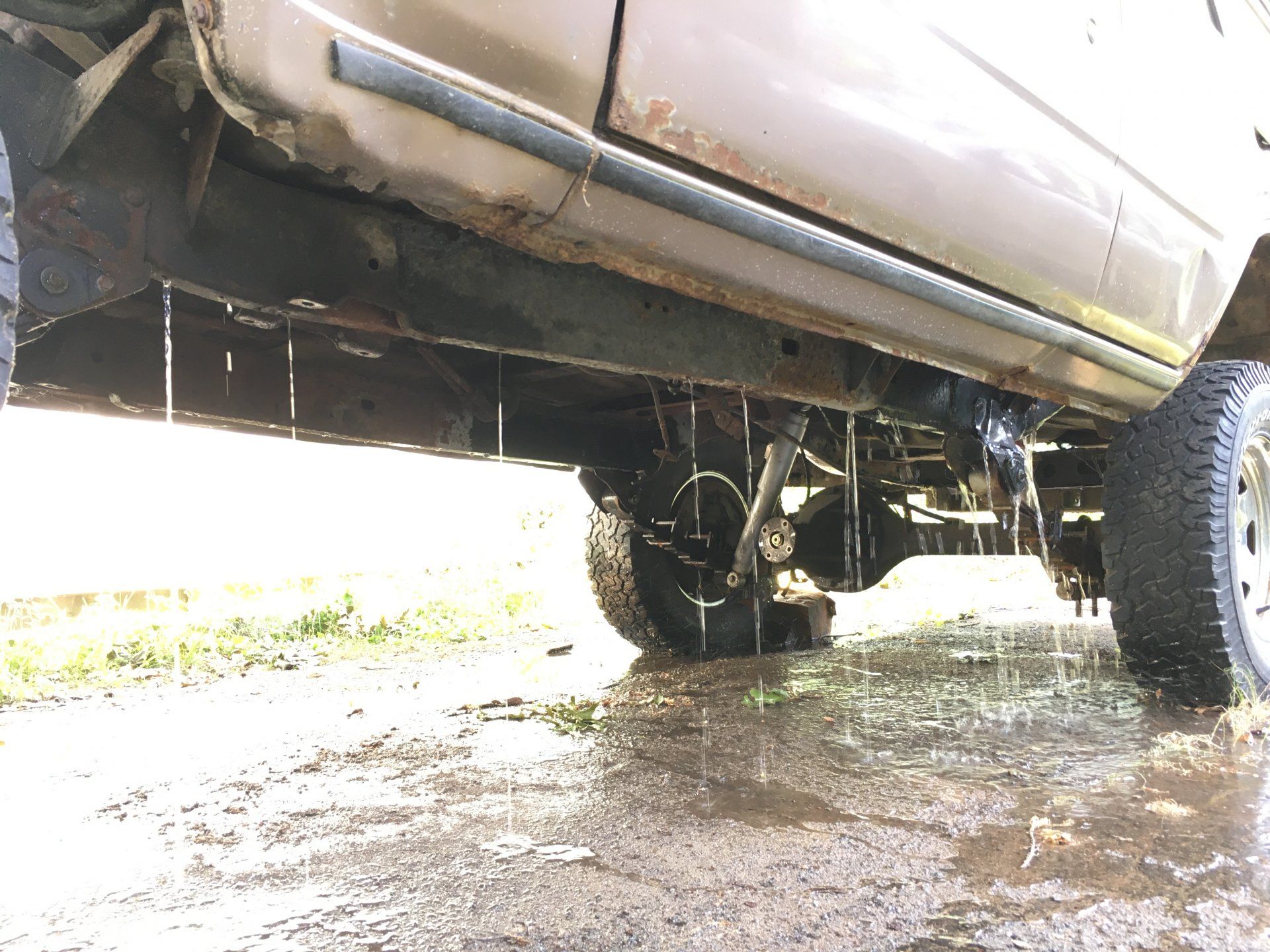

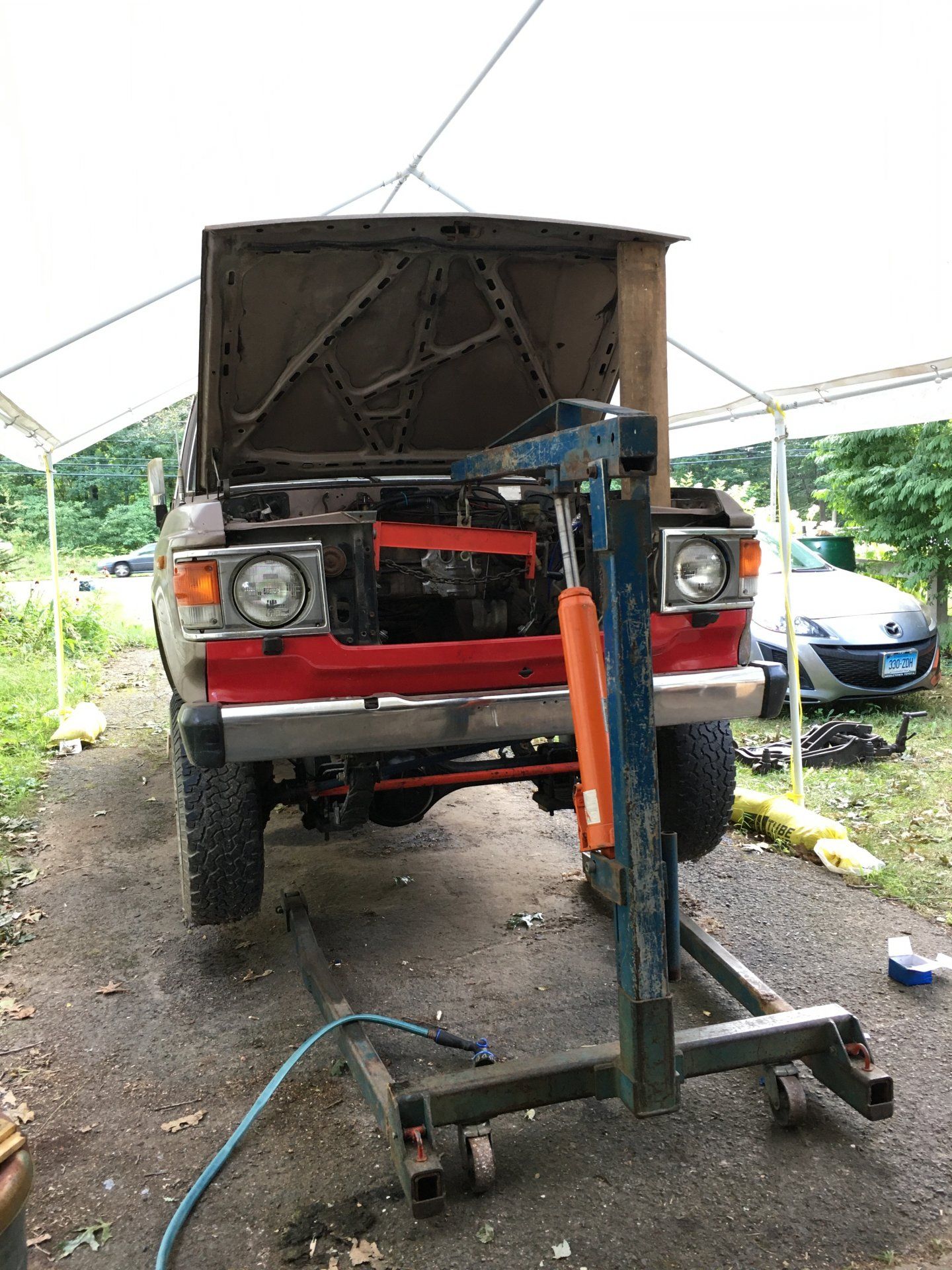

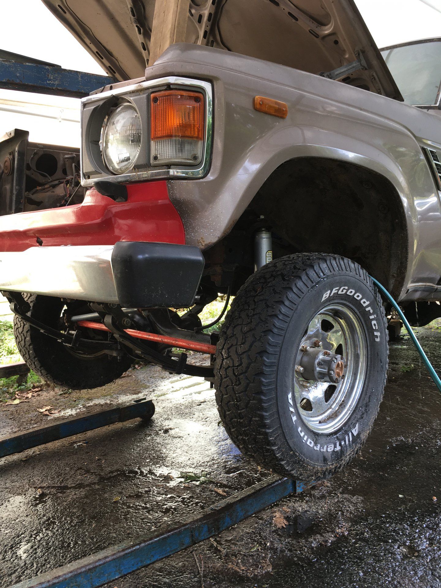

Up and at ‘em! Used an plumbing auger to rough up and clean out as much of the built of years of wheeling mud/silt etc w/ the hose. As much as I hate that hoist, it’s a mighty strong one.

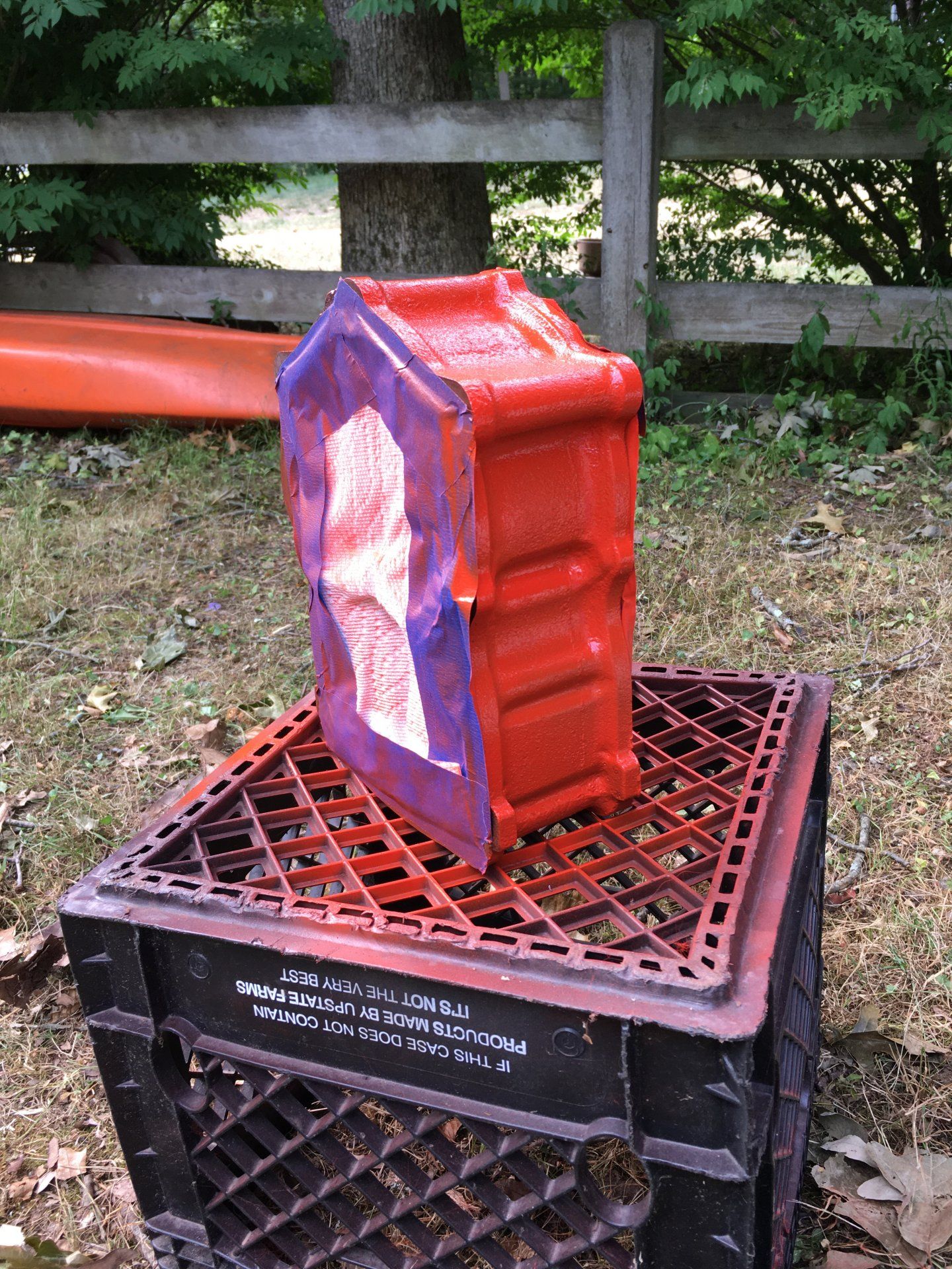

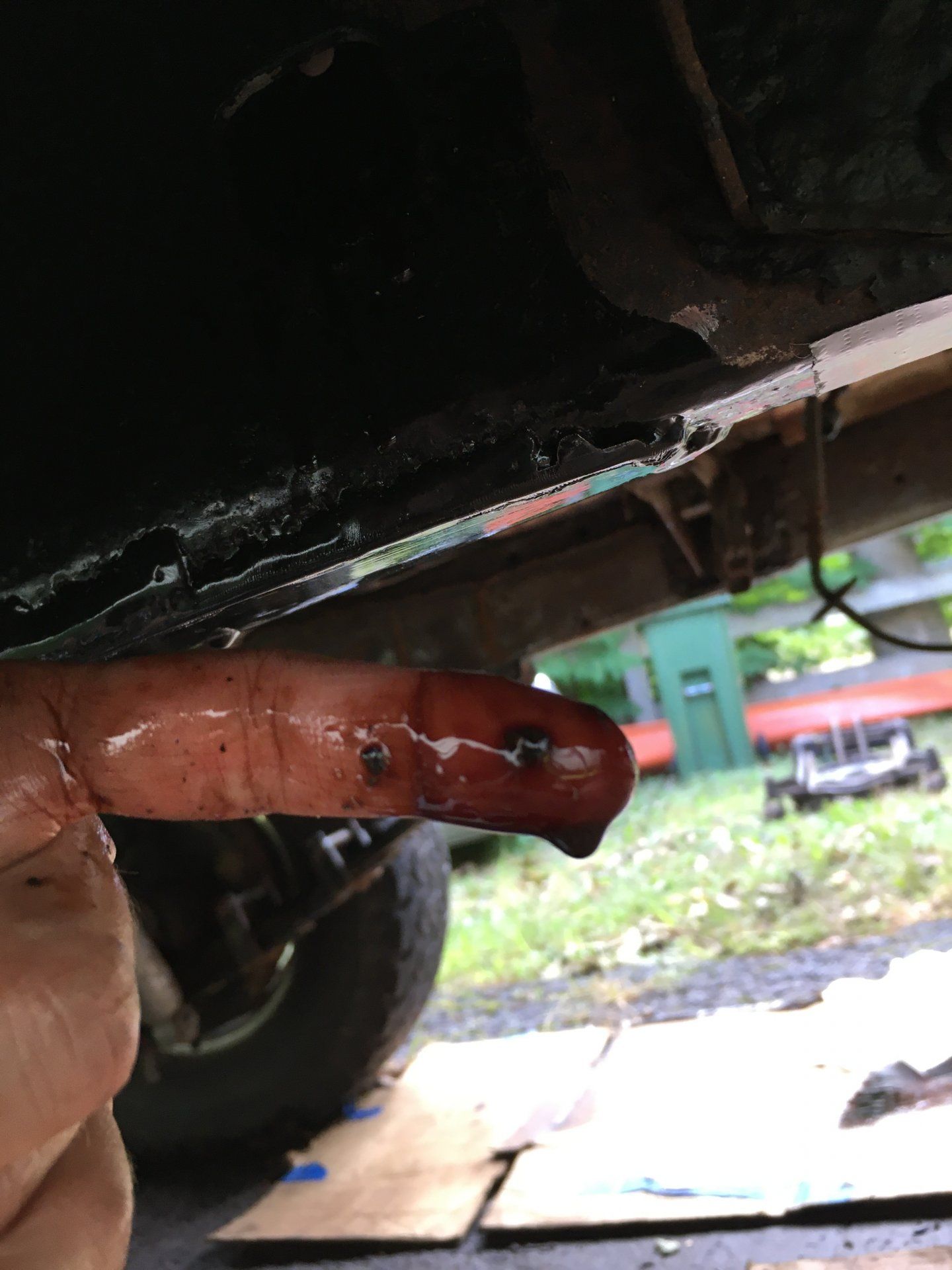

Cheap rust prevention.

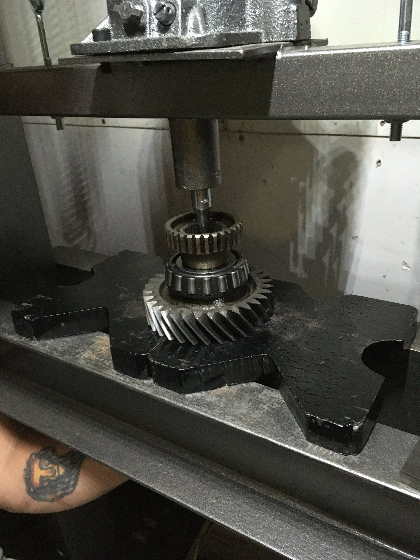

And now the tcase is apart thanks to my friendly neighborhood powder coater, Rob who has a sweet 20 ton HF manual press. Will clean and then assemble at some point this week.

Is that used oil or Liquid Film?
Plus I imagine fluid film is clear being that it’s derived from lanolin. Not ugly burnt old oil brown.

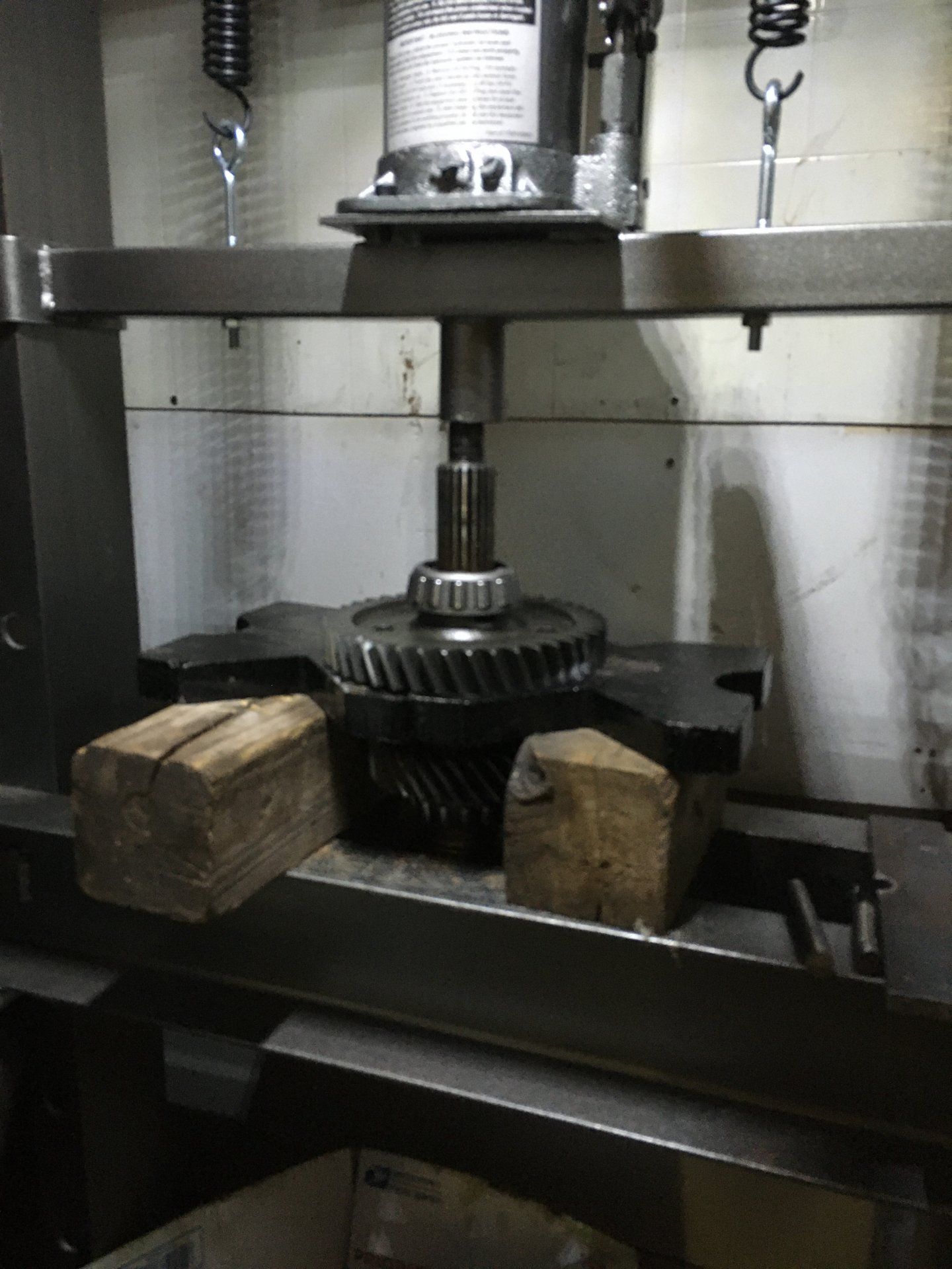

Well I manned the press. Told Rob I prefer to only be mad at me if something gets messed up. He was happy to let me handle it all stating ‘your in deeper than I’ve ever been; I’ve never rebuilt an engine!’ Go big or go home right?

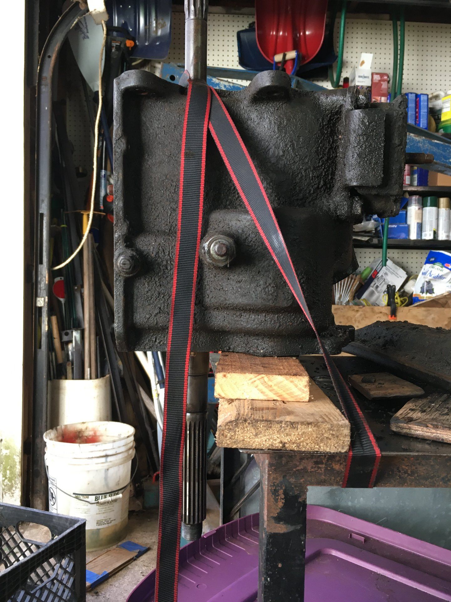

Ok well I got the output front shaft in no prob.

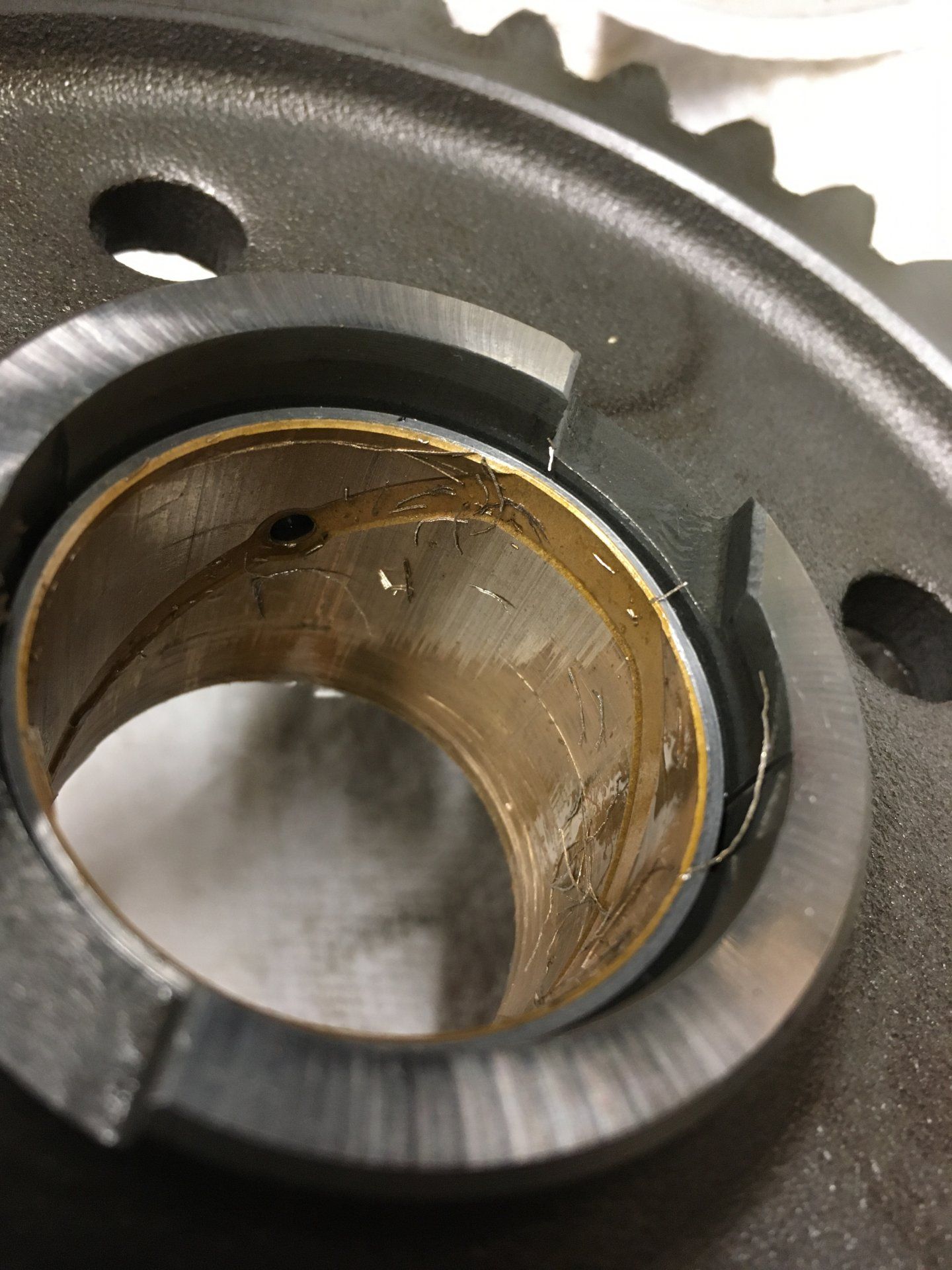

Started in on low gear w/ it’s bearing and had a sense something wasn’t right. It was going but I could see how I’d set it up something wasn’t meshing well. I pulled the assembly out and noticed I was shaving some copper from the inside of the gear. Luckily it’s not bad. I’m not too anxious. I had lubed but I really think my platform wasn’t firm enough and I was getting a teeter inward.

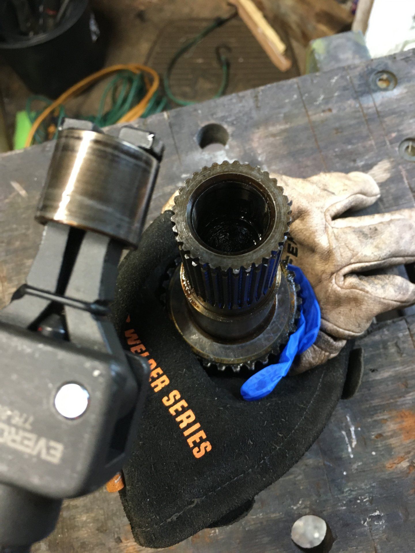

I was able prior to all this to get the little pilot bearing w/ a rental slide hammer and puller from Napa. We won’t go into how I broke the pilot bearing I had.... but the new bearing is in now. It definitely helped to put it in the freezer for a bit to be able to push it in easier.
Well now I feel like an ass... apparently the gears to shaft should be slip fit. Haha, oops.
A little polish w/ 600, oil and they slid right together. Phew!
