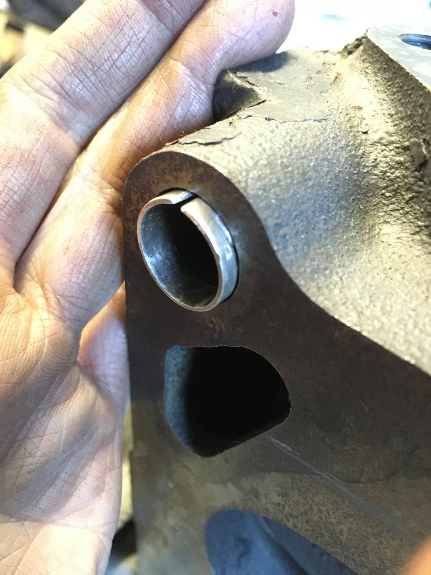

I lost one of the mounting pins (it’s really a ring) literally right after bringing the block home from the vet... uh machinist. So I wasn’t worried, I knew I had a sterling ring that was just about the exact size. Talked about it and then made it work. Perfect. It’s got a road runner on it so maybe that will give the girl a little extra boost in her step.

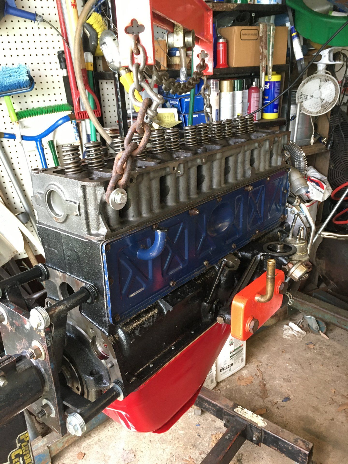

I'm digging the color on the different engine components. All black engines are so boring (and hard to spot oil leaks on).

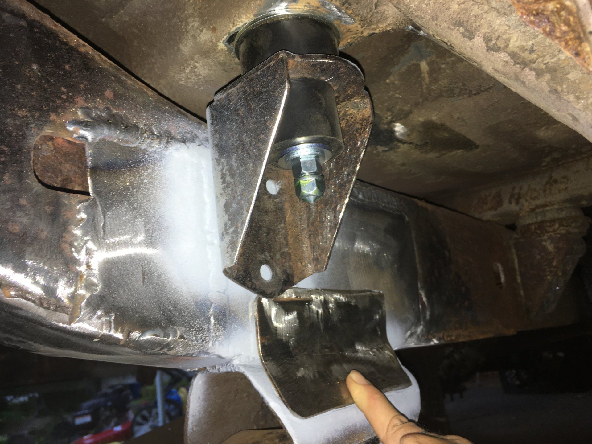

Made a patch and welded it on. Made a new gusset (?) and will get them welded in place this week. Then paint and add body mounts hardware.
Ignore that little hole. It popped up as I was removing surface rust. I’m gonna goob it up w/ paint/linseed and consider it a drainage hole.

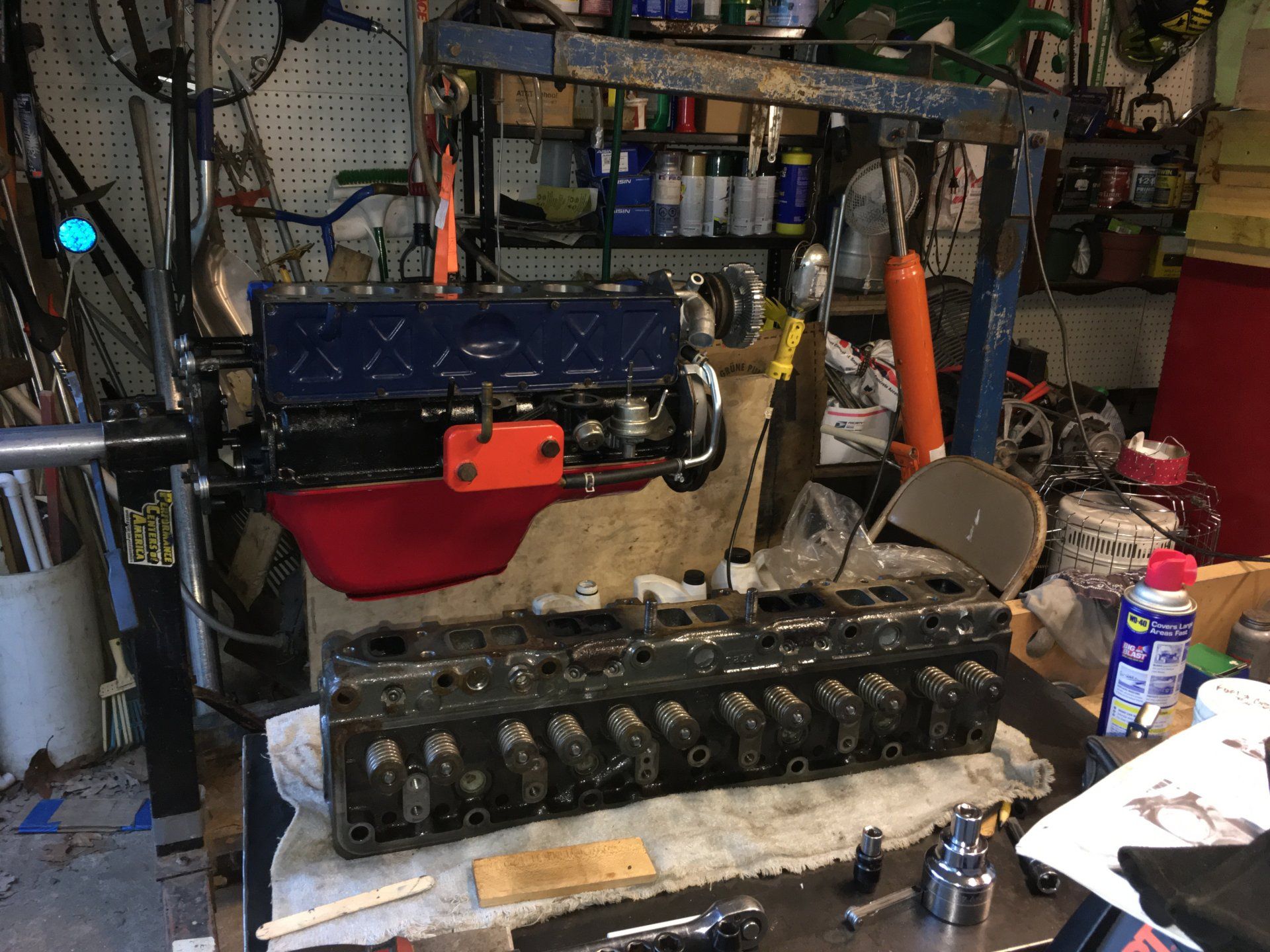

Rocker arms are installed. Still need to adjust the valves but no biggie. Tossed the valve cover on just to protect it. Going to wire wheel all that crappy rattle can paint I put on the cover and have my local powder coater do it much nicer.
