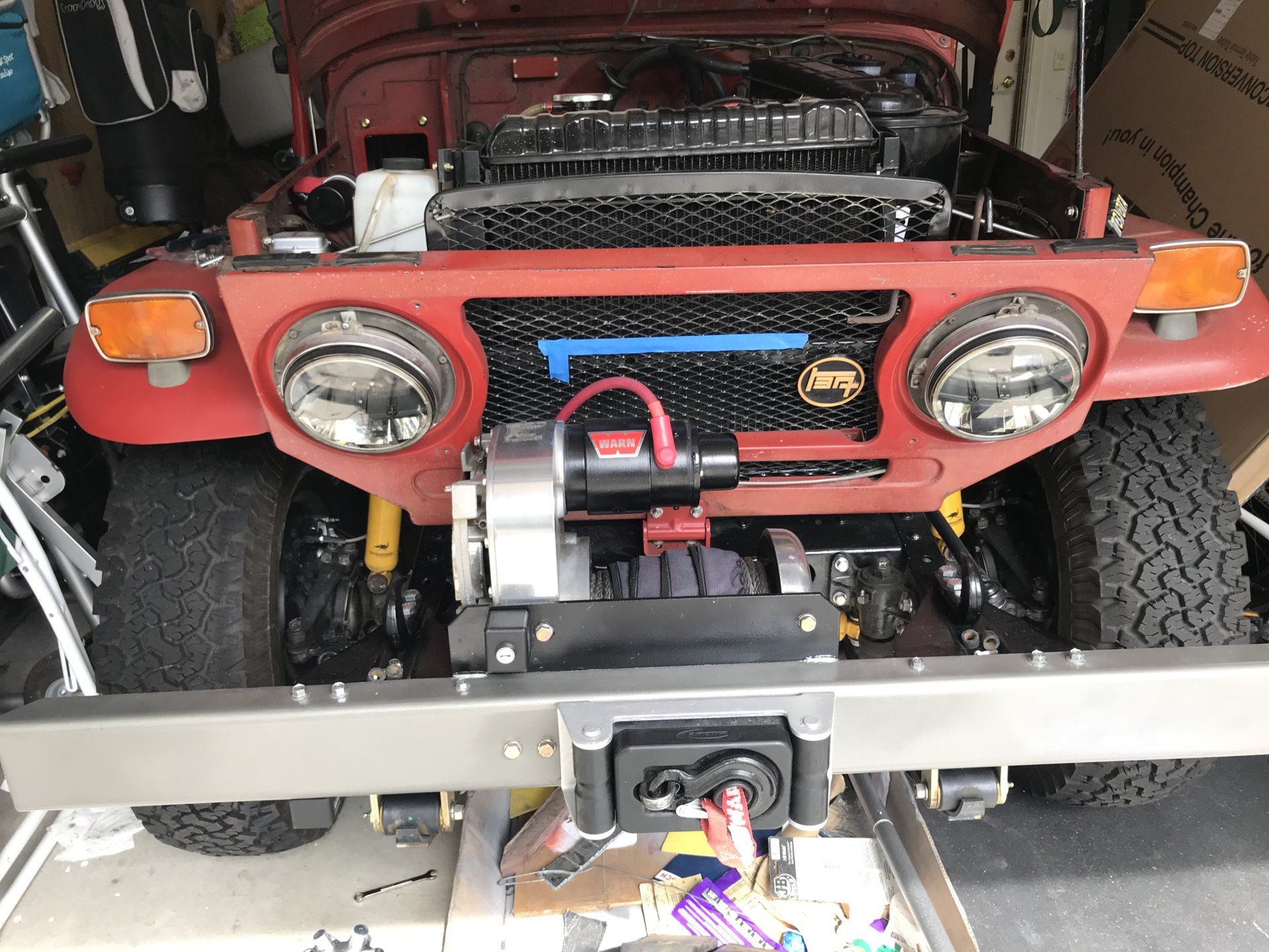

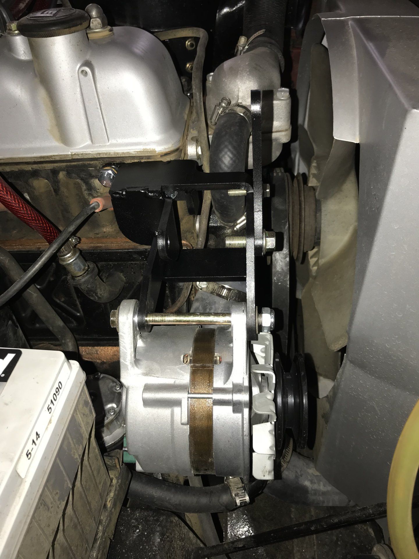

Started installing some of the hardware for the AC. Installed the Vintage Air bracket after a few coats of paint. Removed the alternator and relocated it to its new home. Worked well that bracket is crazy with all the bends. Will need to move the battery some to accommodate the plugs.

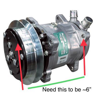

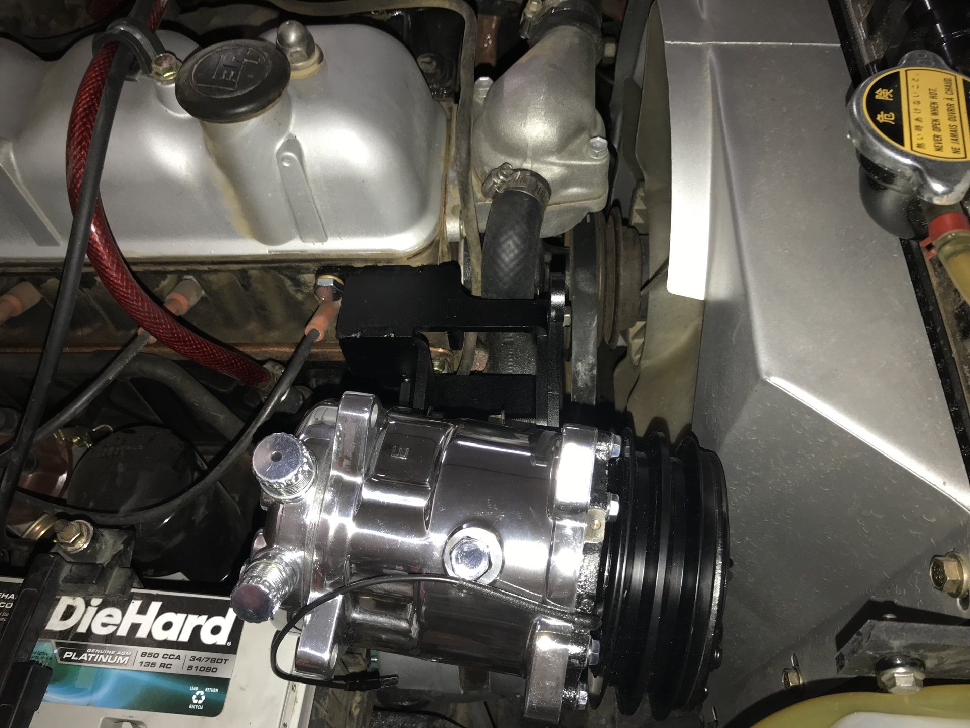

Went to install the compressor and ran into a problem. The fan shroud is in the way... :(. I read on the Vintage Air instructions that the shroud will need to be modified. But I’m thinking that a single groove pulley would be shorter? I only need about 1/4” for it to clear. Anyone have a Sanden style compressor and can measure the distance as identified below? Thanks!

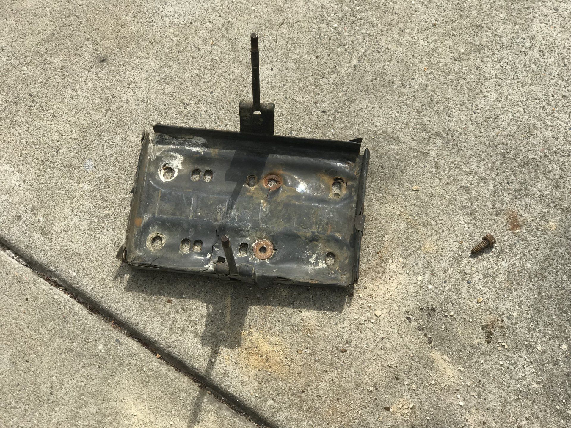

Have not had much motivation on the cruiser lately. I think the scope of the AC project is a bit daunting so I’ve been moving slowly. Worked a couple of hours today to remove the battery tray (PO removed the welded in nuts that held down the tray so getting to the nuts was not easy). Also had to drill out a sheared off bolt as I’ll need that hole to move the battery tray. Tray has seen better days.
What is that little hook at the upper corner of the battery tray? It’s bolted to the tray mount.
I feel bad I haven’t been following along. My Sanden compressor has a single pulley. Like you showed in the third image. And we didn’t have to modify my shroud. That double pulley you’ve got is a problem.

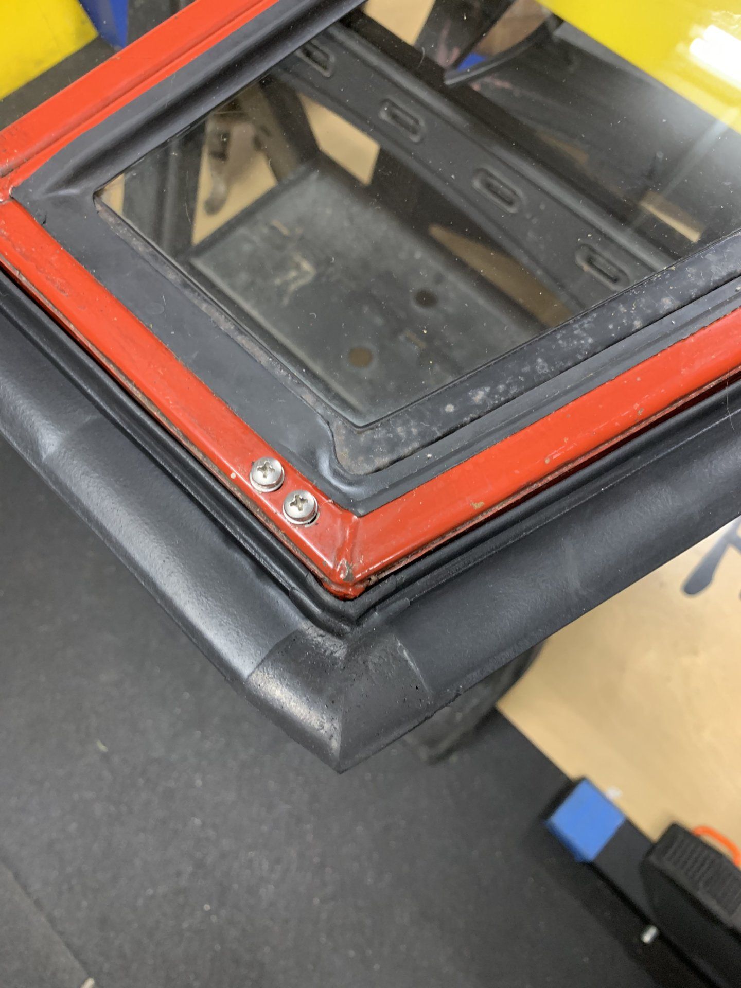

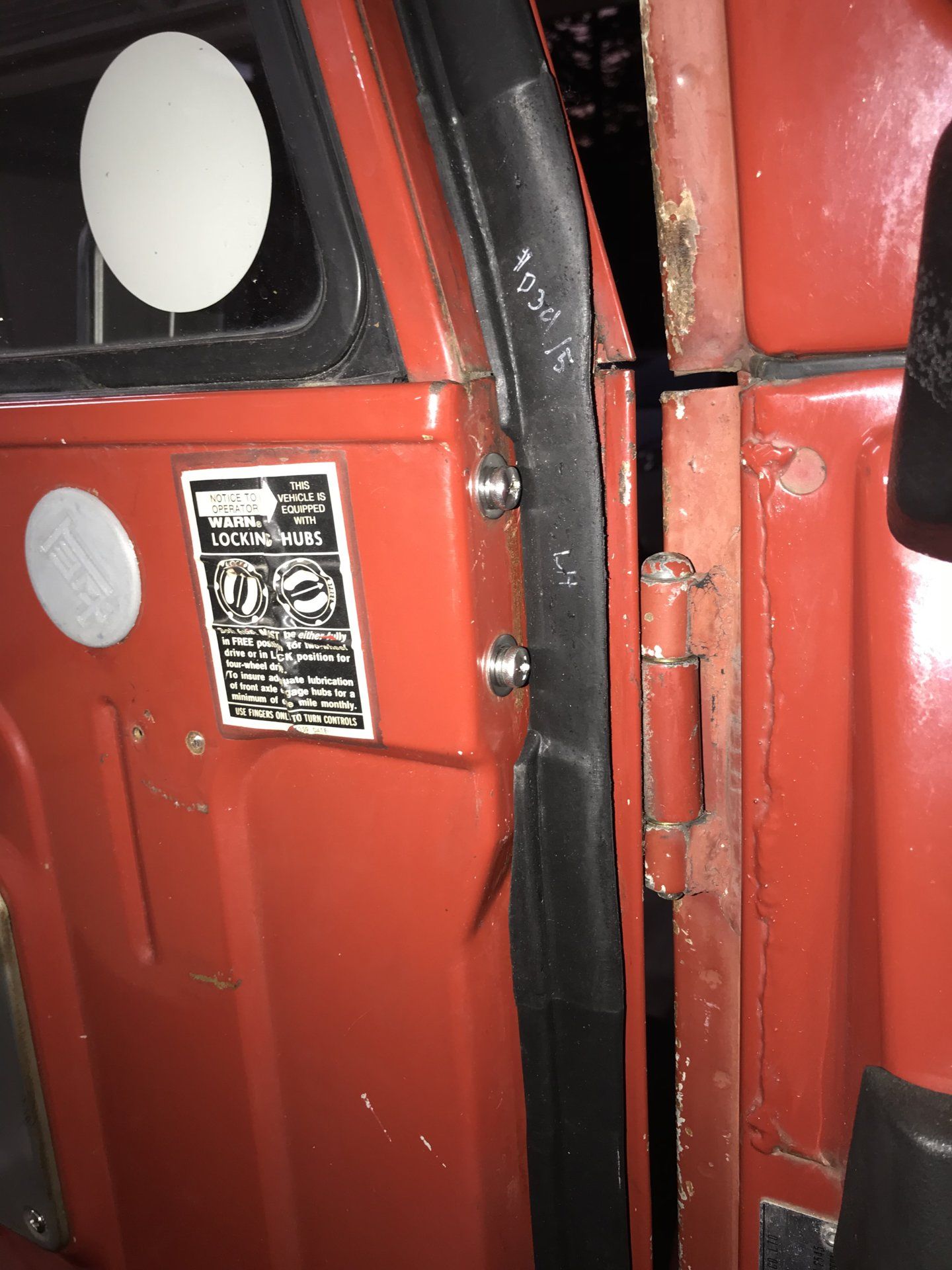

Doing some things except of course the critical AC project that has rendered my cruiser useless. But this is an exciting project I’m helping with - testing out the prototype 74 weatherstrip!!! Awesome job again by @Racer65!!!
Installed some additional seals/packing from my stock of @Racer65 goodies. Door seal is crazy tight now, excited to try a water test on it. Seems pretty well sealed up!

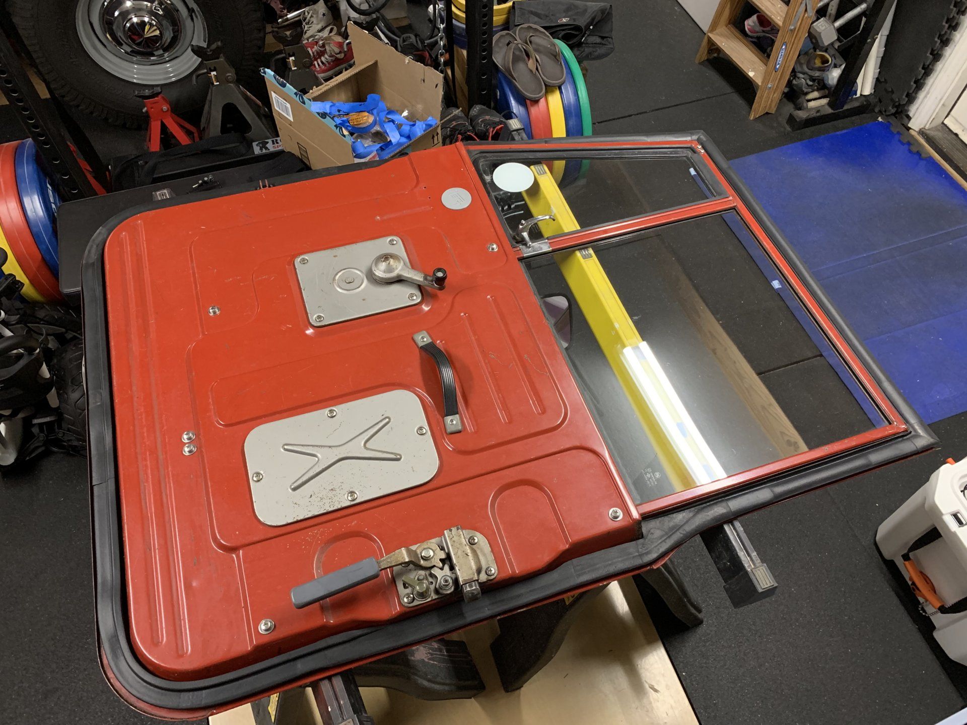

And like the drivers side door I spent 3+ hours removing multiple layers of weatherstrip adhesive from the passenger side door... gotta love the brown stuff wow what a pain. Whatever the PO used for the black adhesive was nasty too. Yay. But now it’s ready for the test 74 weatherstrip so that is at least exciting.

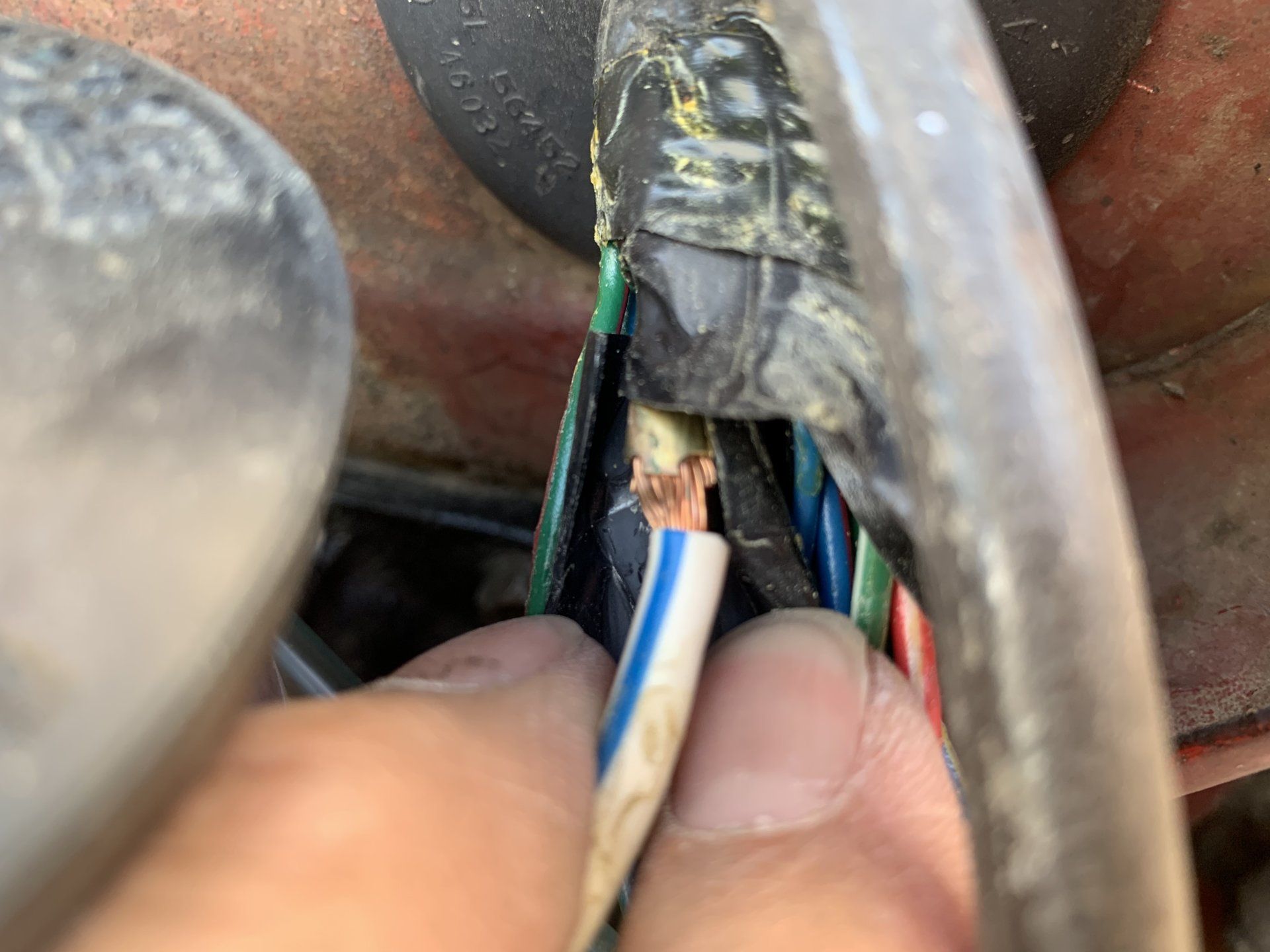

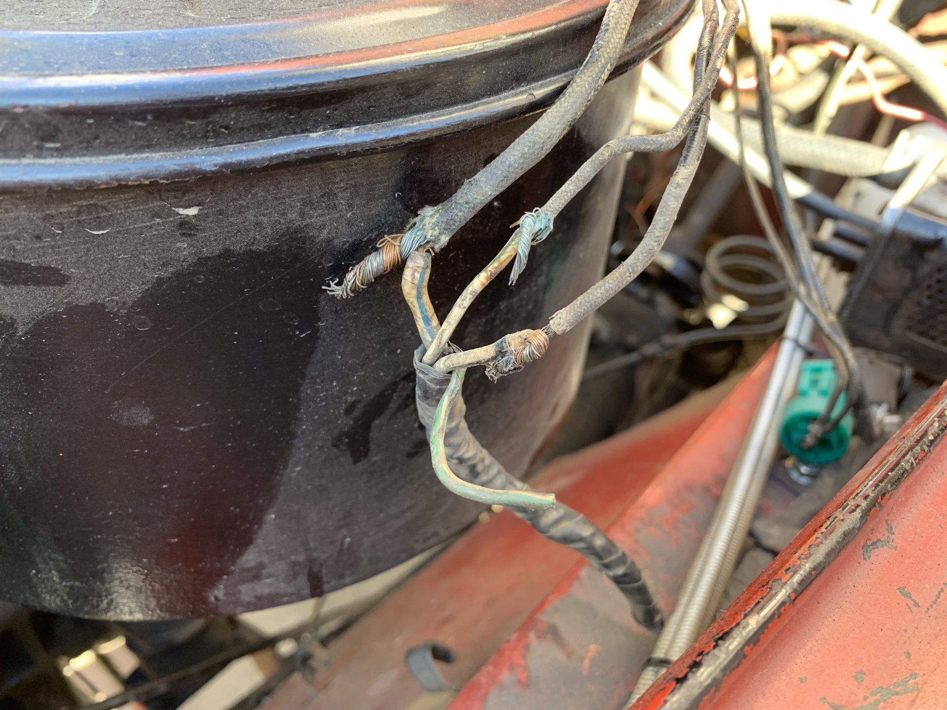

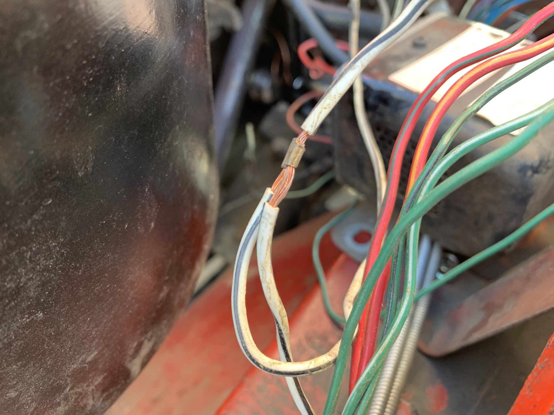

Relocating the alternator... lovely PO splice. Some “factory” looking splices too... I’ll post those in the next post to see verification.
@Coolerman are these factory splices? The large one with the blue stripe is for the alternator. It was under tape and has an extra layer of plastic/rubber tube around it. Just outside the firewall. Seems like a lot of effort to splice after the fact.
Harness tape carnage... some non-OEM stuff too for the bad splices. Now I just need to find where I put the tape from coolerman (and the correct wire I bought from him too - danger of sitting so long on a project - forget where you put stuff ugh).
View attachment 1890635 View attachment 1890636
Be aware you can buy those splice fittings so as a rule it is the way that they are wrapped that tells you if they are factory rather than the splice itself. I literally have 1000's of them on rolls we use on the looms we build . The other thing they do tell you that that if it isn't factory then at least it was done by someone with correct tooling and terminals . I would expect anything that has had QC such as a factory loom to have a closer insulation coverage to the splice than that but many have been pulled and had a pretty hard life.
You see how it has small tabs on either end that means it came from a roll, if you look close you can usually see if it was flush cut or tapered cut and you can tell if it was machine crimped or hand. Most of the Japanese stuff is roll fed machine crimped.
