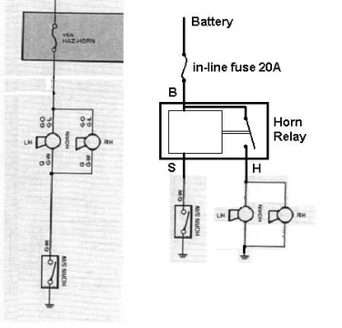

Replace the fuse and clean contacts. Corrosion/bad contacts/old fuse is often the culprit.
If that doesn't solve the problem you have 2 ways to go:
1. Check the wiring from head to tail which can be a real PITA
or
2. Install a horn relay, feed direct from the battery and be amazed HOW LOUD these 30+ years horns sounds.
All you need is a horn relay and an in-line fuse. 20 minute job.

Or you can use a Bosch relay (#0332019203) with double output terminals

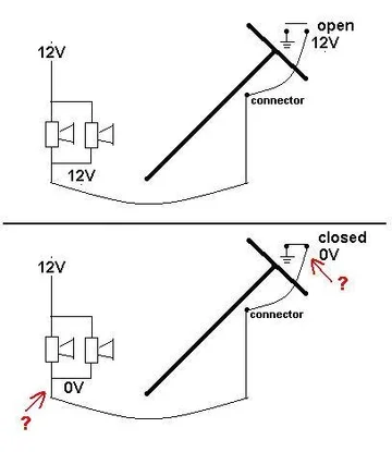

Okay, so it's definitely from the horns and there is no relay.
Then this is the diagram.
Please tell me the voltages you see when you hit the horn.
I want them all three. Horn positive side, horn negative side and horn switch.
► Post these numbers first before you continue to do the test below. ◄
I can tell from the numbers what the problem is.
Test:
Take your jumper cables.
Use only the black one.
Hook one side up to ground or better the negative battery stud.
Hold the black jumper cable to the negative side (bottom in the picture) of the horn(s). Works now? YES = OK
NO = Bad power supply from fuse to horns.
Hold the black jumper cable to the wire on the horn switch on the steering wheel (you don't have to hit the button, just hold the cable to that wire).
Works? YES = wire from horns to switch is OK.
NO? Hold the black jumper cable to the ground side of the horn switch and hit the switch.
Works? YES = Switch is OK.
NO? Hold the black jumper cable to a metal surface on the steering wheel and hit the switch.
Works? YES = Switch to ground is OK
No? bad contact from switch to steering wheel or steering column.
Hold the black jumper cable to the steering column and hit the switch.
Works? YES = steering wheel makes good contact with steering column.
No? Steering column doesn't make good contact with frame/chassis/body.
You've reached the end of this test. By now you should have found the problem.
Rudi

Thanks so much for your help! At the horns, the voltage drops to around 7v at one side of the horn and around 4v on the other side for both horns. At the horn buttons, it drops to around 2v. Thanks again, Taro
