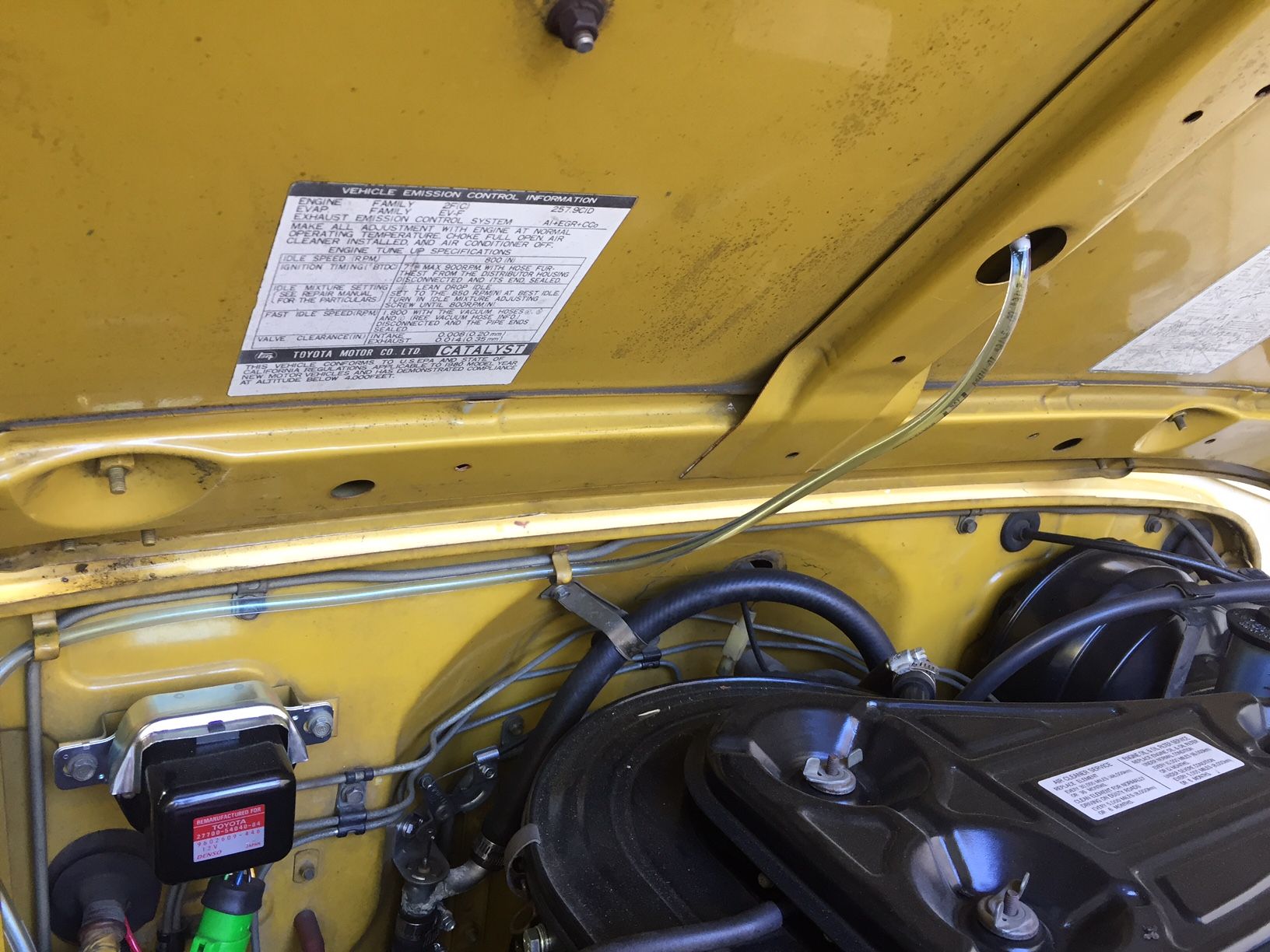

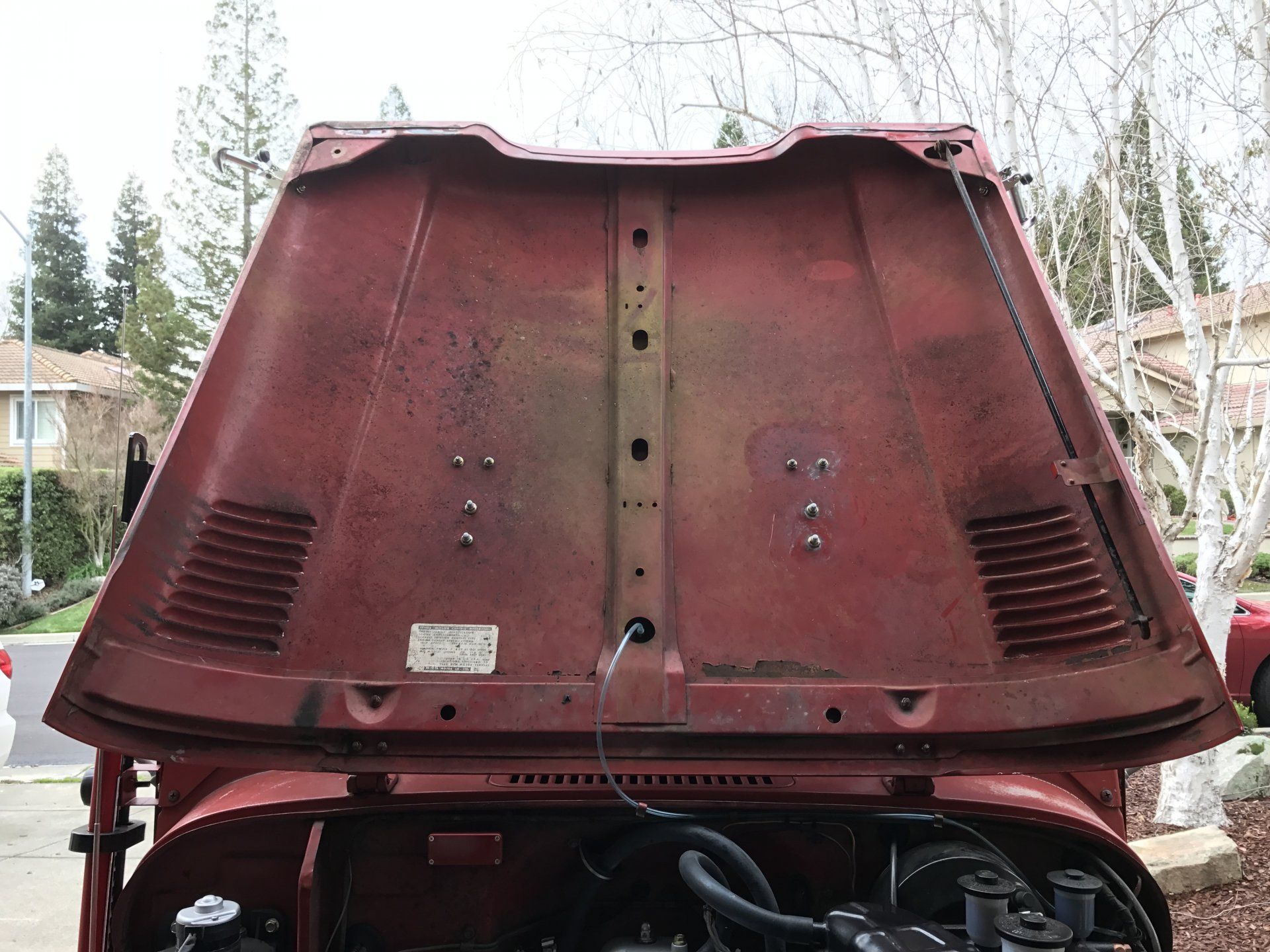

Okay maybe taking this OEM thing a little too far with a Toyota tube for my windshield sprayer. I needed a new tube since it was too short to open all the way and I was already placing an order for parts so figured why not?

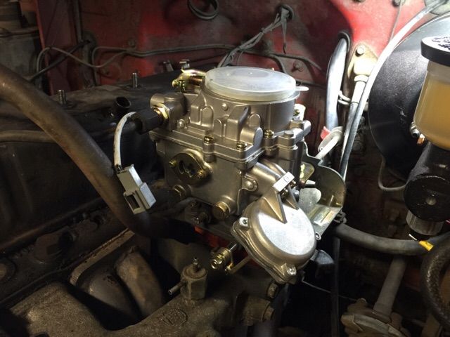

Carb almost 100% in. Like the moron I am, I can't figure out how the choke cable connects... :|
Mike I know it has been a few years since you installed your new carburetor. But do you remember if you had to do much tweaking? I finally finished my install and had it on the road this weekend, I noticed somewhat of a hesitation when accelerating, I found that opening the choke helped with that somewhat. Overall it starts nice, and definitely has more pick up, especially on the highway.
I had some hesitation too going uphill which I didn't have with my oem carb (could be the bigger tires as well). Honestly I had Georg help me set it up. I need to tweak it some as the idle has risen with time.
Keep in mind you guys don't have exactly the same carb. Mike has a Trollhole carb and you have the Fuji carb. However, both are the same model (i.e. same part #).
I got mine at Osh hardware.

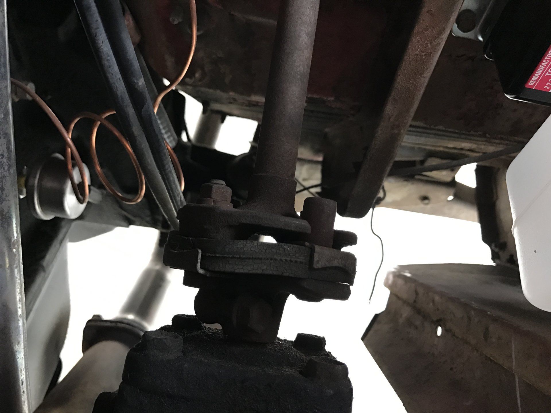

Okay rag joint is swapped too! Not a bad job - hardest part was figuring out how to hold the nuts/bolts of the steering column on the opposite side of the firewall. Once I got that figured out it was a pretty reasonable project.
Went out and test drove it and the steering is noticeably tighter. Between new rag joint, rebuilt drag link, rebuilt center arm, new tre's, new steering stabilizer, and correct alignment this thing tracks pretty darn nicely! Super bowl time! Go Falcons!

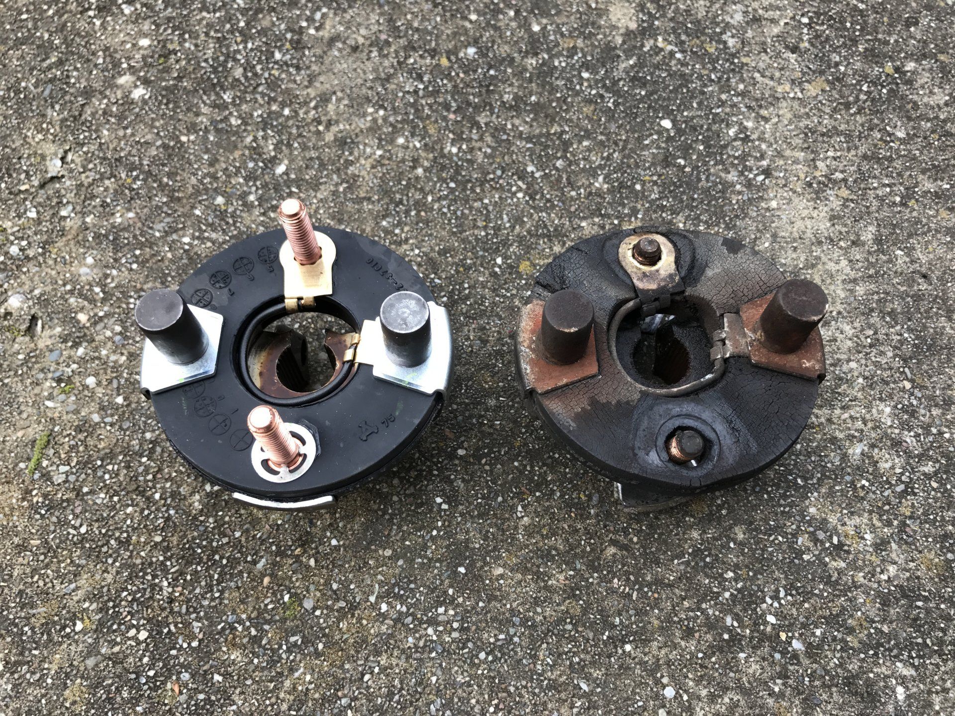

Old rag joint:
New OEM rag joint vs old one:
New one installed!

Mike, my steering coupling arrived yesterday and I plan on installing it this weekend. I noticed the picture of your old rag joint and it looks like you did some cutting on the two bolts. Any helpful hints on taking it off? I started using PB blaster on it today so hopefully the disassemble won't be that difficult by Saturday. Any big hammers involved?
Taking off the nuts was uneventful actually. No cutting needed - the little retention rings fell off or got loose that's why it looks like in the photo I cut them. The bolts just slipped out.
