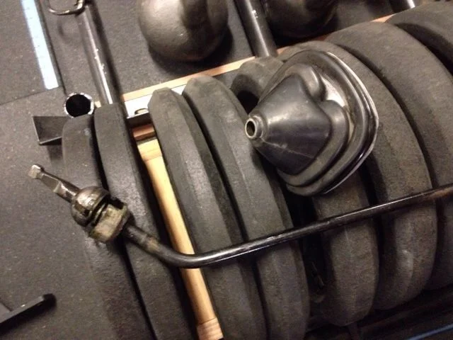

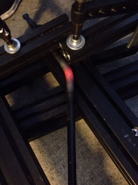

Bent my shifter cane tonight - a buddy of mine helped me. We each used our mapp gas torches at the same time and got it red hot - don't think it would've worked with just one.
Now we'll see if I can get this thing back in...

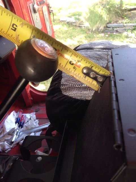

2nd and 4th gear clearance

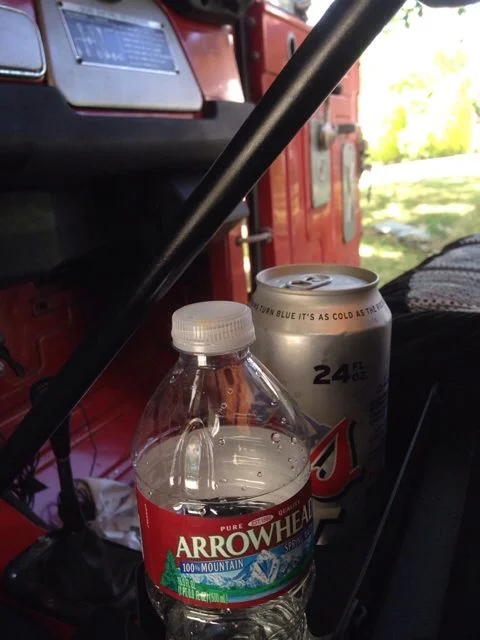

Okay got the shifter back in after a fresh coat of paint. Looks good and definitely was easier putting back in.
Clearance is pretty close with a standard water bottle in the driver side cup holder. Any large drinks will have to go to the passenger side. Still happy with it. FYI - I went with 30 degrees if anyone ends up doing this to their shifter. Perfect for my arms too don't have to reach at all. Almost right at the full extension (I'm 5'9" for reference).

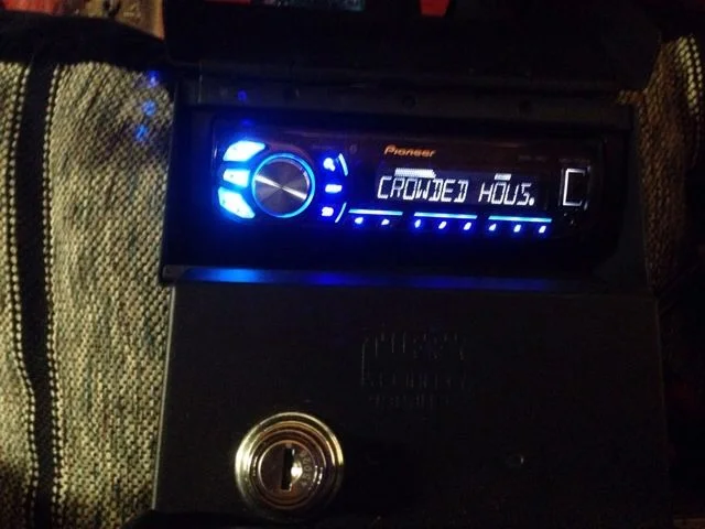

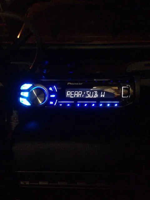

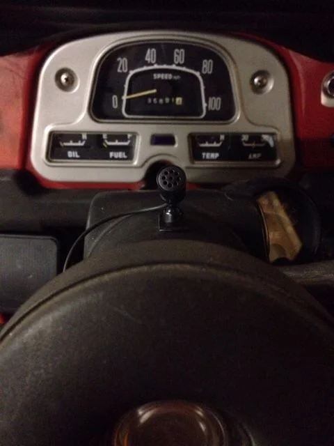

Okay so stereo is in and all is good! All four speakers work and the BT works great. I mounted the hands free mic on the steering column - curious to see how that works over the loudness.
