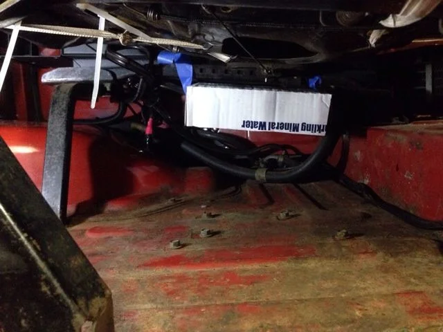

Did some really important stuff tonight - made a cardboard mockup of the amplifier to find a good spot for it. Looks like it will fit here nicely. I'll fab up an aluminum platform and mount it to the seat frame.

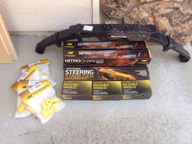

Lift kit has arrived! Will install at end of month.

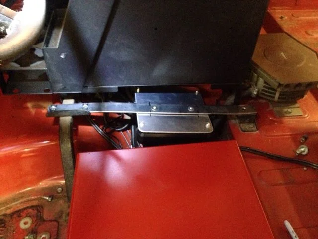

Working on mounting the amp to the seat frame. I used a 1/8" sheet of aluminum plate and some spacers to create that little gap which will help clear mounting bolts. Still trying to figure out what to drill through.

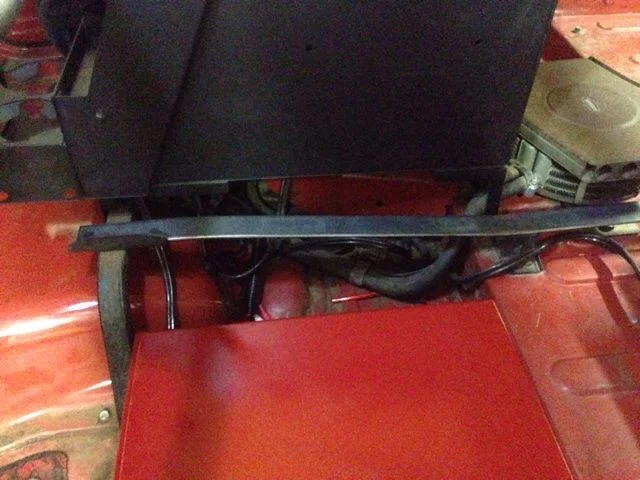

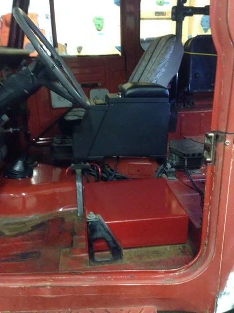

Figured out my amp mount - bought 3/16" thick steel, 1.5" wide and bent it to follow the angles of the chair frame mounts. Will bolt underneath the frame and provide a nice rigid surface to bolt the amp plate to. I'll put some rubber between the two surfaces to reduce the chance of additional noise. Should work pretty slick! I need to cut it down and drill it out still. With the leftover I'll make spacers for the other side so the chair doesn't tilt.

Got the stereo installed and the amp mount worked perfectly.

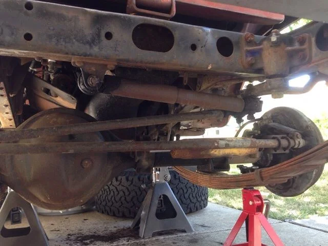

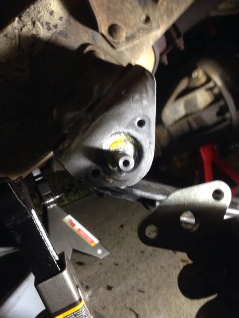

Started on the OME lift but ran into issues trying to mount the first spring. Just couldn't get it to align.
Any hints/tips/tricks on how to get that aligned? This is the rear drivers side spring that attaches to the frame (no shackle). Seems like whatever we tried did not get the hole to align.

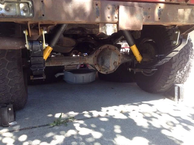

Well didn't get to fix the reversed springs today - family was in town and it was just too freaking hot. Will do it next weekend.

On the note of the duel stabilizer bars. Is that most likely the oem one went bad and they couldn't find one so they put a universal one on. And didn't bother to take the old one off.
Although some trucks have to run 2 and sometimes 3 to compensate for crazy sized tires. But your truck doesn't apply to this so your good
