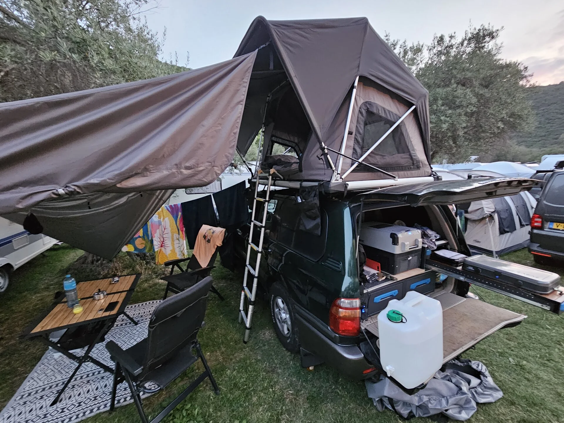

I went on a trip from Holland to Croatia, with a small detour to France. My cruiser is fully loaded with a rooftop tent, drawers, battery and luggage. The truck has stock suspension and AHC and was doing just fine until the first stop in France..
