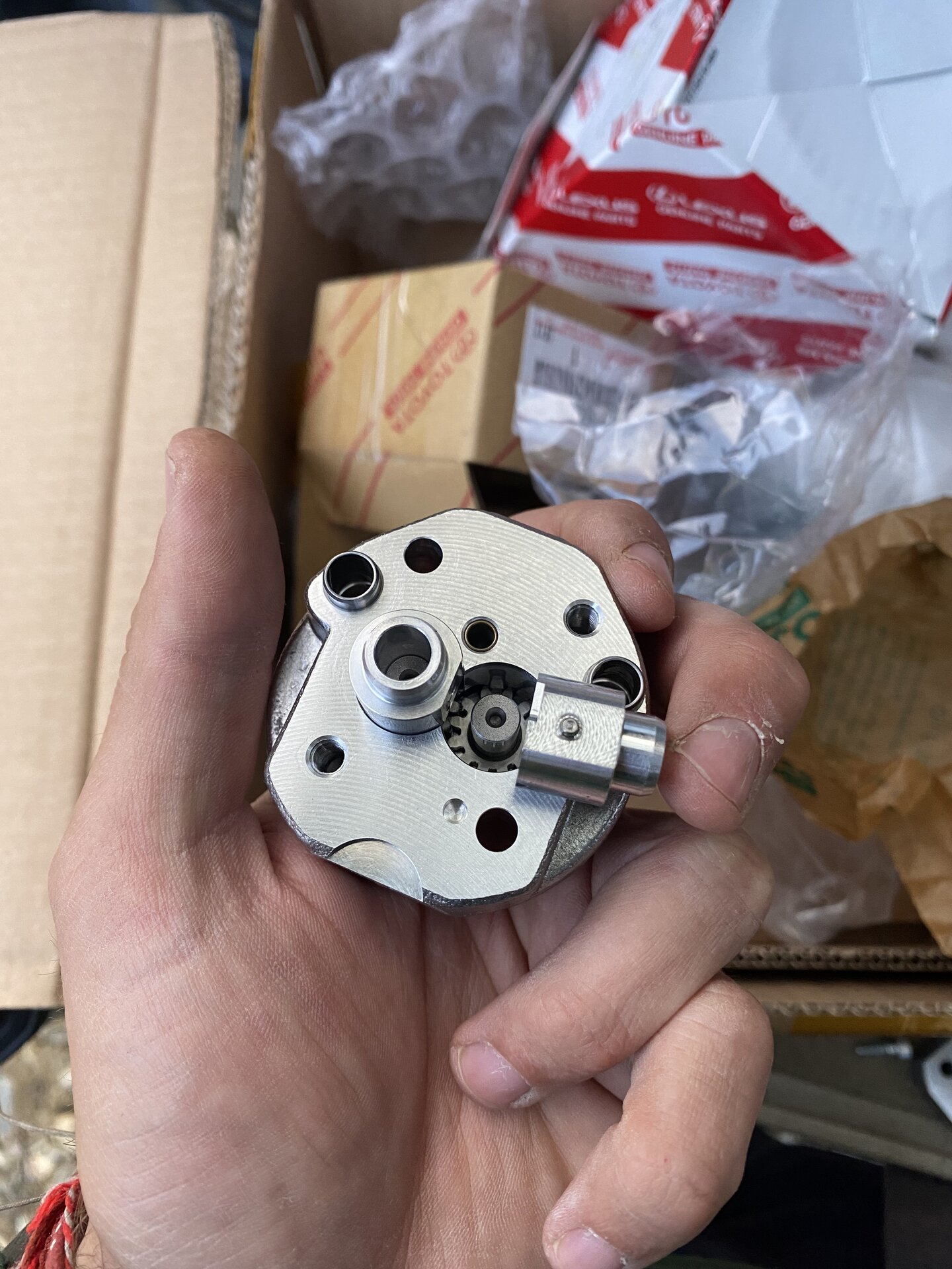

I was extremely reluctant to open it, but here is a photo of the brand new pump. It is as expected and opposite of the one I have works 🤷‍♂️
Something immediately obvious is that the gears are much harder to turn by hand on the new pump vs the old. And this is mostly due to the pressure of the two halves, when tightened with the two hex bolts. When they are not tightened the gears are pretty easy to turn, but once tightened there is more resistance.

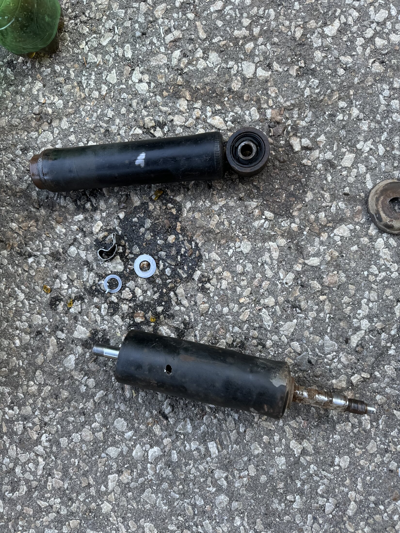

Before that I had to replace front passenger shock (hydraulic ram) - mine suddenly snapped couple of months ago, also a first, from what I have seen. The amber plastic bits came from inside, I guess some kind of a collar or a stopper. A completely destroyed bushing and lots of shims. Driving around with failing AHC, often on bump stops, especially in the front might have had done that. Hole in the upper part is where I had to stick in a large scredriver to prevent it from turning, to be able to unscrew the top nut.

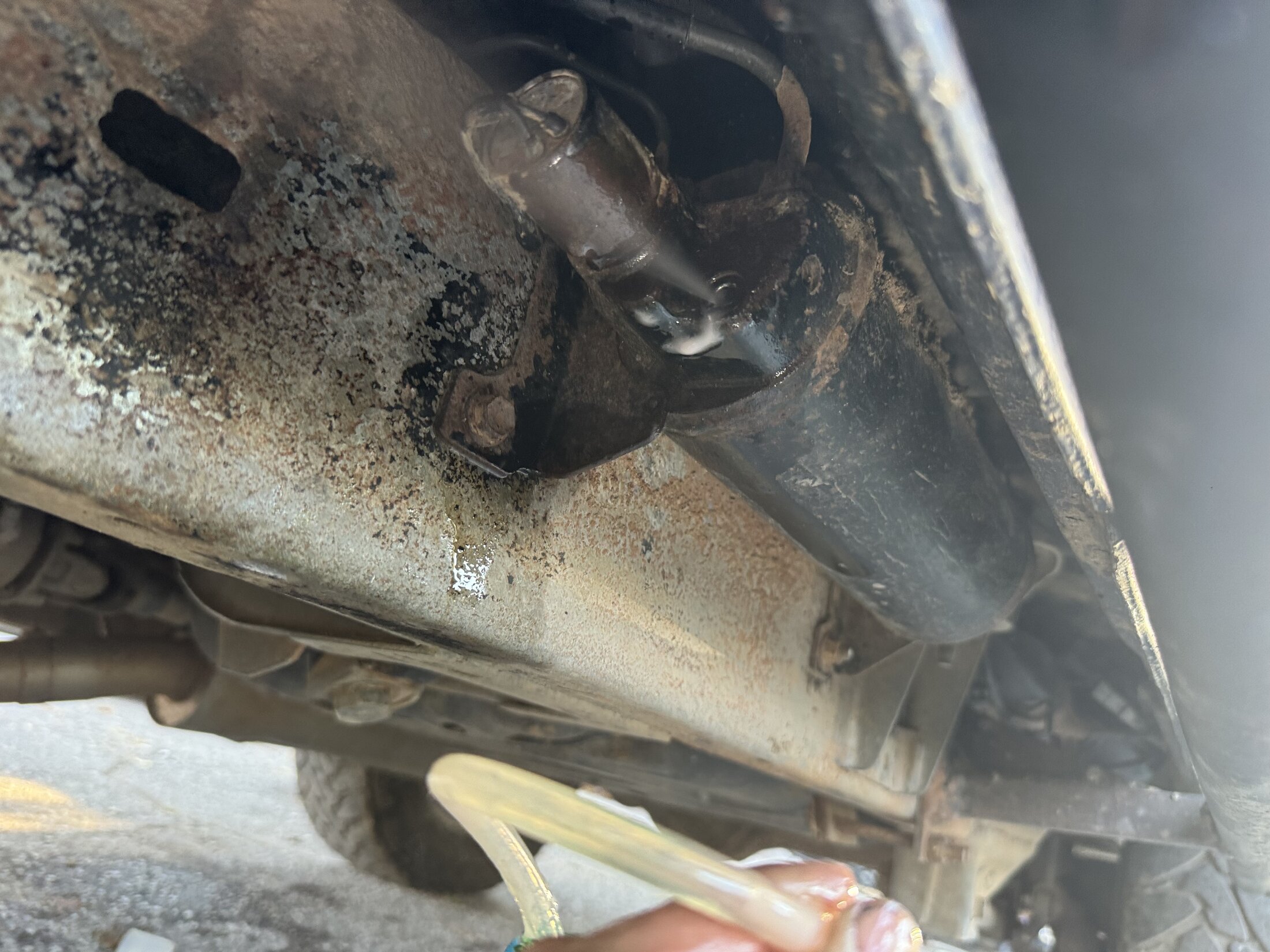

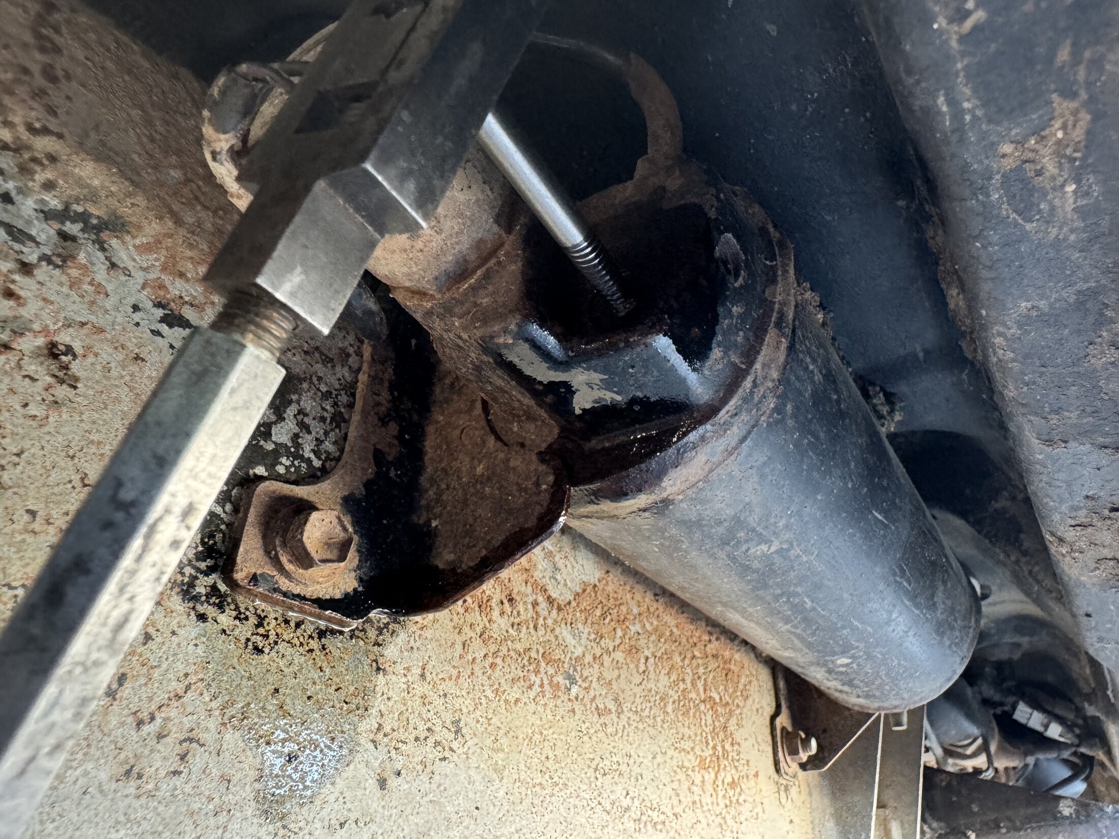

I also had broken bleed nipple on the accumulator since I got the car. I have a spare accumulator and made several attempts to remove mine, but **** those 2 bolts on top of the frame rail. Then I tried to drill out the old nipple and remove it with an easy out drill bit - no dice, it was super stuck. Finally went in with a 6mm drill bit and then tapped it with 7mm (original nipples are 7x1mm thread) - there was no trace of the original nipple or any boundary between it and the accumulator body, it was 100% fused! Removing the front globe and unscrewing the lines is essential to have the space to work and drill in a straight line.
I was kind of nervous about drilling into the pressurized accumulator, but figured if you go small, it should be fine, so I drilled with a 2mm first. Eventually fluid started spraying out. I stuck a tube to it to collect it in a bottle and not make a complete mess of the entire front drive side.
Eventually tapped the new thread, screwed the bleeder from the spare accumulator and of course, it leaked like a sieve - the nipples rely on a very tight fit between the nipple bottom and the seat in the body and of course drilling and tapping destroyed that.
