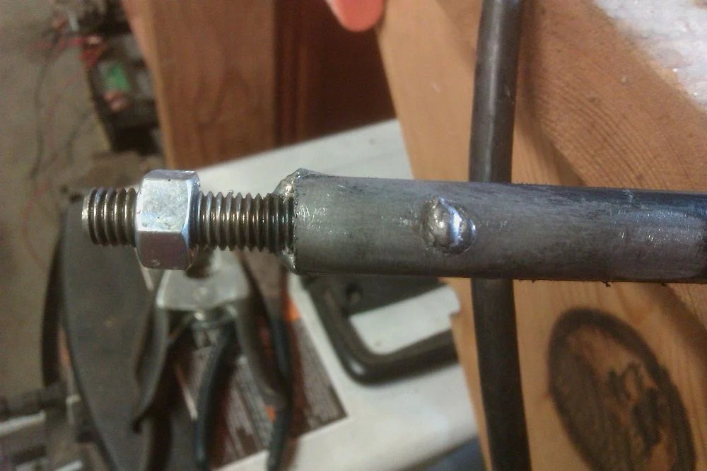

Doug's writeup is pretty comprehensive but here are some pictures if you want to get an idea of what's involved. Hope it helps!
Also, there are now a couple options out there from Wit's End and Trail-Tailor that make the full monty fix less attractive. I'd do it again myself though, because I like future-proof and also there's something wrong with me. Wasn't too difficult but there was some test fitting, fiddling and grinding needed to make it work perfectly.
The problem- bushings gone or loose:
Mod is replacing the rod ends with heim joints:
Pivots are drilled/pressed out and replaced with shoulder bolts (welded in, heads cut off for passenger wiper pivots, as backs must be flush):
as Doug also noted, you can't have this much sticking out above joint on motor pivot:
It's somewhat forgiving of mistakes. Mine were wiping the hood on the first test run, for instance.

Just finished up the Heim joint replacement.. Did 3 of the 4. I left the drivers side OEM joint in place. I used 5/16" heim joints from McMaster Carr. Hardest part was the position and lengths of the old joints. I thought I took good enough notes, but struggled getting it adjusted. Its near impossible to make any adjustments once installed.
This setup just screams for a TIG welder for doing some cleaner, finer welding. I'm going to get a new Toyota linkage for now in case mine is boned, and if it's NOT bad, just save the new until it's needed. Once it is, I'll do the Heim mod on the old linkage and see how well I can dial it in. I have a case of Schaeffer's bearing grease which is low tack (ie: not high pressure) that's waterproof and should last a good long time in the pivots and will use silicon plumbing grease on the ball joints.
