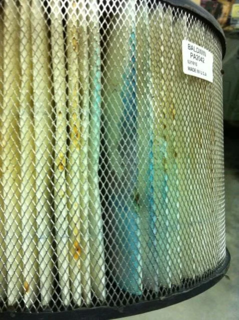

Thought I would share my experience running my snorkel this winter. Using the safari air ram head I discovered I was getting moisture into my air filter box, as seen in the first picture.

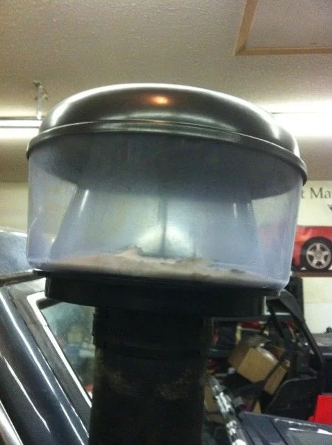

I decided to change it out for a precleaner style head and the results speak for them self. The second pic was taken after driving in an early morning ice fog at about -15*C. It was not snowing at all. You can see how much frost the pre cleaner captured.

So after leaving my truck sitting in parking lot at work for a few days while I was away working, I came home to discover about 3/4" of snow had even been able to blow its way in to the pre cleaner while parked. I can only imagine how much it would catch with the regular snorkel head in place. Definitely has the potential to lead to engine damage.

Maybe, maybe not? But what I do know is the filter will get wet and a wet paper filter is going to tear easier. Combine that with debris from a freshly sanded/salted road and the possibility for damage exists. Why take the chance??

I was referring to particles of sand or salt possibly tearing tiny holes through the filter, not large chunks "bashing through the mesh screens". I have never come across that amount of moisture, in any cars air filter driven on the road. I am not saying it is alot but certainly more then normal.
