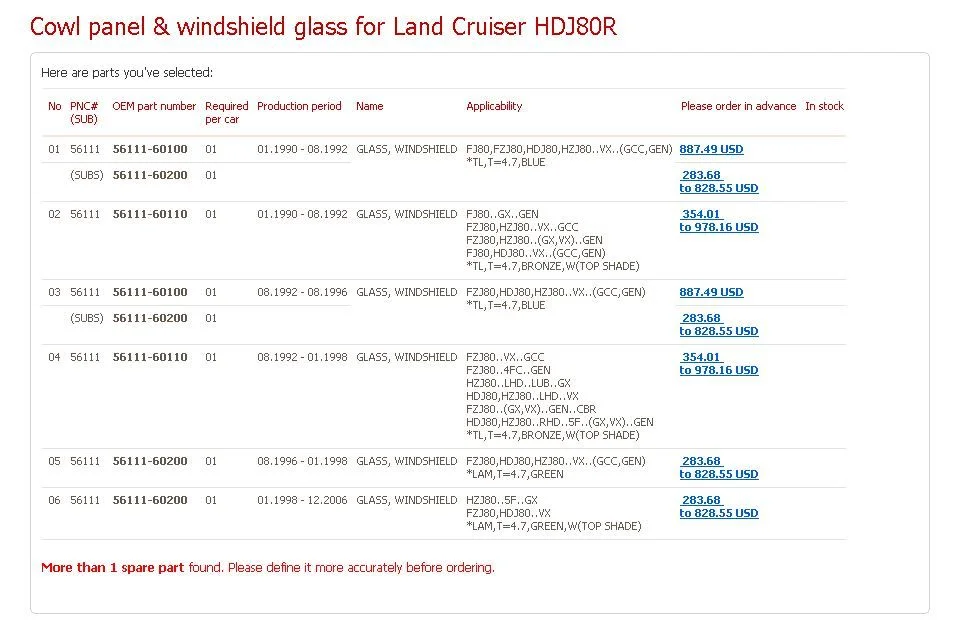

I've been needing to replace mine, the issue with a lot of the glass shops here is the rust I have starting to form around the top of the windshield, and the blank stares when I mention the FSM procedure, and their concern that it's RHD. I believe the windshields for the 80 series are all the same regardless of country of origin?
Toyodiy indicates my particular rigs windshield part # is 56111-60110. The EPC lists several variations of that number. Aside from tinting differences, they all should fit?
Any comments on this? Should be no difference between RHD and LHD?
Windows are the same as far as I can tell. Some of the part numbers may differ due to different tinting, or lack thereof.
same windscreen size and shape. numbers vary due to different tints
Any idea what tints are (or were) available? I'm looking at replacing the front. Glass shop says blue tint (with strip across top). That would match front windows. However rear windows and hatch are all bronze looking. I've also heard that called "solar" glass with tint mixed in.
My original plan was to try and figure out what tint could go on the front windows and windshield that might match the rear...but now I might be looking at a windshield replacement.
