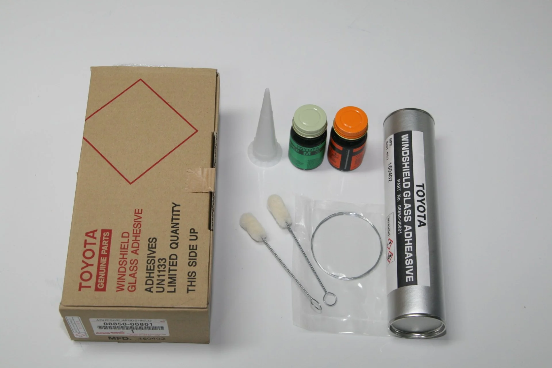

I did find the Third product shown on the SST on the net. Comes in a box with a two little bottles, one of them is Primer and other couldn't find what it is, applicators for the primer and a piece of wire, not cheap, in ebay goes up to almost $60.
