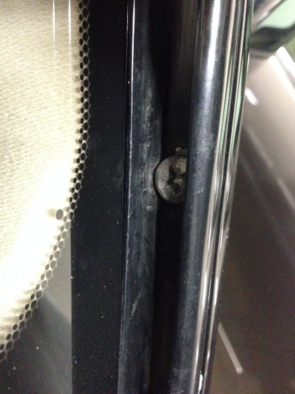

I've contacted six or seven glass companies to replace the windshield in the 100. Mentioning rivets - phone, text, email - to these guys ends the conversation faster than telling a Lexus dealer your credit score is 500. Meanwhile, the crack in the windshield is now about 20"... and growing.
I had an appointment with Safelite. The technician came out to the lobby, "I see your note about needing rivets... yeah, we'll need to order those." That was October; no word back and multiple attempts to contact that shop - directly and via corporate.
At this point, I think the way to go is to order the rivets, make an appointment at Safelite and drop the 100 with the rivets in a bag taped to steering wheel with a note: "DO NOT USE SCREWS. USE THESE" and follow the truck back to the shop to make sure the technician is on board.
But... I need an assist. Can anyone tell me which of the handful of part #s I've found on the interwebs do I need for a 2006 100?
Thanks!
(because posts are better with pics)
I believe 90269-04053 is the original replacement rivet, but these did not work for me because my holes had been enlarged with screws (the rivet wouldn't bite). I ended up using a larger non-Toyota rivets, but I think @2001LC or someone else found another Toyota part # for larger diameter rivet that may've been used on the Camry. I'll try to dig up the thread.
Thanks @aging fleet. I found 90269-04053 in a thread - maybe the thread you're looking for. The over-sized rivet mentioned in that thread is 90269-05034. I guess the thing to do is buy both - if those are the correct over-sized rivets. Any idea how many are needed? Toyota sells them individually.

The rivet holes enlarge, for one of two a reasons:
  • Running drill bit though.
  • Metal screws.
Both of which and use of wrong type rivet, breaks paint away from body (Bare metal)! So we must paint.
I use epoxy primer and POR-15 or just one or the other. Paint hole with a Q-tip, after preparing metal (POR-15 metal prep). Once paint just past tacky. I check hole for rivet fitment. If rivet hole to large for OEM rivet, I coat hole with more paint. I'll build-up paint until rivet fits sung. We don't want to building up/coat excessively thick. If hole so large 3 to 5 coats, won't make small enough for OEM size, move to next size rivet. POR-15 is incredible tough when applied properly. But even it, on and edge of hole, can breakaway. So we don't build up excessively.
