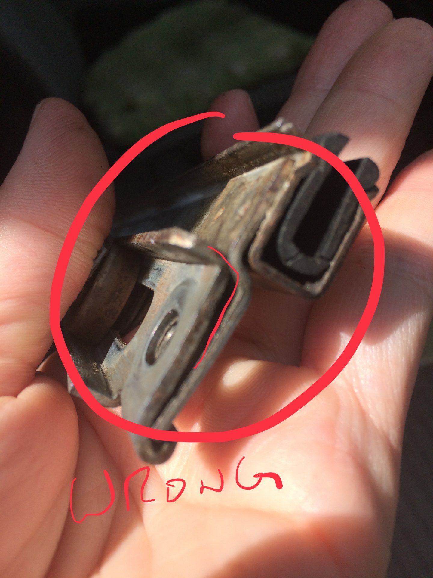

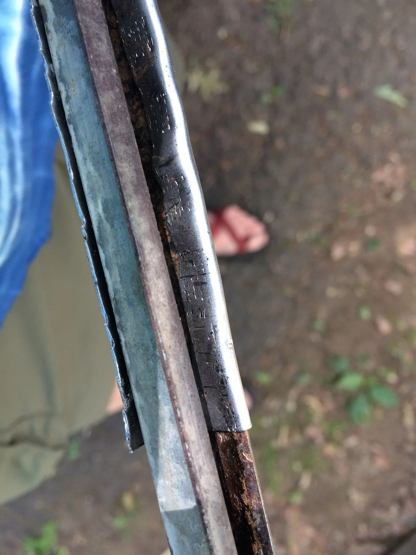

Holy s*** Batman. This photo is of me holding it the channel backward to show it CANT go this way. The other that you pointed out w/ the threads backward is the same.
Thanks “sweet person attempting to jump in too late in the thread w/o reading further back first” but yeah your right as was I when I was trying to prove that MY channel be lined up because of those two facts.

The glass channel is most likely not holding tight. The inner side that presses to the rubber is very thin and rusted and can’t crimp.

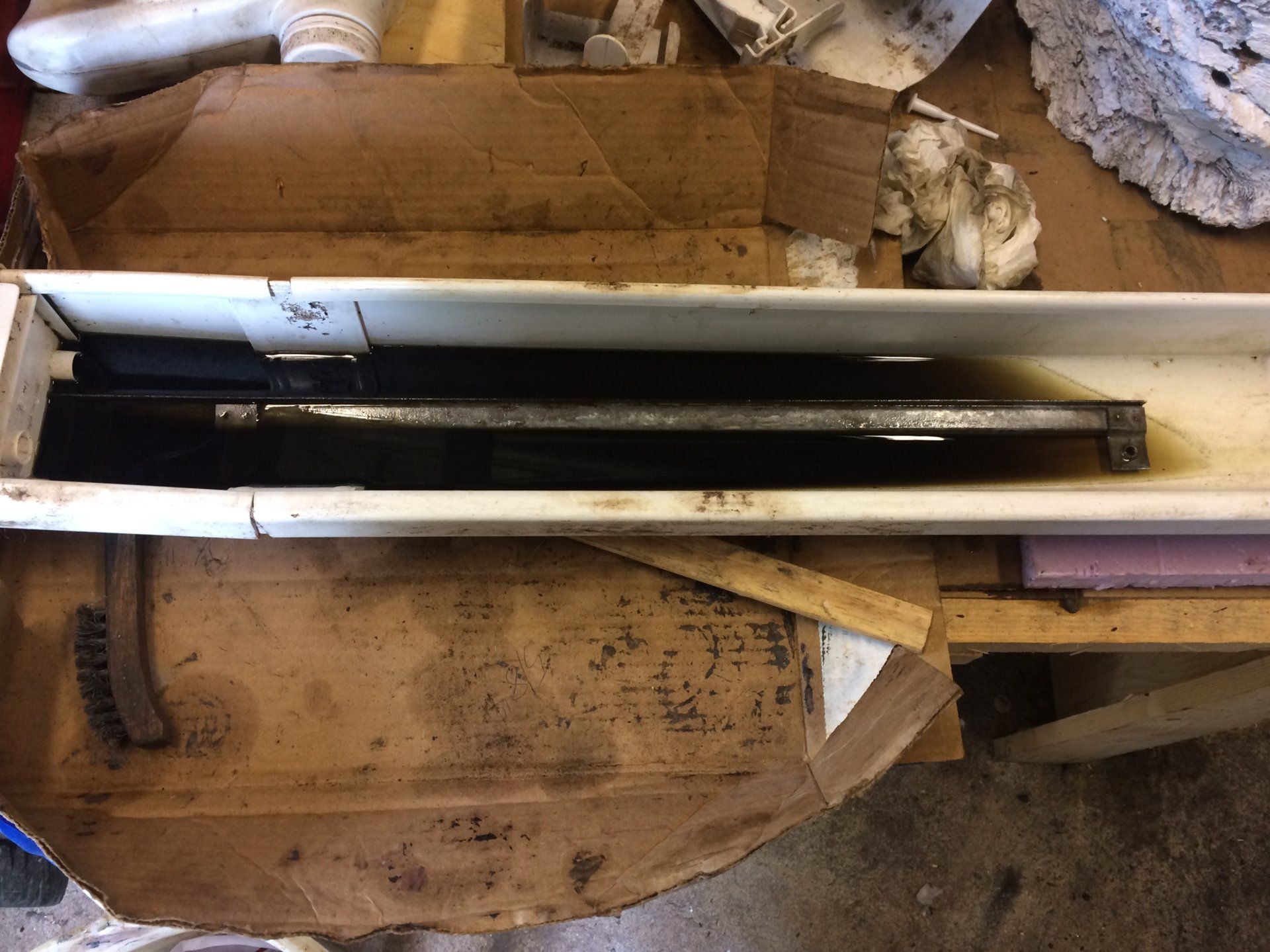

I put together a long reservoir to stick the channel in some Evaporist. Not much it will do w/o building up that side of it but I figured I might as well do it.

Looks like the window, w the channel still attached, maybe got dropped to the bottom of the door, bending the tabs out a bit. Then trying to use what was "original" bend, it is now tipping as soon as it starts binding in the guides, instead of picking up the bend in the glass to track around that.
would try bending the bolt tabs in to fit so square bottom of glass channel sits on top of regulator bar, and checking the hinge side guide.(but i seem to recall it does have a factory bend to it too.)Maybe it got bent, If it is out of whack, it could be pushing the glass in the front (lock) guide to bind, and hit that mount.

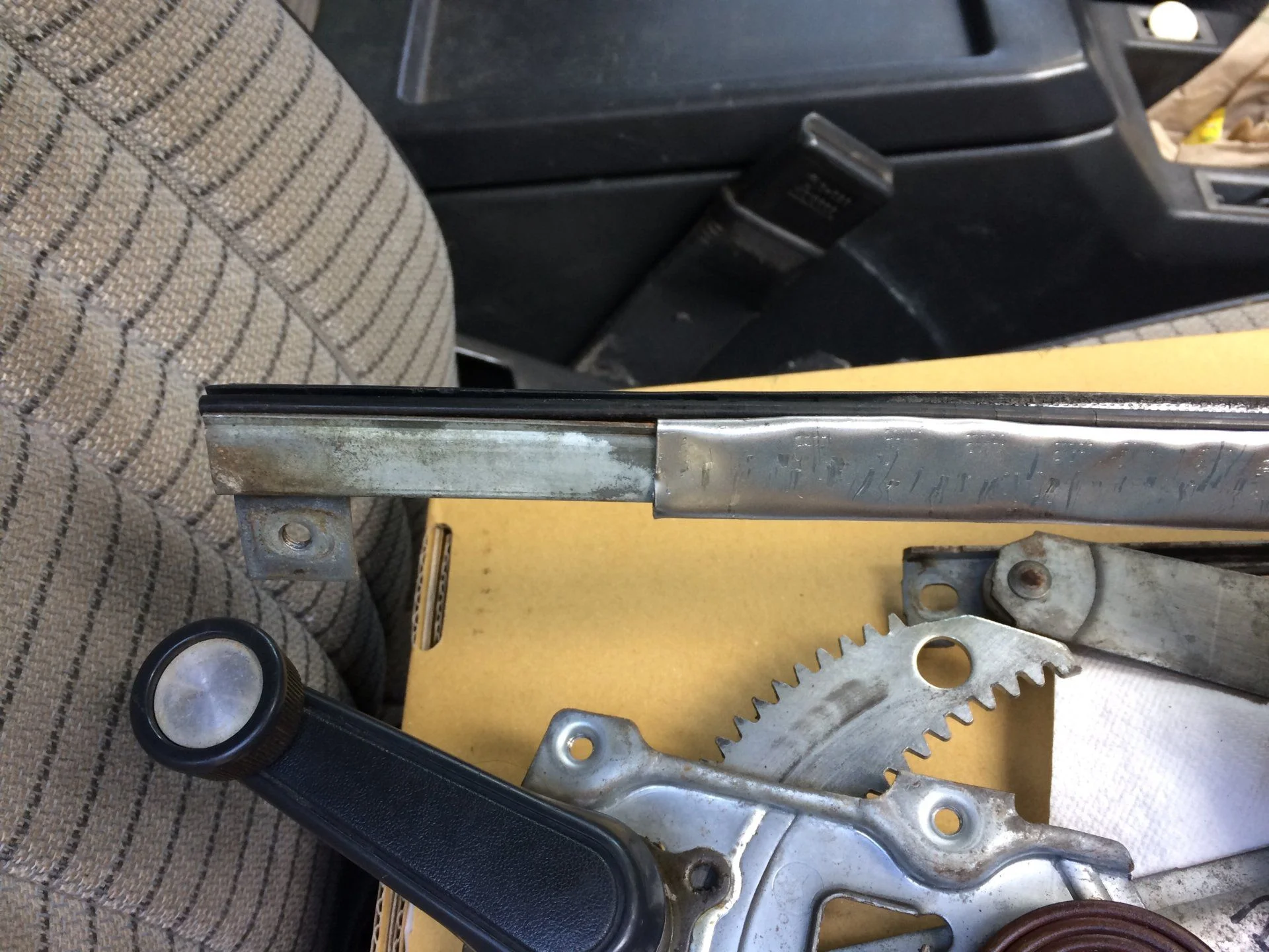

You know, it looks like if you just hacksaw off some of that extra channel, it would clear the handle mount....

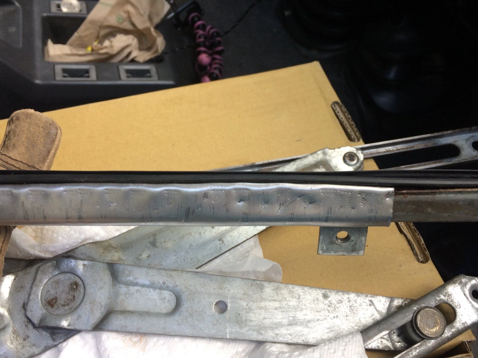

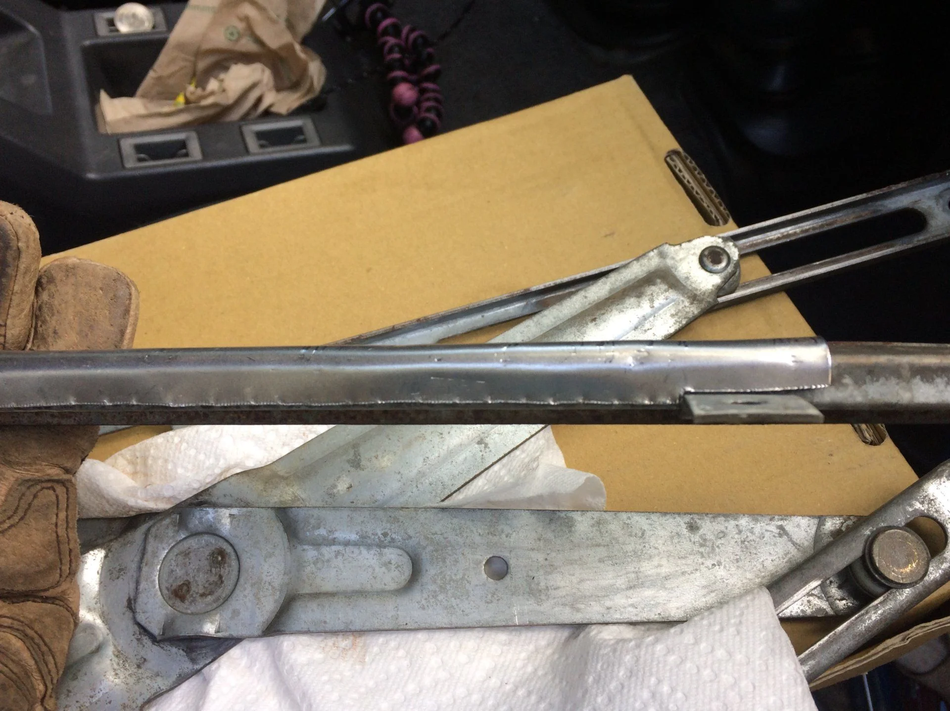

While my kid napped I cut and bent a stretch of metal plate to fit and cover the rusted section of the glass channel. You all know when someone says ‘dont’ I will.
I’ve yet to attach the regulator to it and take those measurements (which I’ll be honest, I think is bs) but the rubber is in the channel and pressed up onto the glass and far more snug then it was before.
