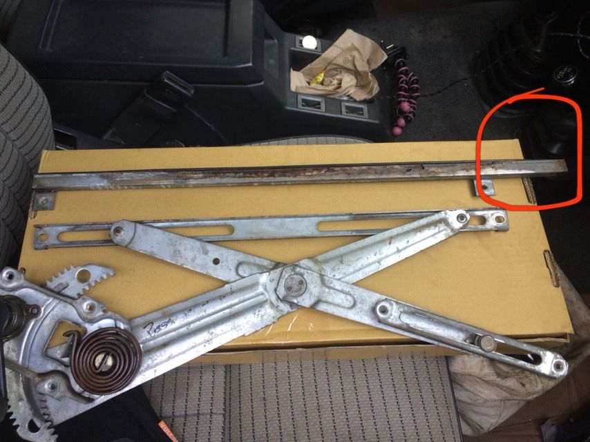

Why in the two first pics the track is way to long towards the rear and in the 3rd and 4th its looks like its at the right spot ??
Backwards maybe ?? But it does bolt to track like the two first.
Notice in this pic the track is no longer or past where it bolts together and not pasted the angle in the glass..
Man, I don't know, looks like that track is longer than what I have, mine don't go past the bolts.

87. I’m as confused as you are looking at my pics. The second two of mine I flipped the runner around against the riser to show itdoesnt line up that way to force the right side (door opening) edge to be even.

OK, so we have different years and parts are diff.. U have me stumped ! The ONLY thing I can see is ( or imagine ) is that the window is not sitting properly in the rubber track or the rubber not sitting right in track which would cause the window to be more towards that bracket?? It has happened to me before ? OR maybe when you cinch the hole runner to the window its a tad to much towards the rear of the door ???
I see that its rusted a bit? Could it be bent a little ?? A REDNECK FIX, You could cut it just passed the bolt where there is rust ? if Push comes to sh... :smokin:

My first question... should the runner have this longer end?

It’s so weird. I honestly can not imagine an earlier 80-85 60 would have a different window run from a late 80’s. In one of the pages I circled the run. It doesn’t show that extra section after the screw cleaning seat to the door opening but it’s what came out of the truck. I’ve fussed w/ it before a few years ago and had NO issues, why now? I’m not doing anything different than the directions. I’ve not taken the glass out of the door. It’s taped up in place.
