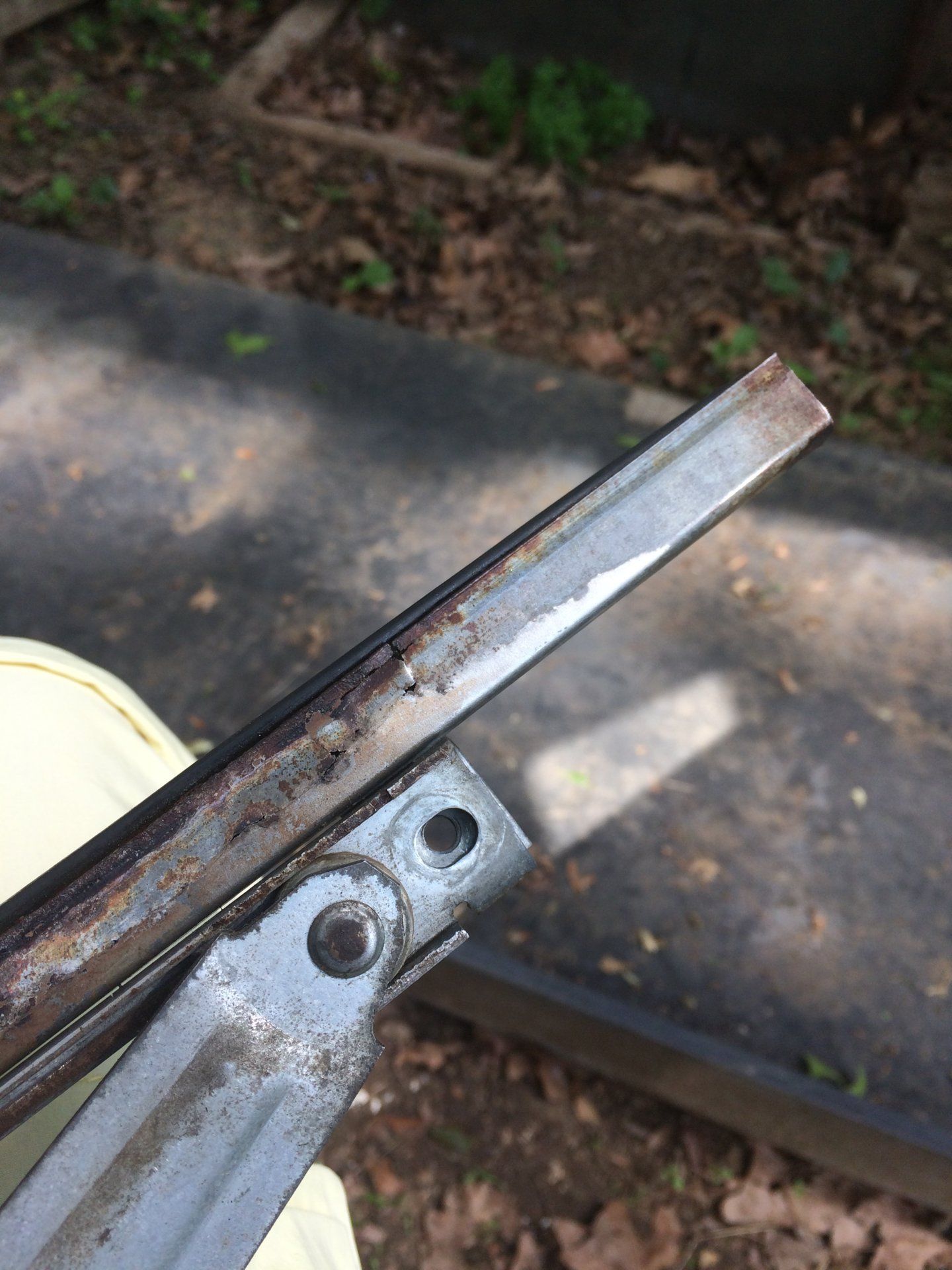

Trying to reinstall the rubber channel into the metal runner (yes making up my own terms) for the regulator in my passenger window. All are lined up...
Then for the life of me I can’t get it to hold past 1/3 being rolled down. The rubber pops up out and slides out some from the metal channel and the glass begins to tip.
I know the screws are a blind feed so that means all has to be mated up high in the door right? Once I have them all mated I get the inner screw (closest to hinge) and then slowly bring down the window and feed in the outer screw but as I said once I’ve got them tight and I attempt to check the glass slips up out of the rubber.

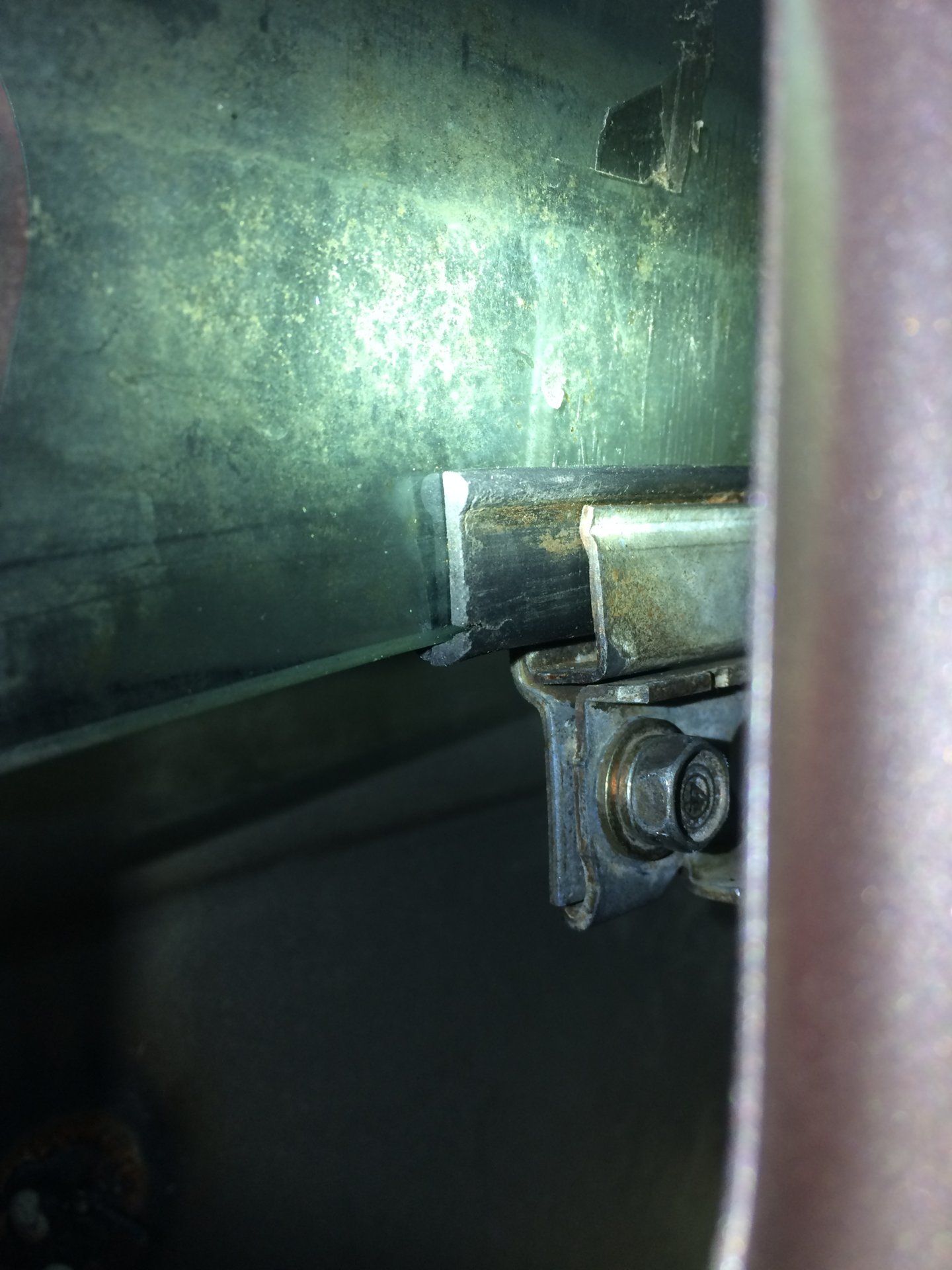

Try too see if the rubber that the window slides in all around is not ( binded ) or out of its track a little bit somewhere inside the door. this could cause it to do that? Also on the front inner portion there is a track about a foot long that comes off so the the window can be pulled out. You can loosen the screw that holds this piece to see if it will free it up a bit ( loosen it in the track ) Sorry I can't explain to good, hope it can help??
I'll gonna be online for awhile, shoot any Q's..
Good pixs, thanks. I’ll go back out in a bit and fuss some more. Doesn’t help my right hand is killing me and I’m working on just a few hours sleep.
Am I correct tho that the regulator needs to be in the upper most position to have the metal channel screwed to it?
I haven't played with it in awhile, you should be able to assemble it in lower position as long as the track is in same'ish area on the glass.
For final tight down I do do it in top position.Then in lower position I tight the front lower track portion ( pic sent )

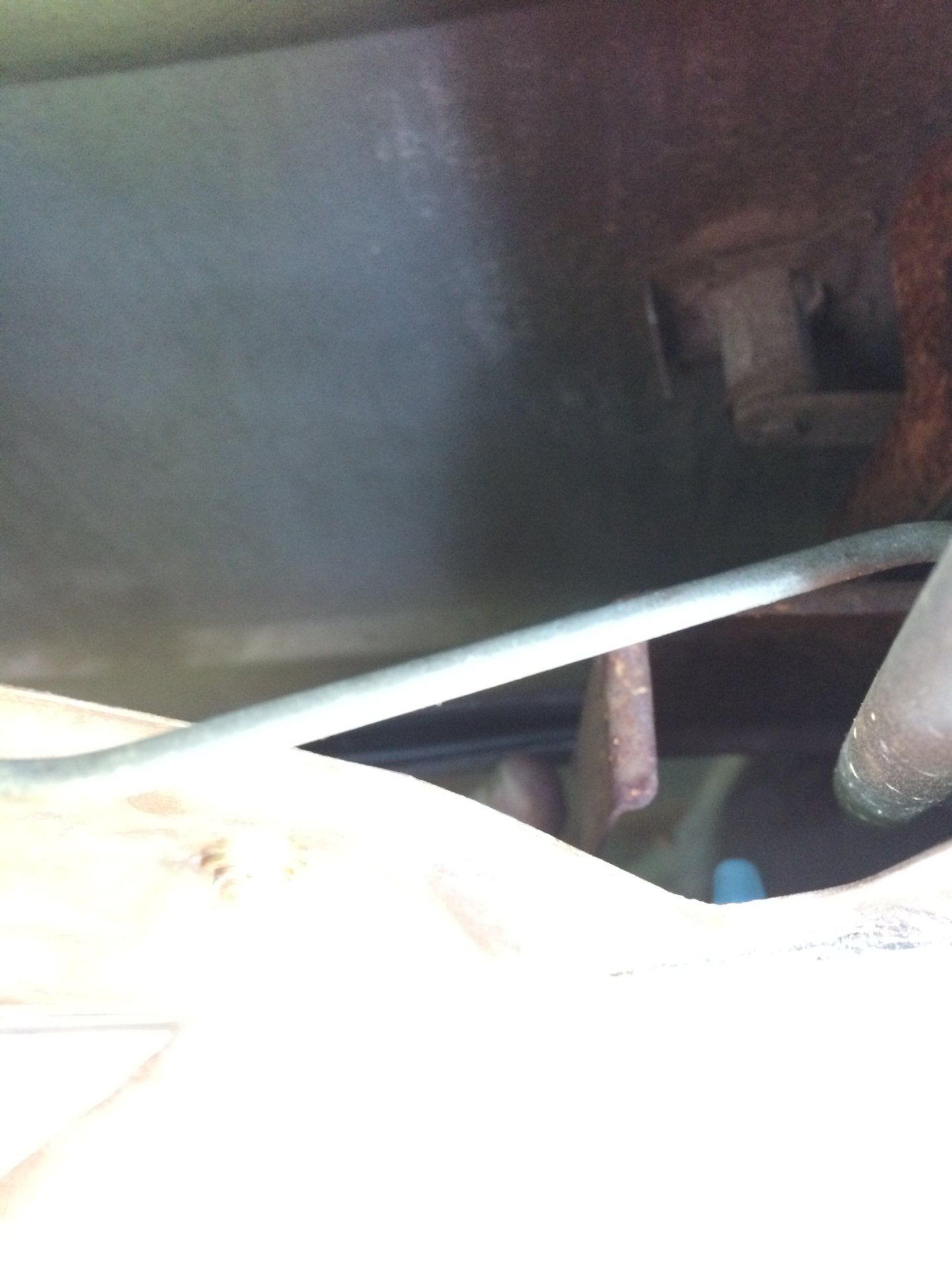

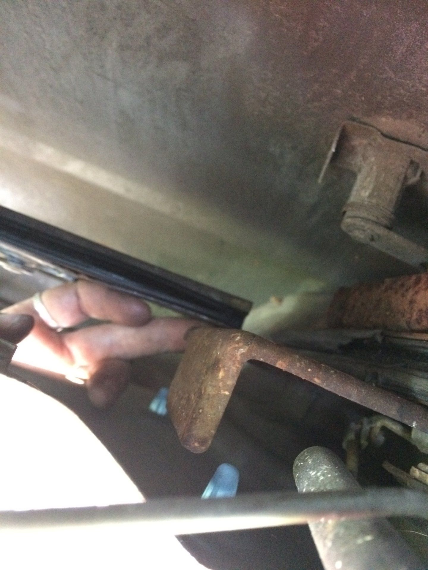

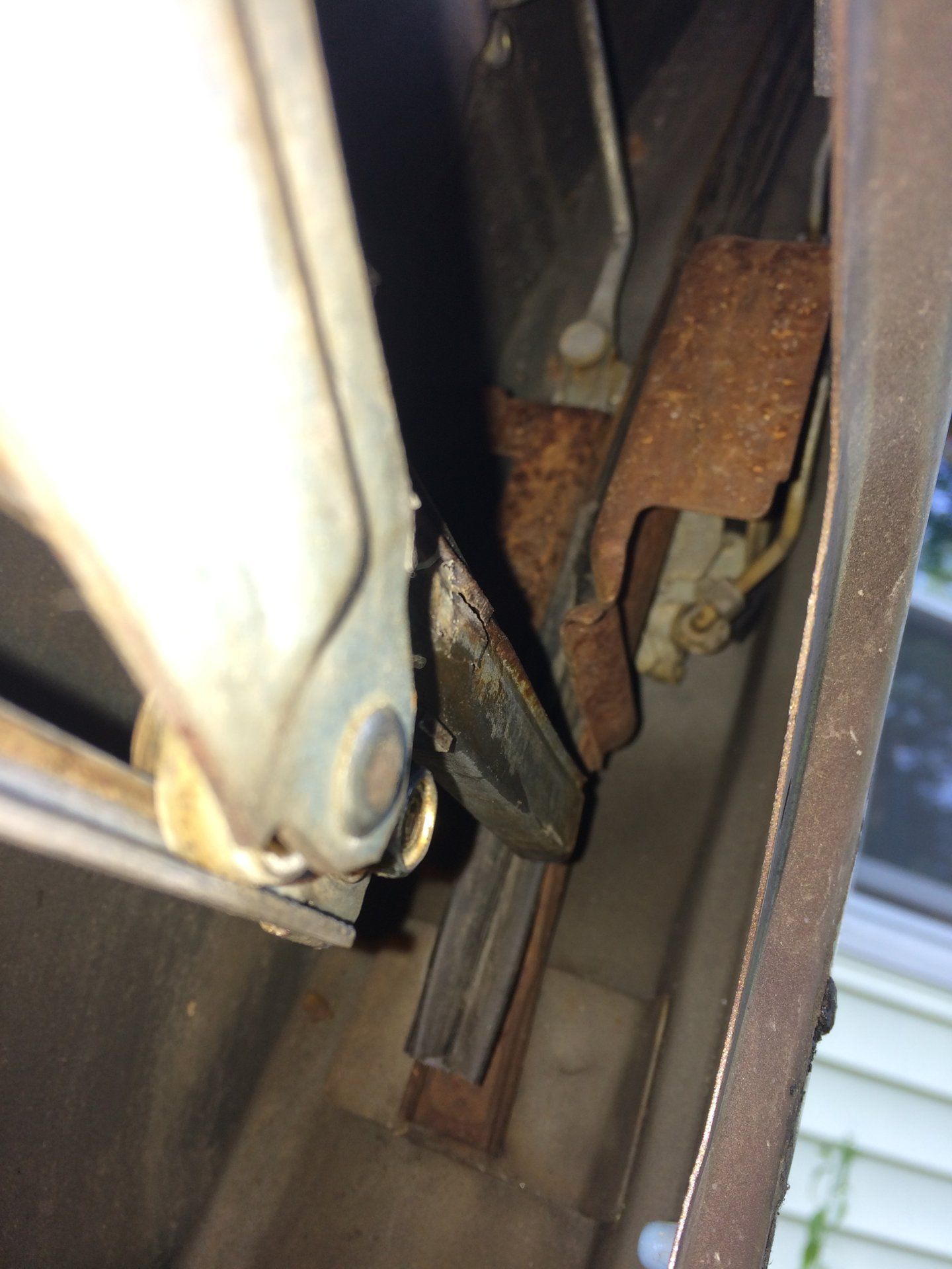

Still fighting w/ outer runner edge... getting caught on square metal bracket for door handle mechanism. Runner glides down but going back up catches the lower lip and stops.
I’ve taken the regulator out a few times and tried reinstalling in the up position and bottom and nothing doing.
I see what your directing me to but that’s not what’s holding it up.

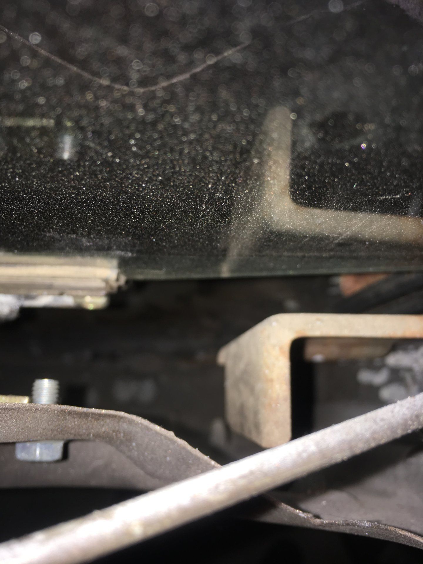

The metal runner is catching under this bracket... and in the picture you can see the rubber is lined up edge to edge. It will roll down against that bracket but as it comes back up it gets stuck under it.
I’ll try again w/ runner pressed up into glass from top. Maybe that stretch of the runner shouldn’t be that far to the right and that’s why it’s getting hung up underneath.

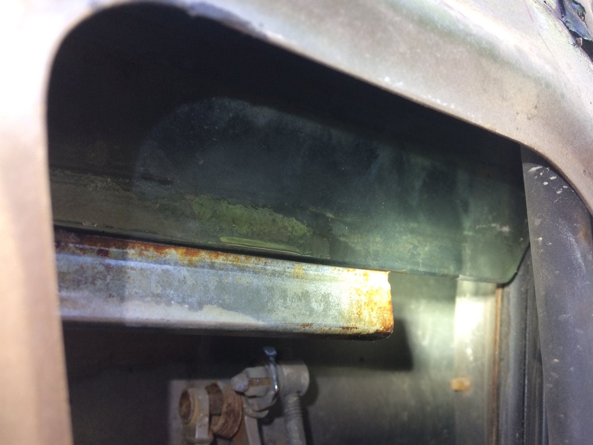

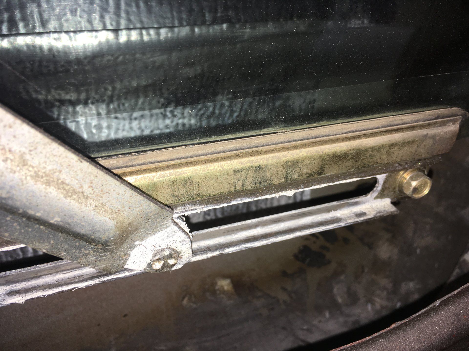

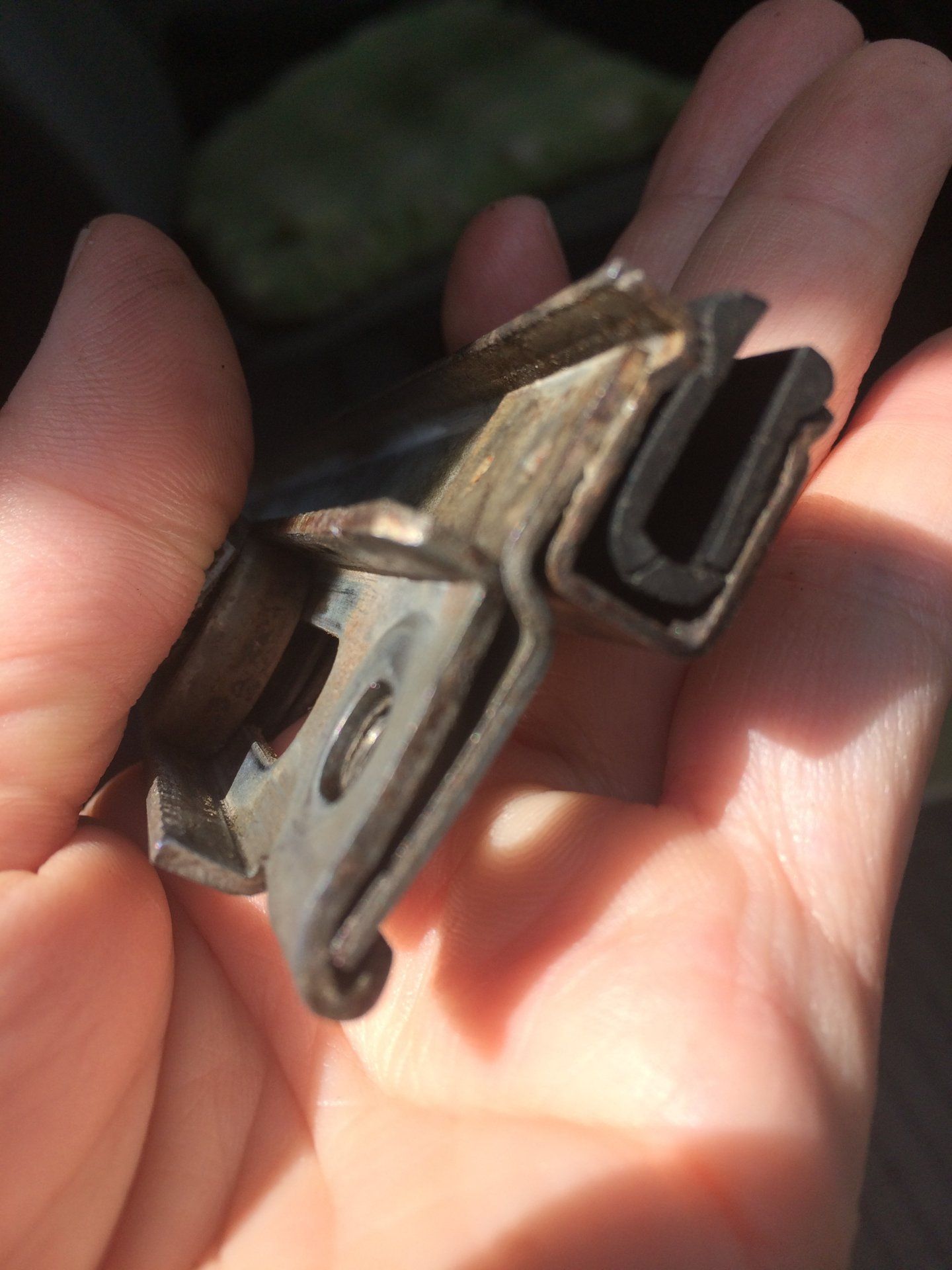

Here ya go, hope this helps. In the second pic window is full lower position.should show where track should sit on window..
View attachment 1725050 View attachment 1725051

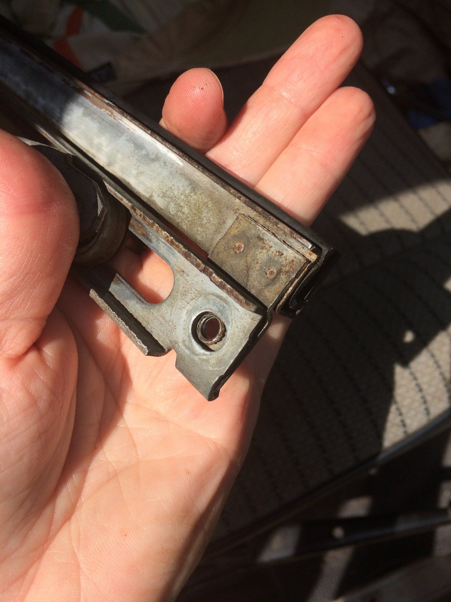

So I see the metal runner that the rubber sits in and the metal riser are both at the same length. I physically can not make mine be positioned like that at all. The farthest out edge sticks out about 2-3” further and looking closely that’s the only way they line up. Screw holes, the threads, the ridge the runner sits on in the riser. I’m at utter perplexity.
If I try to line it up like yours you’ll see in the bottom two pix show the metal ridges won’t mate together flush.
