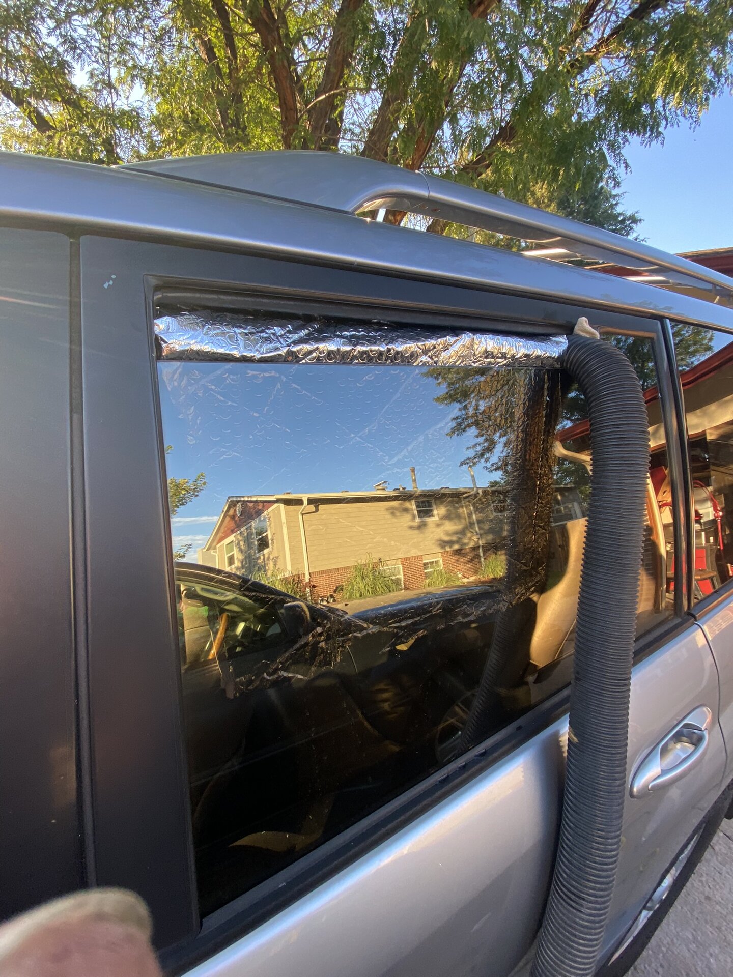

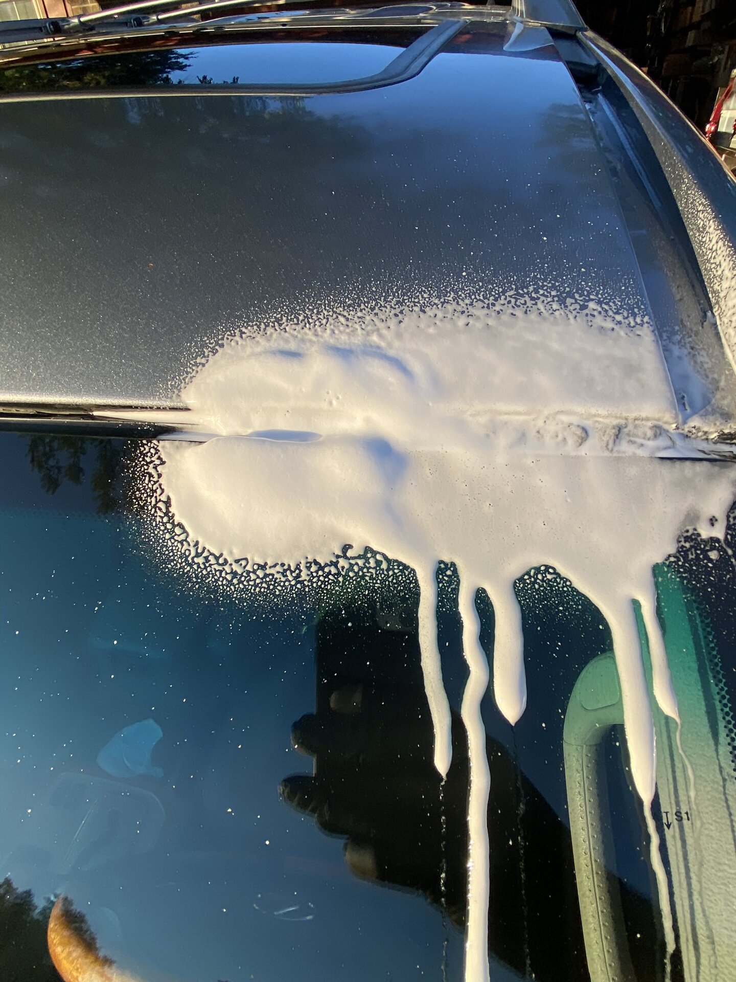

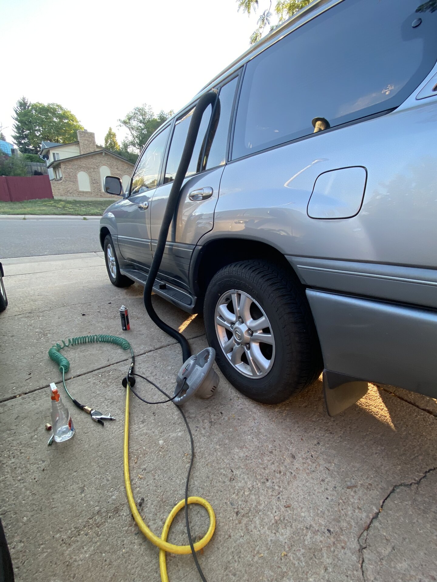

Finding the leak:
I've used a can of windshield cleaner. Spray around perimeter of windshield. Then use, compressed air to blow from inside around perimeter. While watching for air bubbles. This can be done around doors seal also. A good foamy bubbling car soap can also be used.
I've also used a leaf blower in rear side window. Run inner cabin fan on high, with vent set to fresh outside air. To further increase cabin air pressure, block rear 1/4 side vents with tape.

Finding the leak:
I've also a leaf blower in rear side window. Run inner cabin fan on high, with vent set to fresh outside air. To further increase cabin air pressure, block rear 1/4 side vents with tape.

amazing as always. thank you!! I will definitely try this.
