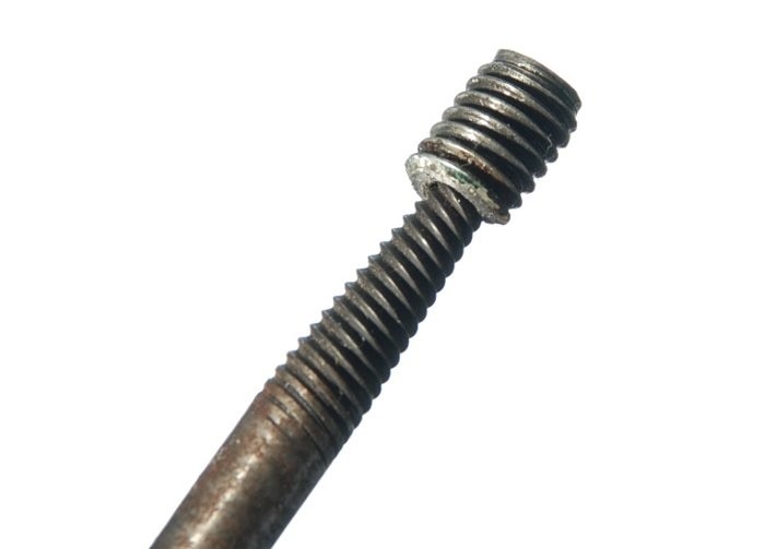

First picture is of the disassembled brake mechanism. I wasn't sure what year this winch was off of but I found a clue that leads me to believe it was early - 67. What is that clue you ask? Well, right here on the brake pad are two screws. Well, I removed them (they are about halfway out in this picture) and found the thread pitch to be M5 .9 pitch. Very rare and only on early cruisers. Well, lucky I documented how to make these screws in another thread. Here you go ...https://forum.ih8mud.com/threads/how-to-make-rare-m5-9-pitch-screws-found-on-early-67-pics-included.902751/
