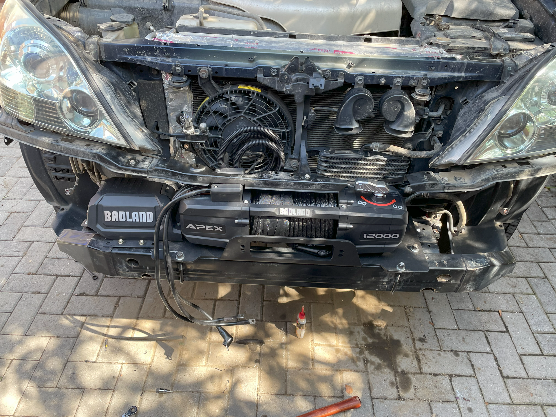

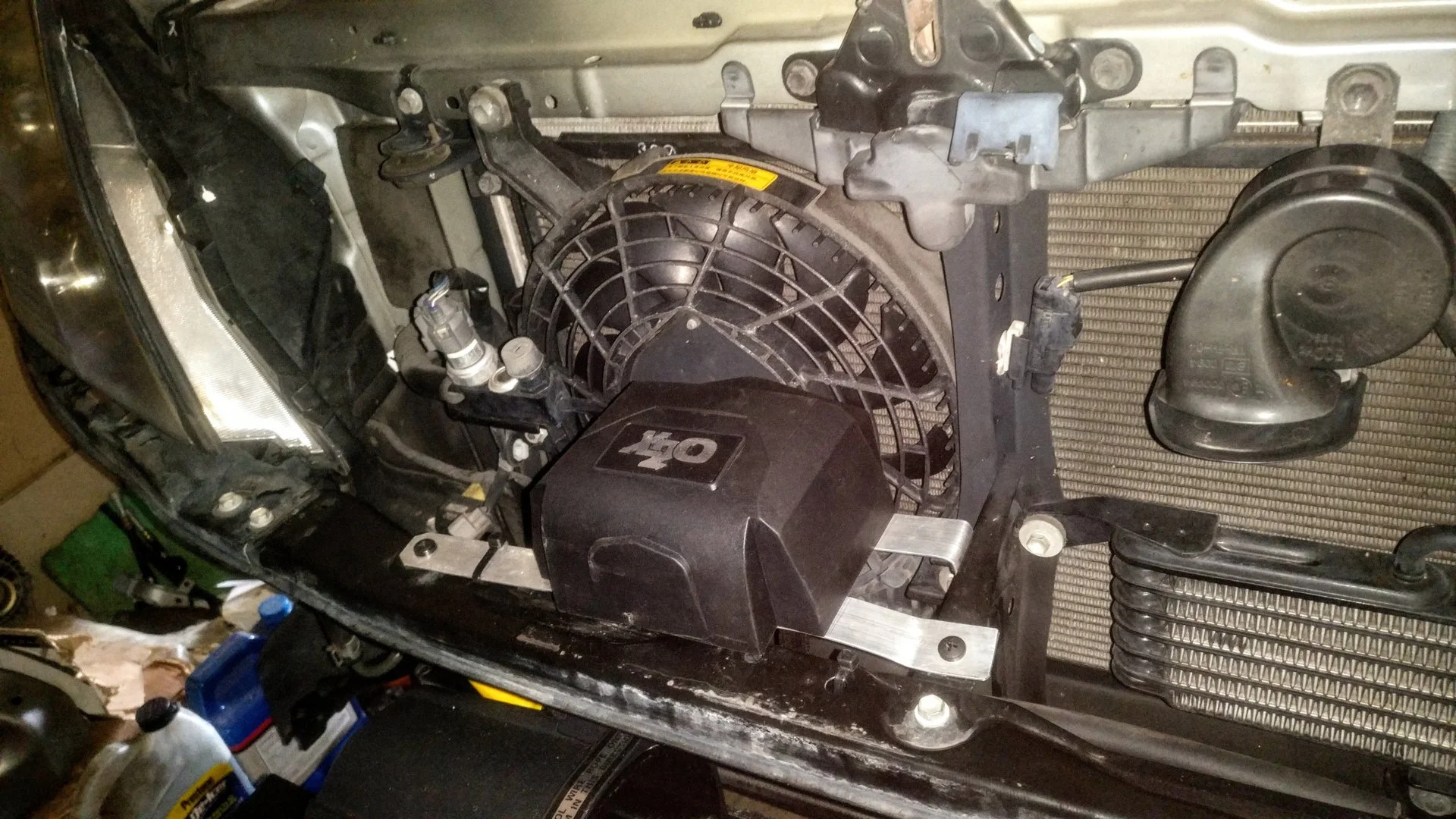

I made a bracket out of some random metal in my garage to mount mine behind my bumper. I know people also mount them near the power steering reservoir as well, especially with an aftermarket bumper

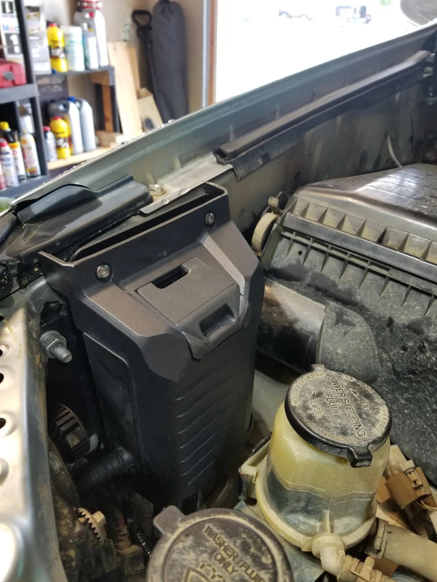

Used the empty space next to the air box and ps reservoir. The Badlands Apex control box is huge, so I had to trim the excess off the sides. Secured with 2 bolts going through the fender sheet metal and the supplied relocation bracket. Easily accessible should the remote batteries die, and it's protected enough where it doesn't get too wet too often.

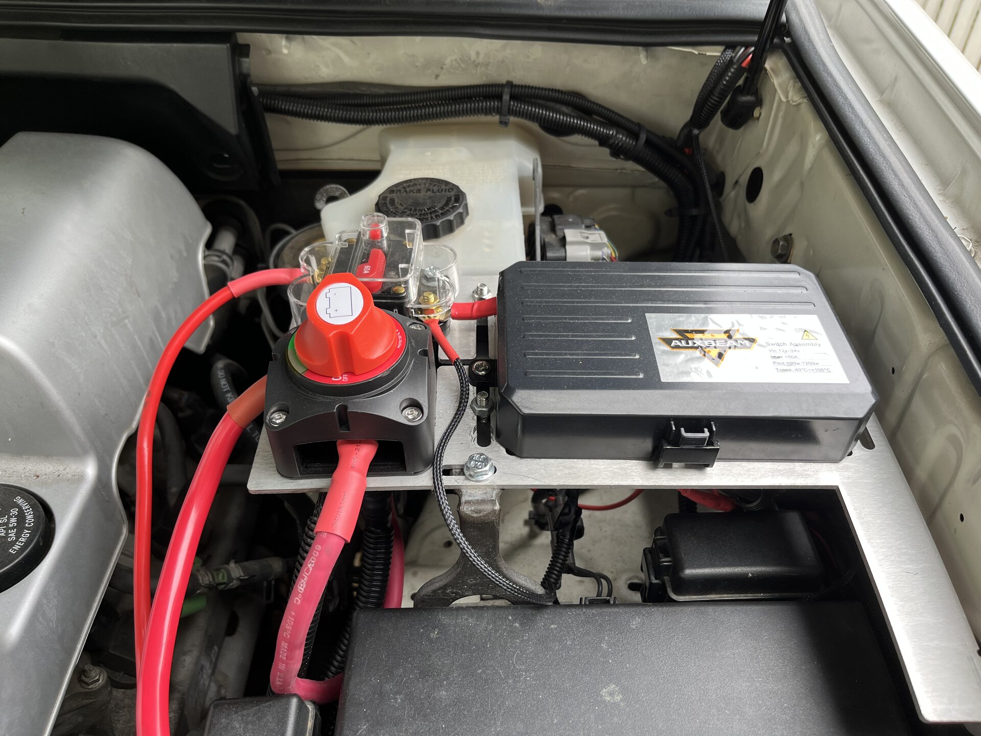

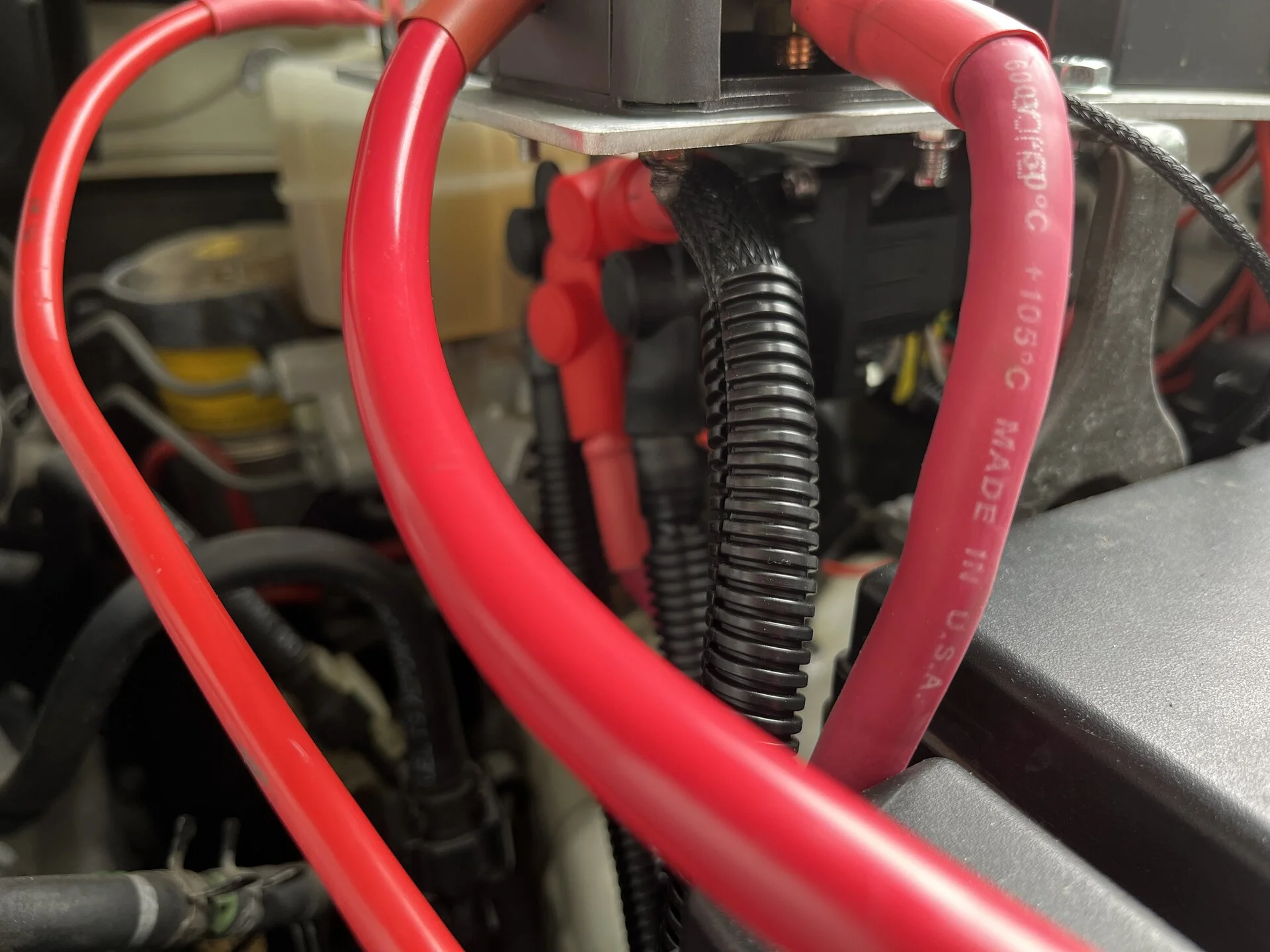

I didn’t want to run power for a winch from the battery to a control box on the passenger side. I disassembled my apex badlands control box, and mounted the required pieces on the same panel that holds my switch / fuse box.

I did not include the wired controller plug. I have a number of ways to charge the wireless controller, and didn’t want to wire both the plug and the switch to toggle wired / wireless.
Totally get that others might not want to rely on this setup, but I’m doubtful I’ll run into a situation where I can’t charge that controller on the go if needed.
Dang, I put mine in the same spot but did not attempt to keep it in the factory box. I spent a silly amount of time remounting all of mine inside an ammo box in the same spot.
What winch plate is that? Generic/universal that is adapted to the factory crash bar/frames? I like that setup and it seems lighter/cheaper than either a bumper or hidden winch mount that replaces the crash bar.
Budbuilt hidden winch but its for the 4th gen 4runner and keeps the factory crash bars. Its the cheapest one on the market at least when I bought and it works perfectly. Only caveat is you need to come up with 2" fairlead spacers as the front bumper is farther forward than the 4runner. I just welded a bunch of the scrap metal junk in my garage together an then drilled a hole though it. Its been working perfectly for 3 years now and I've put it though its paces in the east coast rocks
